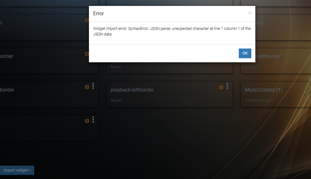

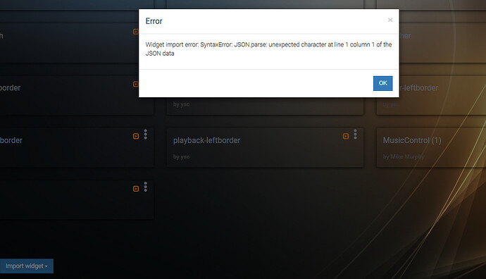

Hi, I am getting error when trying to import widgets.
Can you please tell what can be the problem?
So harmonyActivity is defined in my.items as
String HarmonyActivity "Activity"(gharmony) { channel="harmonyhub:hub:Master:currentActivity" }
In paper UI it’s default as harmonyhub_hub_Master_currentActivity, so you should just be able to use that if you hub is called Master.
So currentActivity shows you what your current activity is and if you send a command to it it will change the current activity.
If you are still figuring out what is what and what things are called, etc. Pop over the rest api interface, get all items, and then search for harmony and see what your activities, remotes are called, etc.
@unparagoned - Thanks. That was it. I had the item HarmonyActivity but my hub is LivingRoom not Master and I didnt even think to check that Now I have everything working well minus a few glitches/user setup errors.

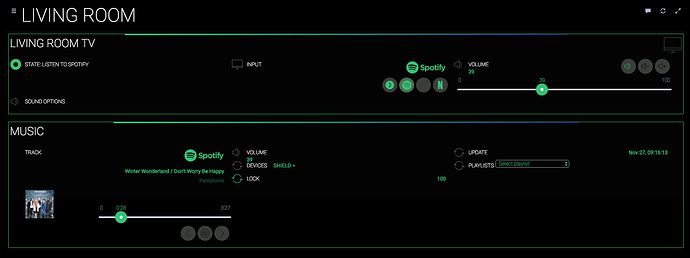

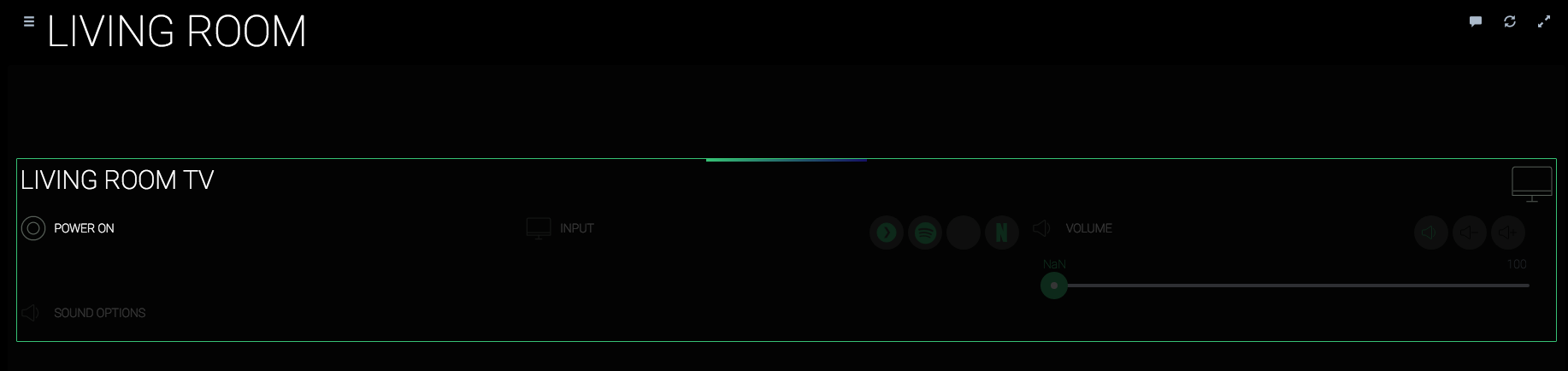

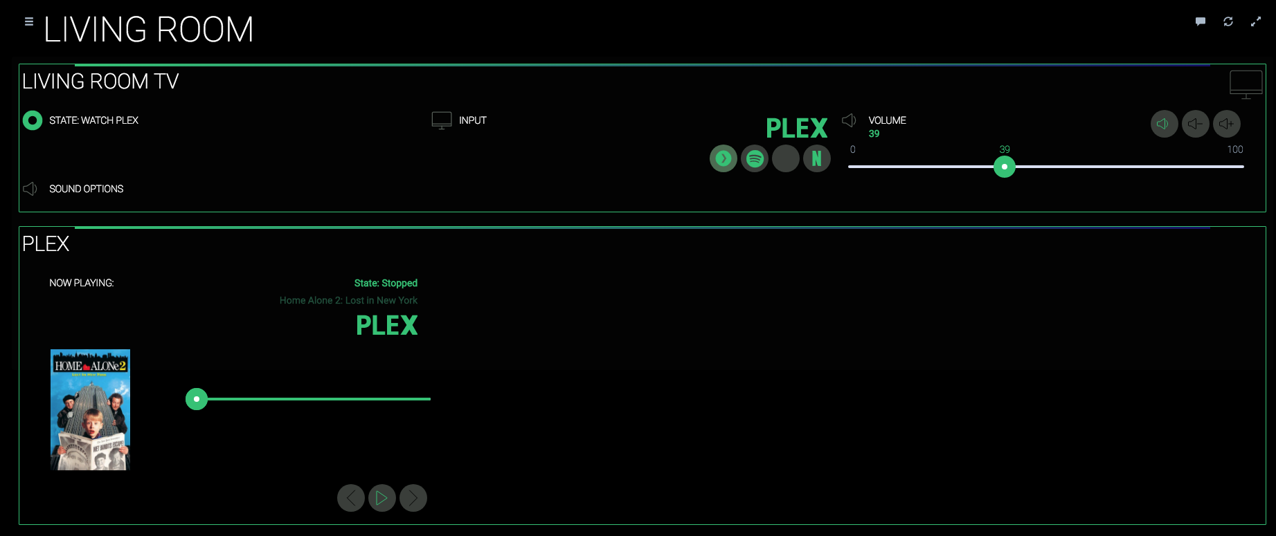

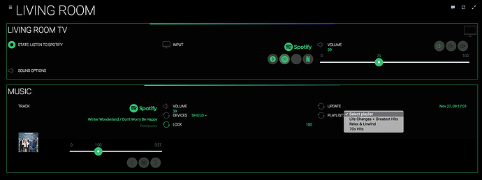

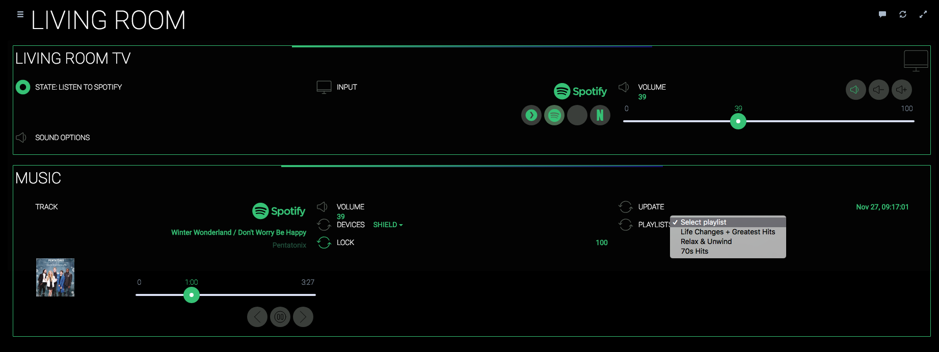

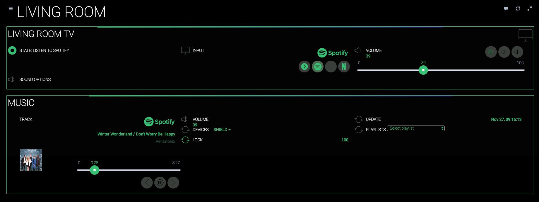

Made some progress, learned how to scale SVG images properly and plenty of other stuff. Here are some Screen shots of what I have so far. Dynamic screen based on activity and have some future plans for deeper plex integration but that project will take some time if I can pull it off at all. One thing I can’t figure out is why it only shows 3 of my playlists and not all of them. I only have about 14 total. Some are mine some are followed. Of the 3 showing only 1 is mine.
the images are not working for me (I know that those which are bought are not included) but it is only the Spotify which is visible. If I copy the link to that one to another place, it doesn’t show up
anybody with an idea?
