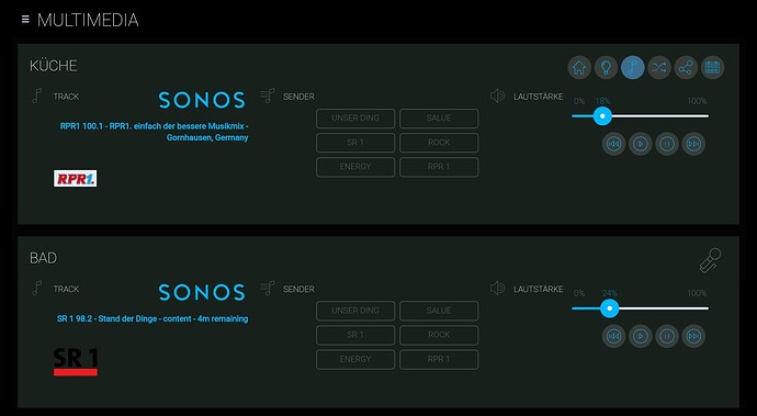

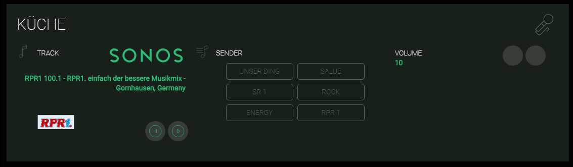

i am playing with this great theme, and so, i changed the music widget for my own needs. I am using two sonos player in my house. My problem is, that they are using a dimmer item controlling volume. Can someone help me what i have to change here:
<div class="widget">
		<div class="icon off"><svg viewBox="0 0 48 48"><use xlink:href="/static/matrix-theme/squidink.svg#volume"></use></svg></div>
		<div class="name">Volume<div class="value">{{itemValue('dim_sonos_bad_volume')}}</div></div>
		<div class="controlGroup">
    <div class="control" ng-click="sendCmd('spotify_action', 'volume_up')"><svg viewBox="0 0 80 80"><use xlink:href="/static/matrix-theme/squidink.svg#top-arrow-2"></use></svg></div>
			<div class="control" ng-click="sendCmd('spotify_action', 'volume_down')"><svg viewBox="0 0 80 80"><use xlink:href="/static/matrix-theme/squidink.svg#down-arrow-2"></use></svg></div>
		</div>
	</div>
Volume up/down are useless commands for a dimmer. Can someone please explain me how to integrate a slider for my needs?

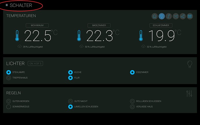

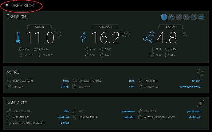

One more thing: Is it possible to hide header (Description and burger item)??
Volume Slider problem solved for me. For sure its not the most beautiful code, but it works :wink:
				<div ng-init="slider_kitchen = {
            'item': 'dim_sonos_kitchen_volume',
            'vertical': false,
            'floor': 0,
            'ceil': 100,
            'step': 2,
            'precision': 1,
            'unit': '%',
            'hidelabel': true,
            'hidelimits': false,
            'hidepointer': false,
            'showticks': false,
            'bigslider': false
         <widget-slider ng-model="slider_kitchen"/>
but the “hiding header problem” still exists. Any solution?

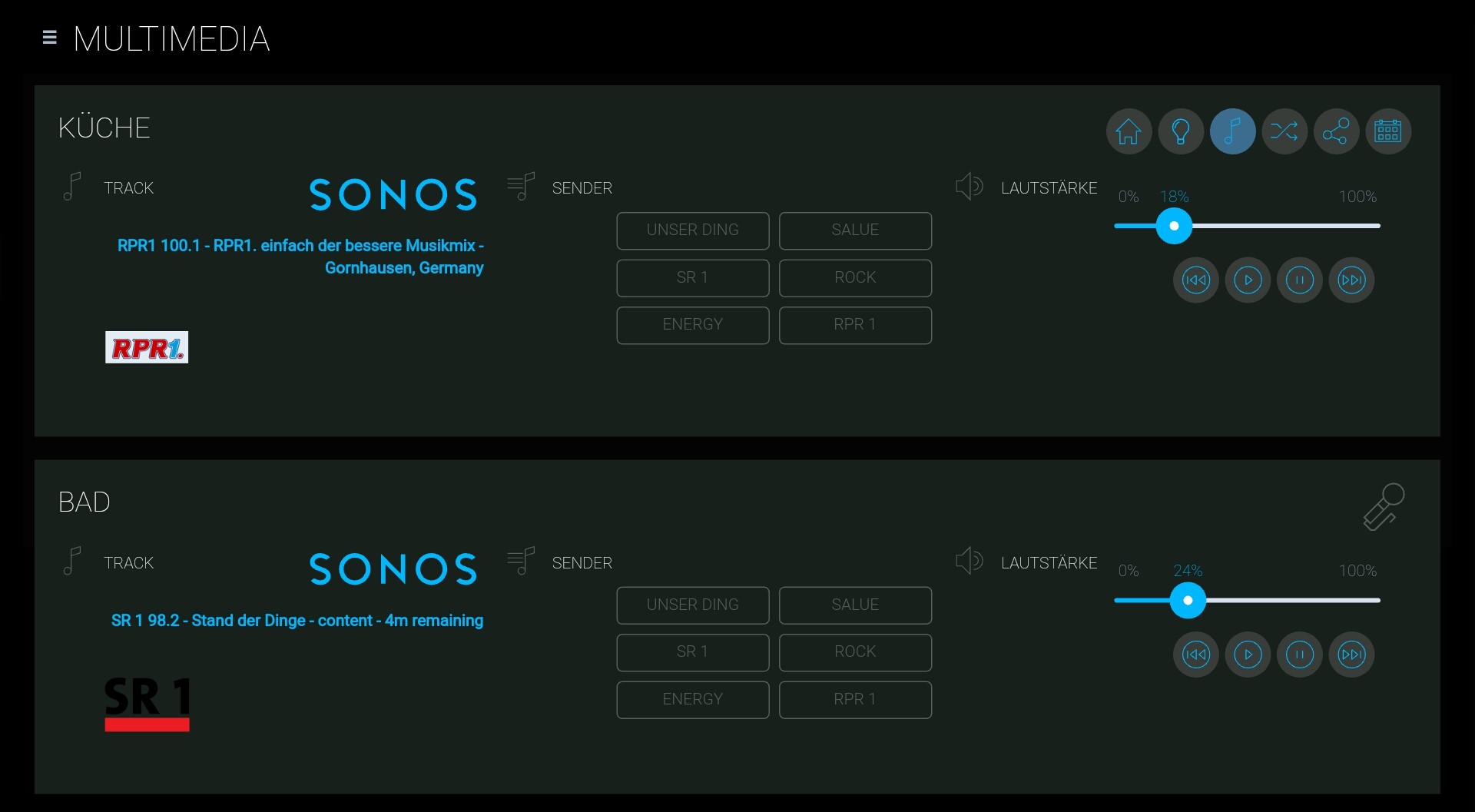

Sure, but all credits @pmpkk i only changed his multimedia widget. Hope its ok for you?
<div class="section">
<div class="sectionIconContainer"><div class="sectionIcon"><svg viewBox="0 0 48 48"><use xlink:href="/static/matrix-theme/icons/music.svg#music"></use></svg></div></div>
<div class="title">Bad</div>
<div class="controls">
		<div class="icon off"><svg viewBox="0 0 48 48"><use xlink:href="/static/matrix-theme/icons/note.svg#note"></use></svg></div>
		<div class="name">Track</div>
		<div class="appLogo"><svg viewBox="0 0 1000 400"><use xlink:href="/static/matrix-theme/squidink.svg#sonos"></use></svg></div>
		<div class="valueGroup">
			<div class="value">{{itemValue('str_sonos_bad_currenttrack')}}</div>
			<div class="value">{{itemValue('str_sonos_bad_currentartist')}}</div>
		</div>
		<div class="music">
			<div class="cover" ng-style="{'background-image': 'url(' + itemValue('str_sonos_bad_currentalbumarturl') + ')'}"></div>
			<div class="playback">
			</div>
		</div>
	</div>
		<div class="icon off"><svg viewBox="0 0 48 48"><use xlink:href="/static/matrix-theme/icons/playlist.svg#playlist"></use></svg></div>
		<div class="name">Sender</div>
		<div class="sceneGroup">
			<div class="scene" ng-click="sendCmd('str_sonos_bad_radio', 'Radio SalĂŒ')">Salue</div>
			<div class="scene" ng-click="sendCmd('str_sonos_bad_radio', 'UNSERDING')">Unser Ding</div>
    <div class="scene" ng-click="sendCmd('str_sonos_bad_radio', 'Classic Rock Radio')">Rock</div>
			<div class="scene" ng-click="sendCmd('str_sonos_bad_radio', 'SR 1')">SR 1</div>
    <div class="scene" ng-click="sendCmd('str_sonos_bad_radio', 'RPR 1')">RPR 1</div>
			<div class="scene" ng-click="sendCmd('str_sonos_bad_radio', 'ENERGY Digital')">Energy</div>
		</div>
	</div>
		<div class="icon off"><svg viewBox="0 0 48 48"><use xlink:href="/static/matrix-theme/icons/volume.svg#volume"></use></svg></div>
  <div class="name">LautstÀrke<div</div></div>
    <div ng-init="slider_bad = {
        'item': 'dim_sonos_bad_volume',
        'vertical': false,
        'floor': 0,
        'ceil': 100,
        'step': 2,
        'precision': 1,
        'unit': '%',
        'hidelabel': true,
        'showticks': false,
        'bigslider': false
     <widget-slider ng-model="slider_bad"/>
    </div>
      <div class="control" ng-click="sendCmd('pl_sonos_bad_control', 'NEXT')" ><svg viewBox="0 0 66 55"><use xlink:href="/static/matrix-theme/icons/next.svg#next"></use></svg></div>
				<div class="control" ng-click="sendCmd('pl_sonos_bad_control', 'PAUSE')"><svg viewBox="0 0 66 55"><use xlink:href="/static/matrix-theme/icons/pause.svg#pause"></use></svg></div>
      <div class="control" ng-click="sendCmd('pl_sonos_bad_control', 'PLAY')"><svg viewBox="0 0 66 55"><use xlink:href="/static/matrix-theme/icons/play.svg#play"></use></svg></div>
      <div class="control" ng-click="sendCmd('pl_sonos_bad_control', 'PREVIOUS')"><svg viewBox="0 0 66 55"><use xlink:href="/static/matrix-theme/icons/prev.svg#prev"></use></svg></div>
     </div>
		</div>
	</div>

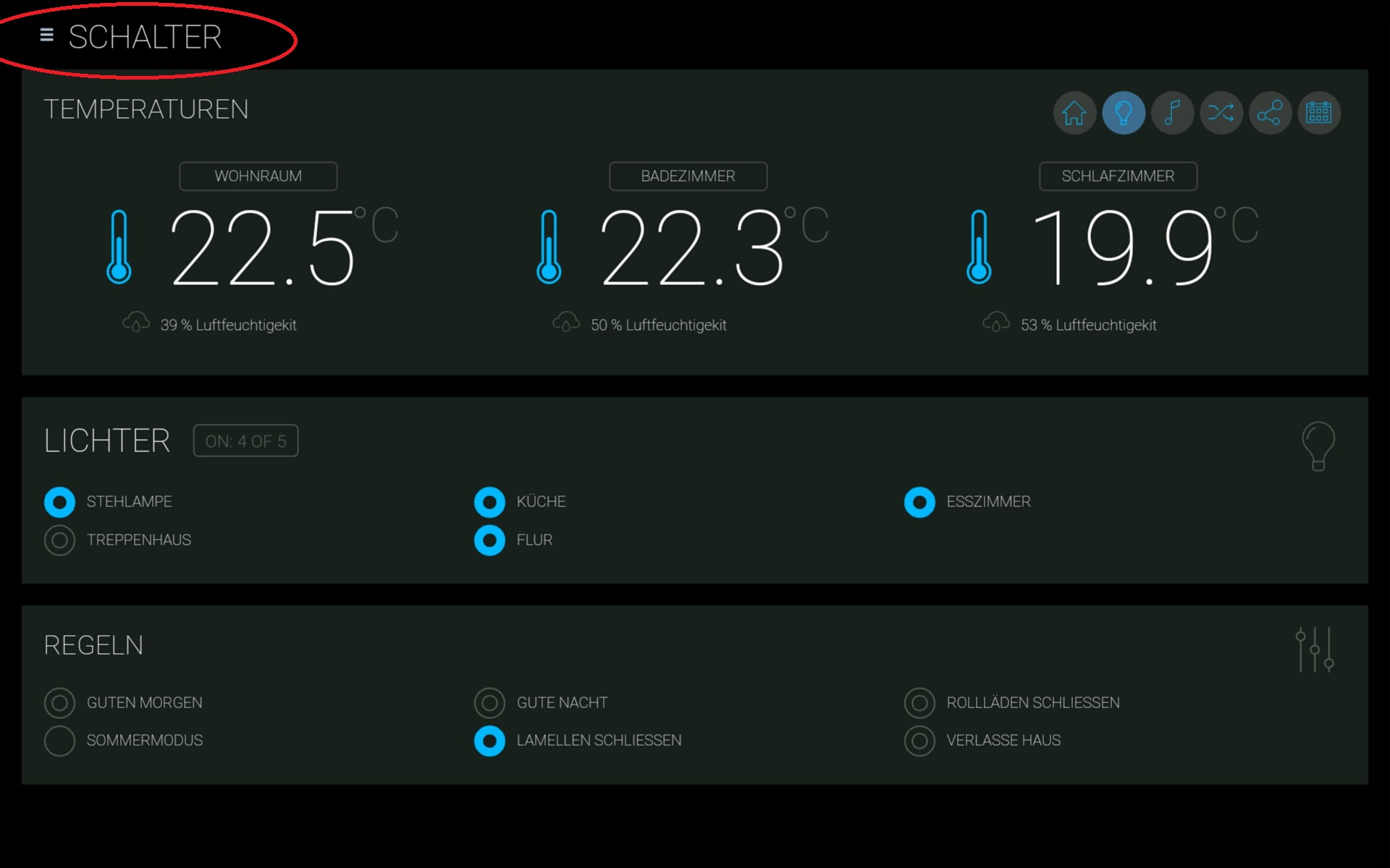

Really no one able to hide the header?
P.S. for a working favourite channel list, you also have to put the channels you want in your sonos app to favorites.
Hi Bogieman,
you just have to put a ?kiosk=on behind the URL an the Description and also the menu on the left will disappear.
To get them back, for editing etc. just change it to ?kiosk=off
You can give it to the variable you use to switch the dashboards.
ng-click=“sendCmd(‘DashSwitch’, ‘Schalter?kiosk=on’)”
Great! Thx for that

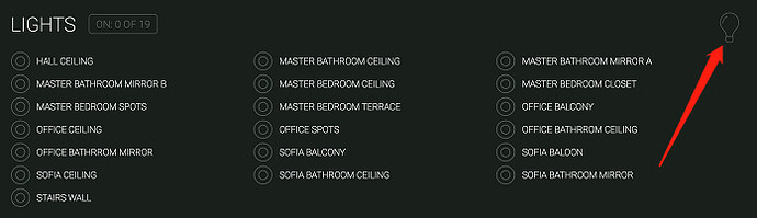

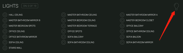

Please someone help a noob guy, I would like to have the light section icon go to “lights up” when one of the lights being turned on, when all lights off, the icon stay in grey, how to code this one?
      <svg viewBox="0 0 48 48"><use xlink:href="/static/matrix-theme/matrixicons.svg#light_bulb"></use></svg>
    </div>
  </div>
Please help, thank you so much
Shane

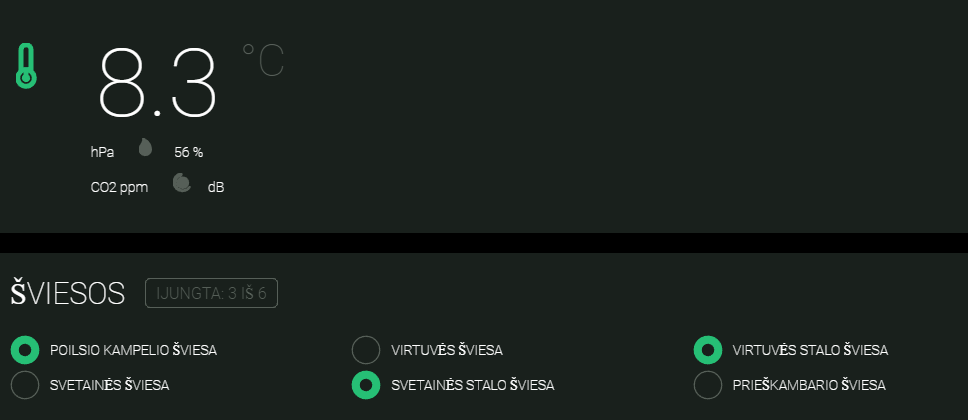

How did you inserted the icons?
Via squidink.svg like pmpkk said?
Are there “stroke-width” informations in the svgs you inserted?
You should “play” with them. Try stroke-width="1" or perhaps stroke-width="0".
Which icons do you use?
Hi Boogieman,
squidlink.svg:
And for buttons something that’s wrong
Delete stroke="#000000" complete and see what happens.
The buttons problem should be solved if you click them for the first time.
My buttons, so big :confused: i don’t undarstand.
I delleted, but nothing.
