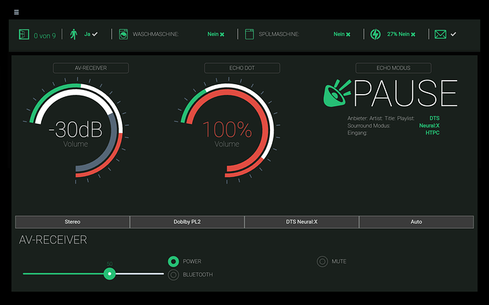

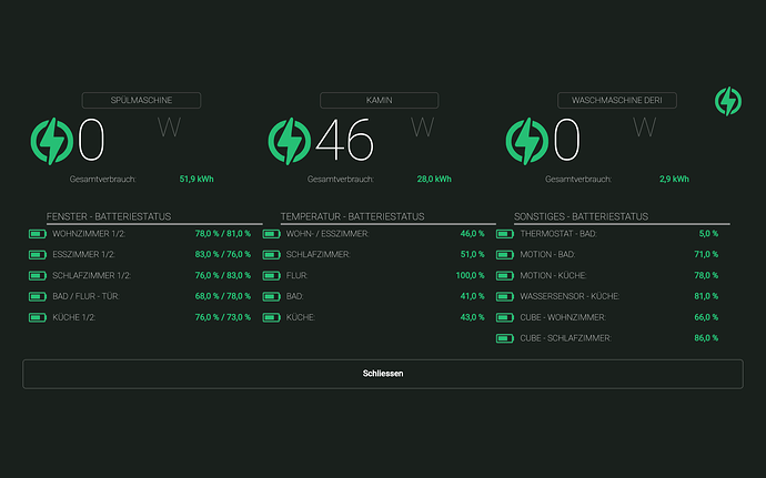

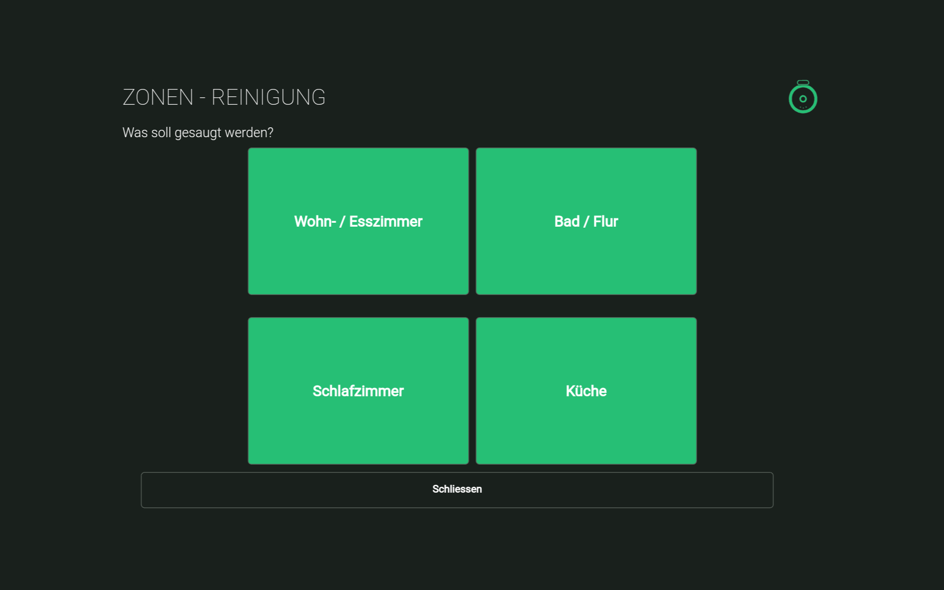

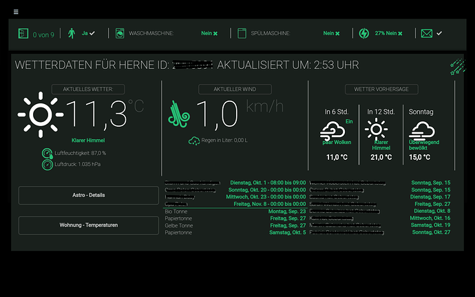

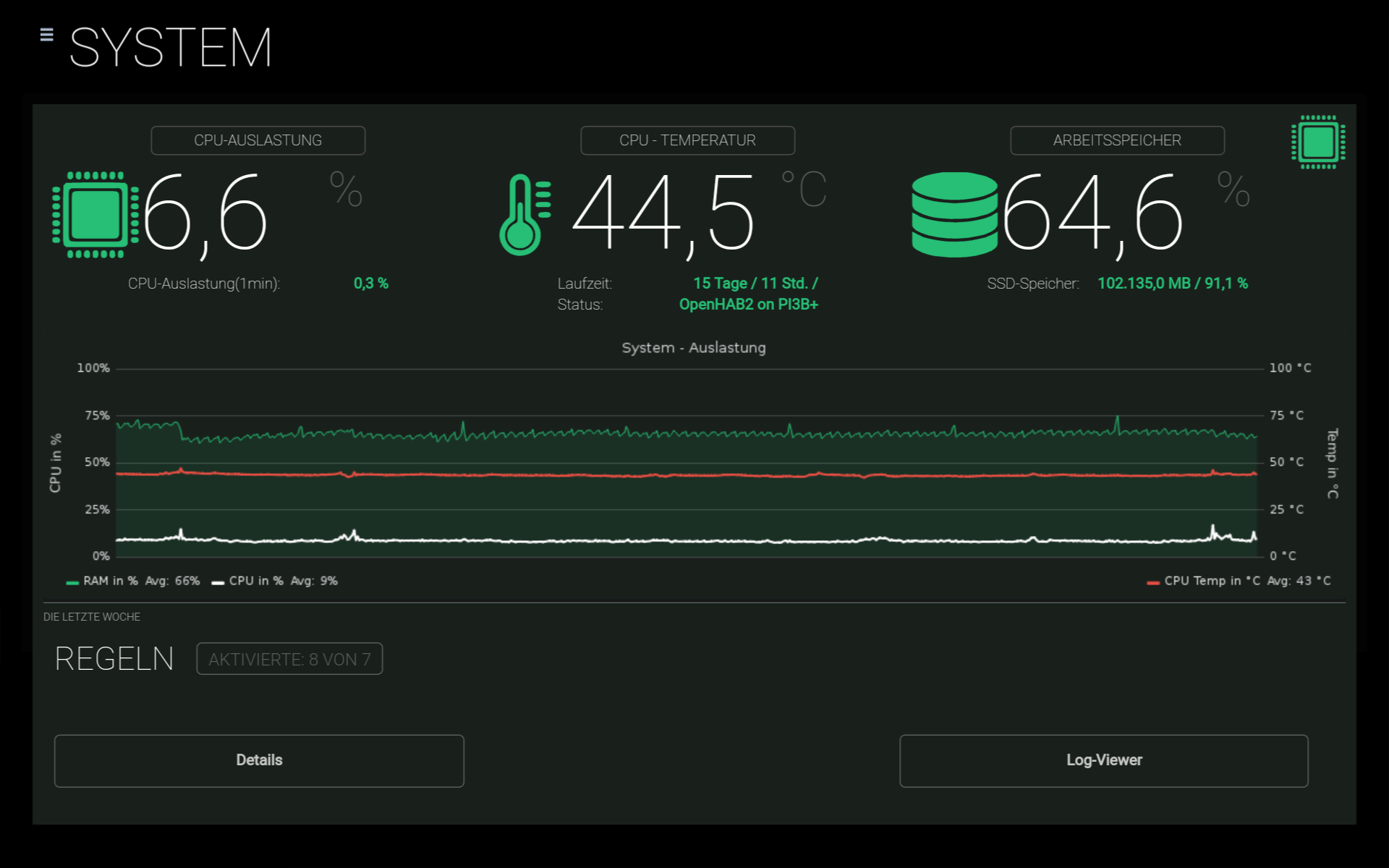

Hello everybody,

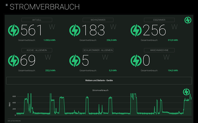

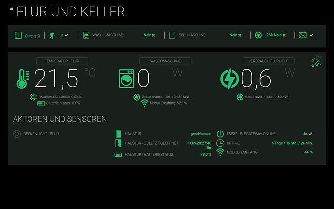

Here are a few updates from my dashboard. Thanks again to Patrick for the perfect template

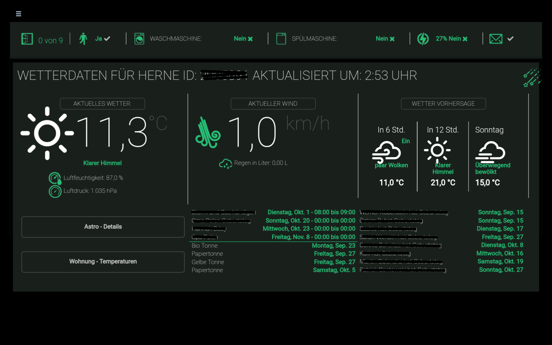

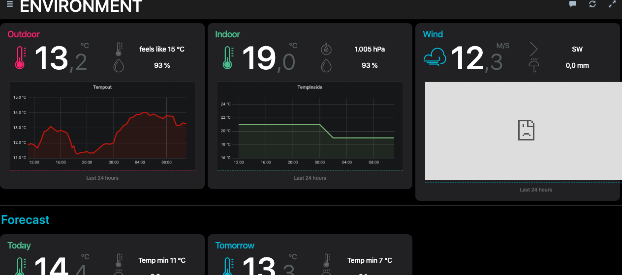

Weather, Calendar, Astro, Home-Temp
Multimedia

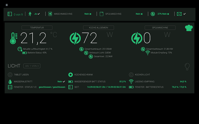

Living Room
Kitchen

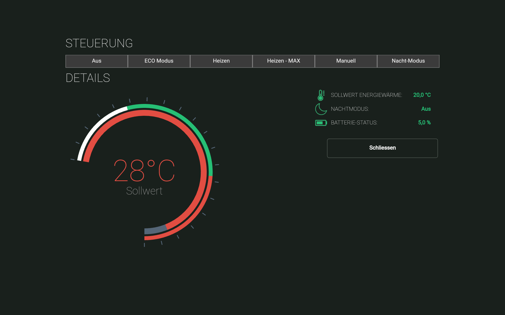

Bedroom and bathroom with Popups for Air Cleaner and Heater
Hall and cellar

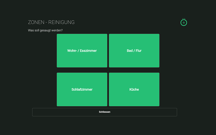

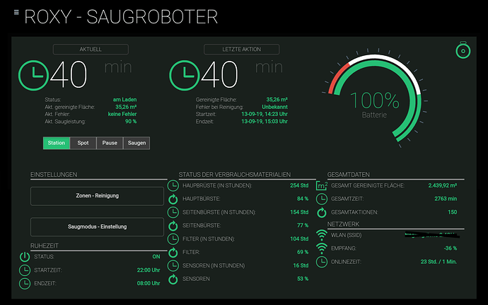

Vaccum Cleaner with Popup for Mode and Fan-Options
Flowers with Graph-Gallery
System-Info

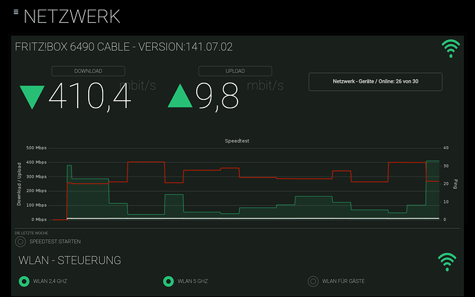

Network-Info with Popup for WLAN-Devices

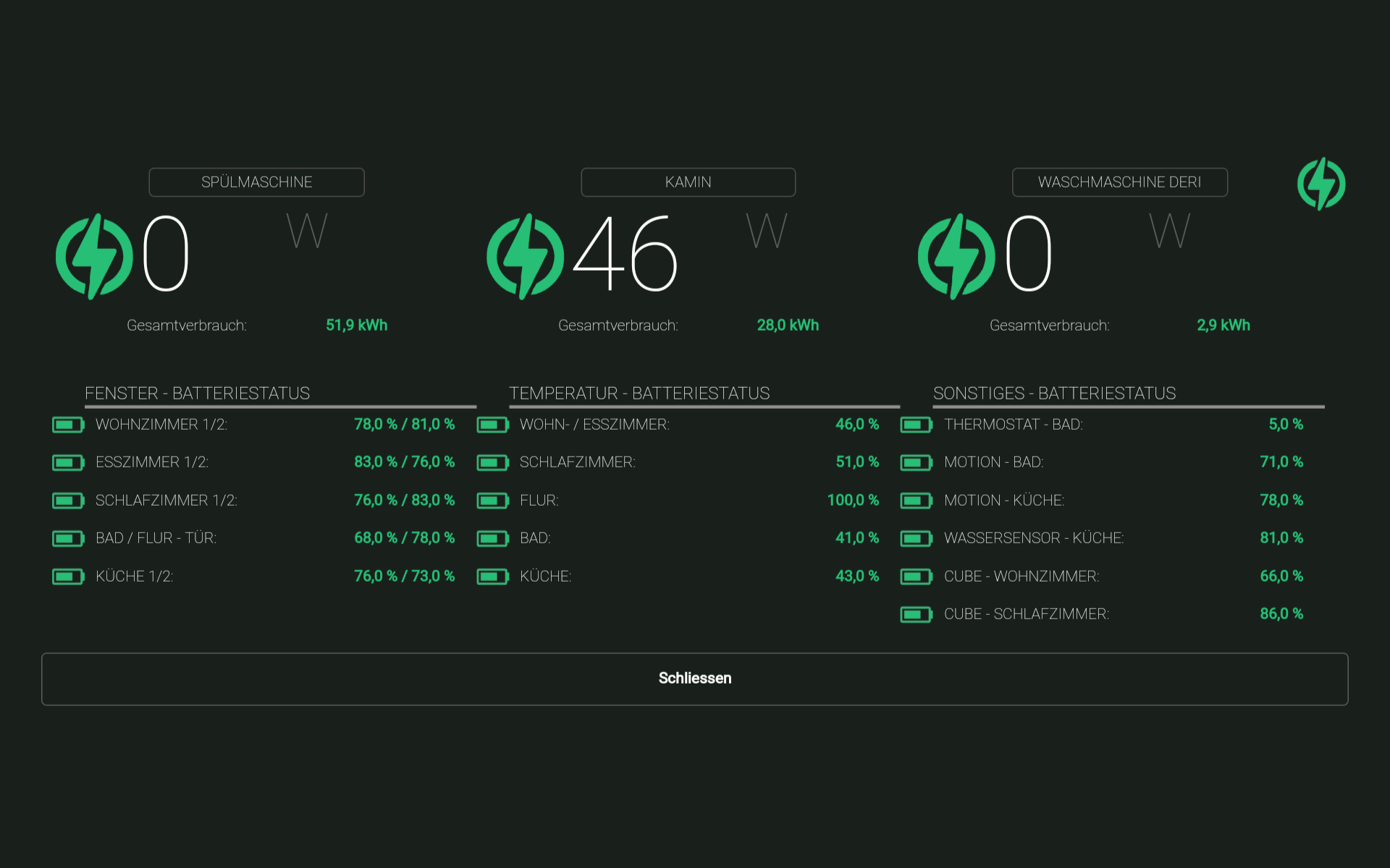

Energy-Info with Popup

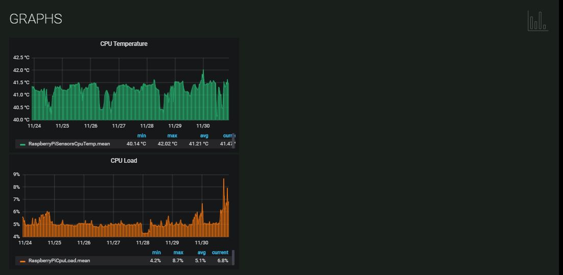

I am fighting to place two embed graphs next to each other centralized and can not make it.
I wish they could be responsive. In case of scale they will change position - go down.
Using original matrix-theme.css
Visualization:
Widget:
<div class="section">
	<div class="sectionIconContainer">
		<div class="sectionIcon"><svg viewBox="0 0 48 48"><use xlink:href="/static/matrix-theme/squidink.svg#graph"></use></svg></div>
	</div>
	<div class="title">Graphs</div>
		<div class="graph">
			<iframe src="http://192.168.1.114:3000/d-solo/Xr707_gRk/raspberry-pi?orgId=1&refresh=1m&from=1574542079156&to=1575146879156&panelId=2" width="500" height="250" frameborder="0"></iframe>
		</div>
    <div class="graph">
			<iframe src="http://192.168.1.114:3000/d-solo/Xr707_gRk/raspberry-pi?orgId=1&refresh=1m&from=1574542079156&to=1575146879156&panelId=3" width="500" height="250" frameborder="0"></iframe>
		</div>
</div>
I appreciate your support!
index.html of grafana you can find here (based on RP3 and openhabian):
sudo nano /usr/share/grafana/public/views/index.html
Unfortunately I am not able to get the effect. :frowning:
Anybody succeeded?
