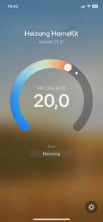

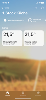

In the overview view, both are identical:

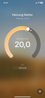

In the detailed view, the current temperature is missing for the object that comes via the matter bridge; instead, the target temperature is displayed again:

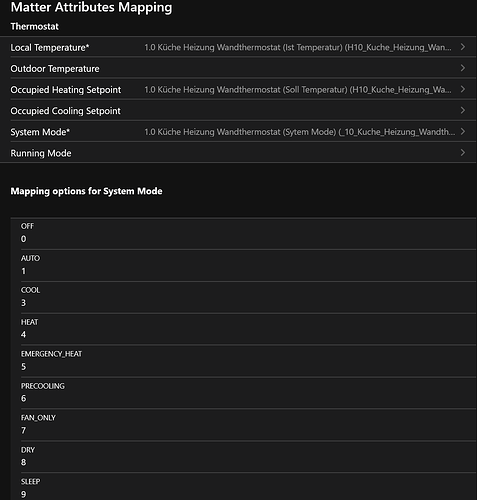

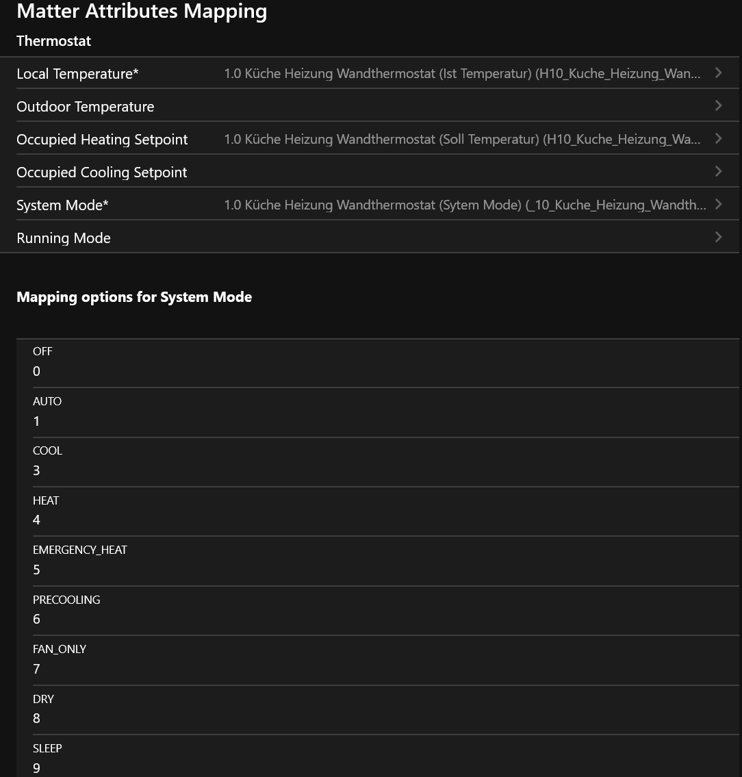

Sorry, I only posted the item with the problem; here’s the rest:
Number _10_Kuche_Heizung_Wandthermostat_Sytem_Mode “1.0 Küche Heizung Wandthermostat (Sytem Mode)” (H10_Kuche_Heizung_Wandthermostat) [Point] { homekit=“Thermostat.TargetHeatingCoolingMode” [HEAT=“4”, OFF=“0”], matter=“thermostat.systemMode” }
Number:Temperature H10_Kuche_Heizung_Wandthermostat_Set_Temperature “1.0 Küche Heizung Wandthermostat (Soll Temperatur) [%.2f %unit%]” (H10_Kuche_Heizung_Wandthermostat, openHAB_HomematicGroup01TermostatsSetTemperature) [Point] { channel=“homematic:HM-TC-IT-WM-W-EU:MEQ1606862:SEQ2820493:2#SET_TEMPERATURE”, homekit=“Thermostat.TargetTemperature”,
matter=“thermostat.occupiedHeatingSetpoint”, unit=“°C” }
The screenshot shows that these items work.
System Mode is a manually created item with a static value of 4, as the Homematic device does not have a heating/cooling mode for a pure heating function. For the same reason, no item for Cooling Target Temperature is defined either.
At first glance you are missing the matter system modes (you have them for homekit)
matter=“thermostat.systemMode”, [OFF=0, HEAT=4]
Also If you make changes and they don’t work, post your complete item config so i don’t have to try and construct from multiple posts, will save me a little time :+1:
I used the default matter values, which probably aren’t applied to the text configuration. For HomeKit I have to map 4→HEAT. The configuration is done via the interface; the text definitions are from the DSL export.
Group H10_Kuche_Heizung_Wandthermostat “1.0 Küche Heizung Wandthermostat” (Raum10Kueche) [Equipment] { homekit=“Thermostat”, matter=“Thermostat” }
Number:Temperature H10_Kuche_Heizung_Wandthermostat_Actual_Temperature “1.0 Küche Heizung Wandthermostat (Ist Temperatur) [%.1f %unit%]” (H10_Kuche_Heizung_Wandthermostat) [Point] { channel=“homematic:HM-TC-IT-WM-W-EU:MEQ1606862:SEQ2820493:2#ACTUAL_TEMPERATURE”, homekit=“Thermostat.CurrentTemperature”, matter=“thermostat.localTemperature”, unit=“°C” }

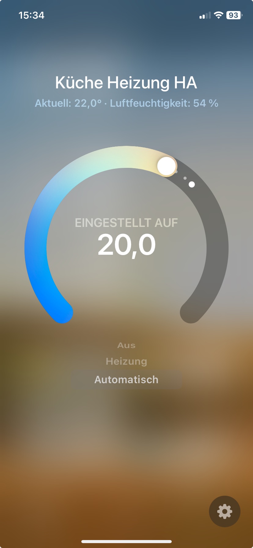

One more piece of information: To rule out that the problem lies with the Apple HomeKit app, I set up a test server with Home Assistant and Matter Bridge. Everything is displayed correctly there. However, I noticed that the humidity sensor is also missing from the openHAB Matter Bridge binding. It’s not configurable at all.
