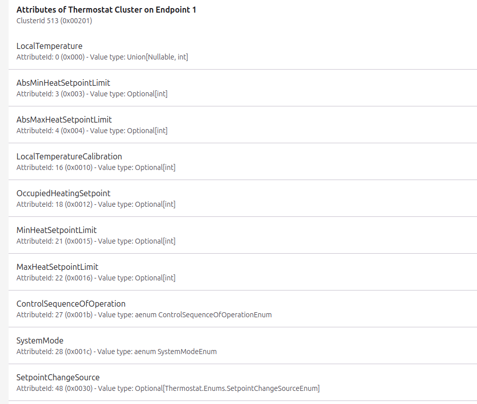

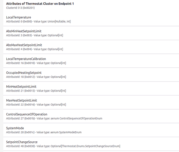

What I did not understand, that I could not see all attributes from this device.
If I examine the device with homeassistant/matter-server/Webinterface I can see this attributes

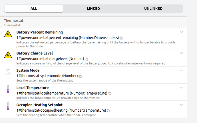

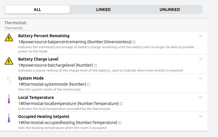

But in Openhab I can find only this channels
What I’m missing for example is the localTemperatureCalibration.
So is there a way to get the missing attributes to Openhab?

I’m only exposing the most common attributes as that cluster is quite large and complex. I was not really aware of localTemperatureCalibration or that any devices yet were using it. Its probably easy enough to add however, so i’ll put that on the list and see about maybe back porting for a patch release.
