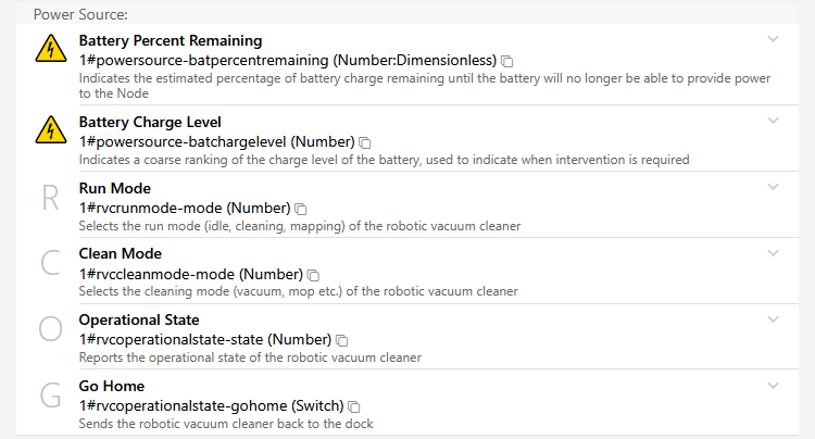

Good work, I got more channels und less exceptions.
openhab.log (882.4 KB)
One more small finding in the log after adding items for all channels:

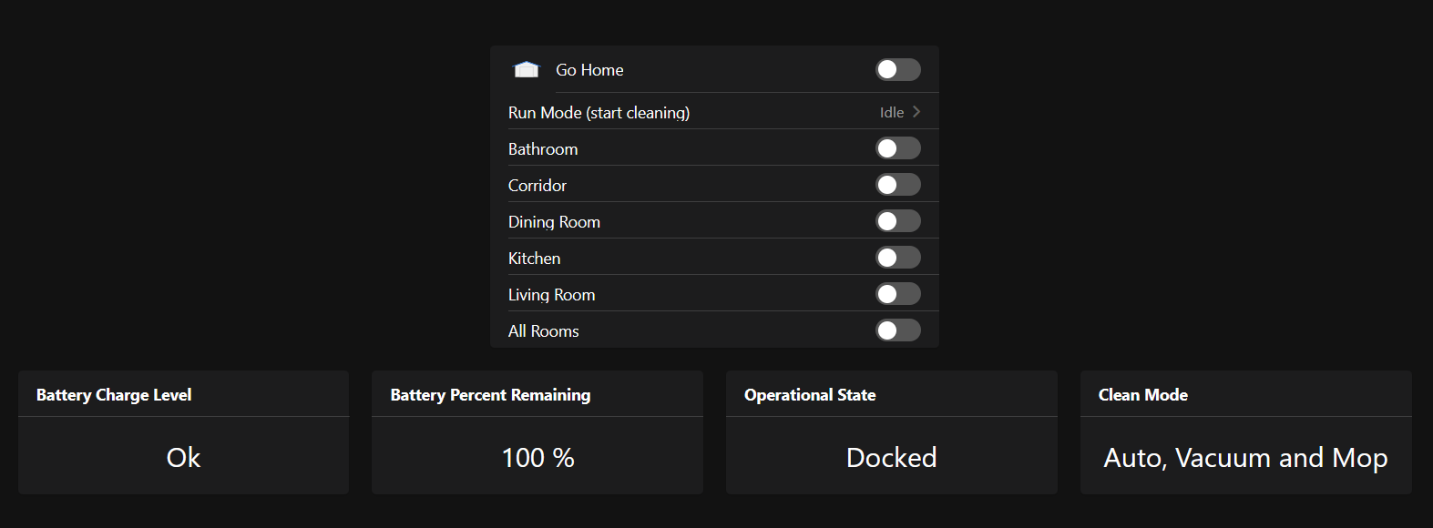

Here are my results of the first short test:
  • no more exceptions
  • no more warning / error
  • new channels, one per room (I got a room “Area 6”, I do not know this room, I have to check my Roborock Floor Plan, at least not Area 51 :grinning_face:)
  • Started cleaning the kitchen and he did it. I’m impressed.

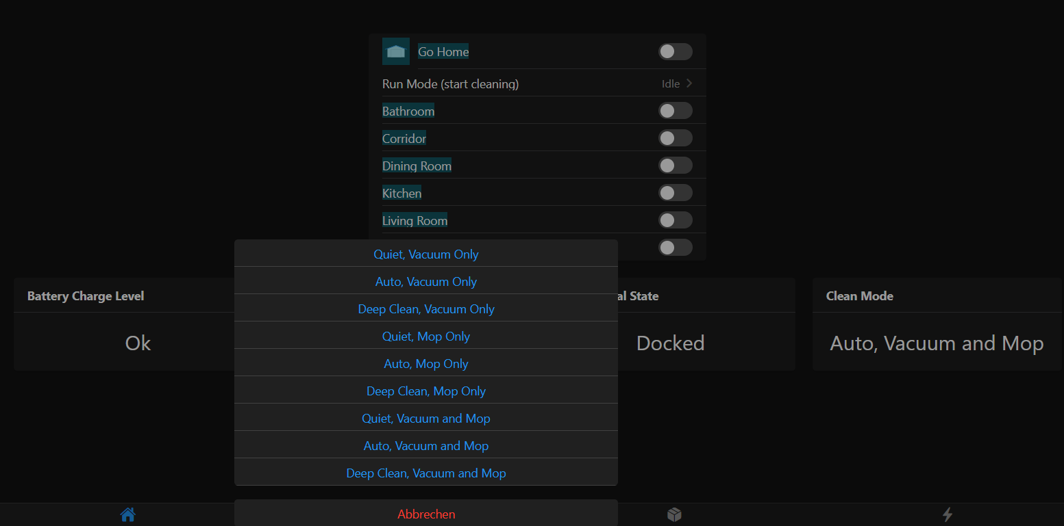

So i see the following cleaning modes, do you not see all of these?
    "label": "Quiet, Vacuum Only"
    "label": "Auto, Vacuum Only"
    "label": "Deep Clean, Vacuum Only"
    "label": "Quiet, Mop Only"
    "label": "Auto, Mop Only"
    "label": "Deep Clean, Mop Only"
    "label": "Quiet, Vacuum and Mop"
    "label": "Auto, Vacuum and Mop"
    "label": "Deep Clean, Vacuum and Mop"

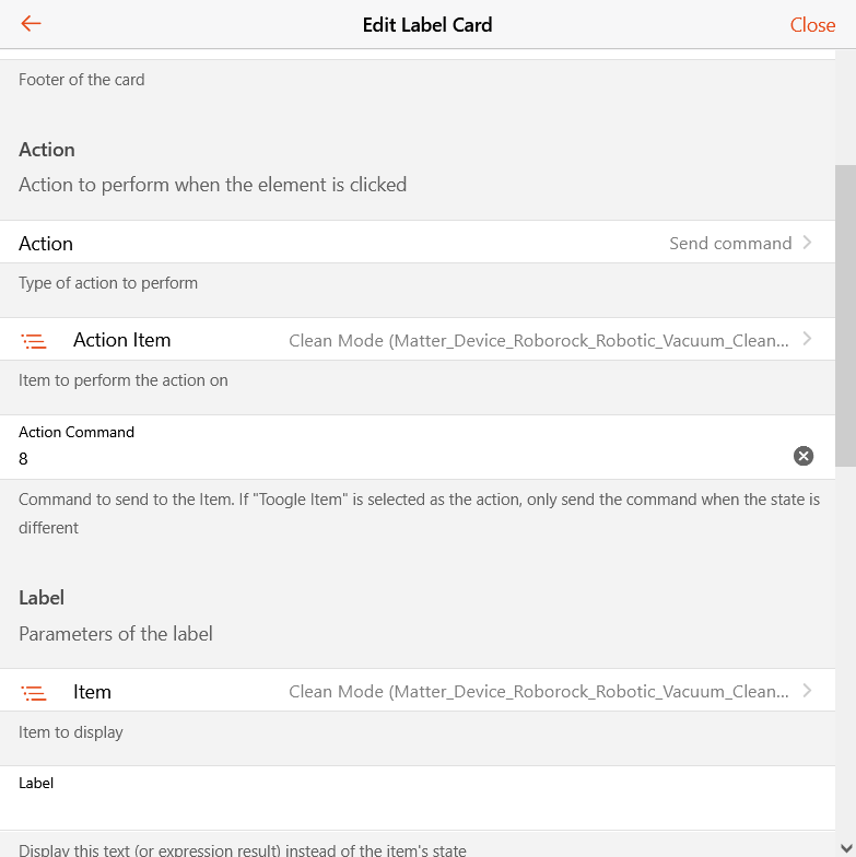

The Main UI should show the text, not the numbers, when using a label card with an action item, is this not happening? If you view the item in the Main UI settings, is it listing the number and not the text?
I couldn’t find Area 6 in my floor plan. So I simply started cleaning Area 6 and watched what the robot was doing. Area 6 is “all rooms.” It would be nice if the channel name could be “all rooms”.

This works
But how do I know as a normal user that I have to enter 8 here for “Auto, Vacuum and Mop”
Yes, this is a possible way to get the code number without a trace. Set the requested mode from the app and get the code number from the item list.
Using the item in a label card shows the text.
Under Action, select “Command Options” not Send Command , action item should be the clean mode item, leave other options alone (leave the command options text box blank)
I have never used this before, nice feature.
