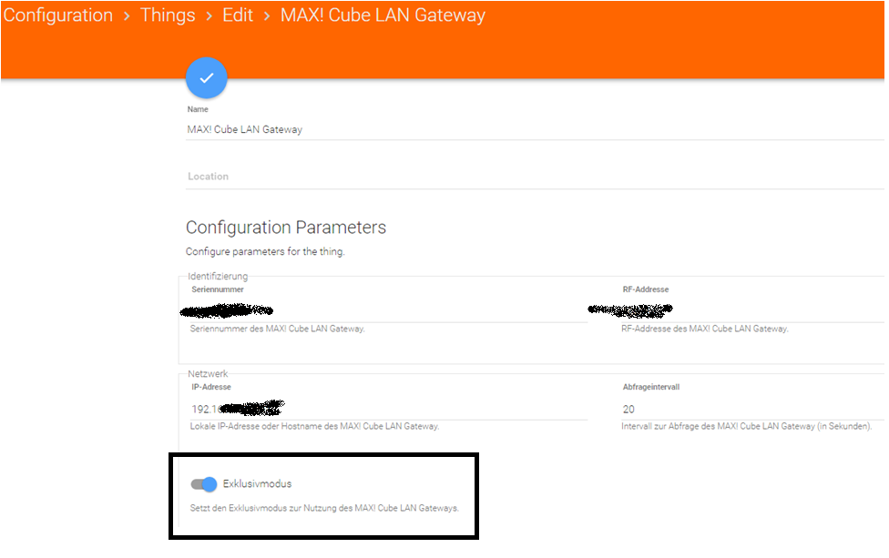

I can confirm once more, since I’m using “exclusive mode” ( for 6 month now!) , MaxCube NEVER lost its configuration.

Hi, what is the “exclusive mode”?
@claudioita
Exclusive Mode: Only Openhab connection to Max!Cube is allowed!
Non-Exclusive Mode: Other connections to Max!Cube (like other APPs, eQ-3 PC Software,…) are allowed in parallel.
Remark: in exclusive mode you are not able to reach the cube with the Max! software. Therefore you have to stop openhab.
