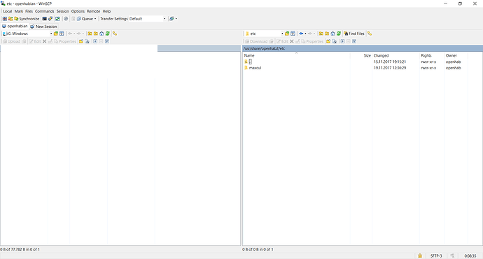

I have done that, see the following link as an extract image from WinSCP: Imgur: The magic of the Internet
I assume, that i changed the rights to write and read accordingly.

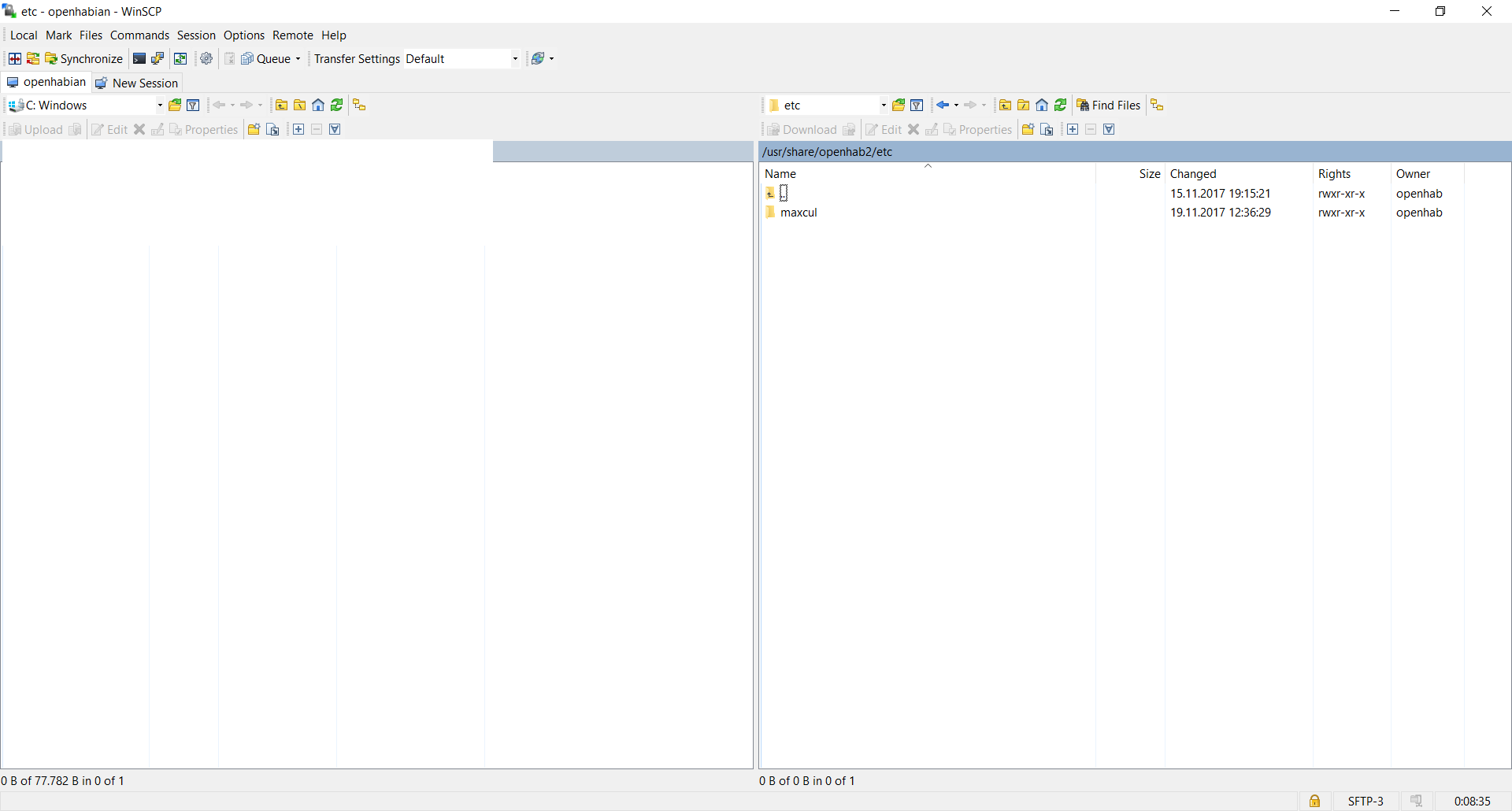

see attached the image from post above
moreover, i am quite sure that it has something to do with the creation of the folder in /etc/maxcul, but i dont know how it is related to this. has i done anything from during creation of this folder? thats why i posted the screenshot of Winscp, where you can see the ownership.

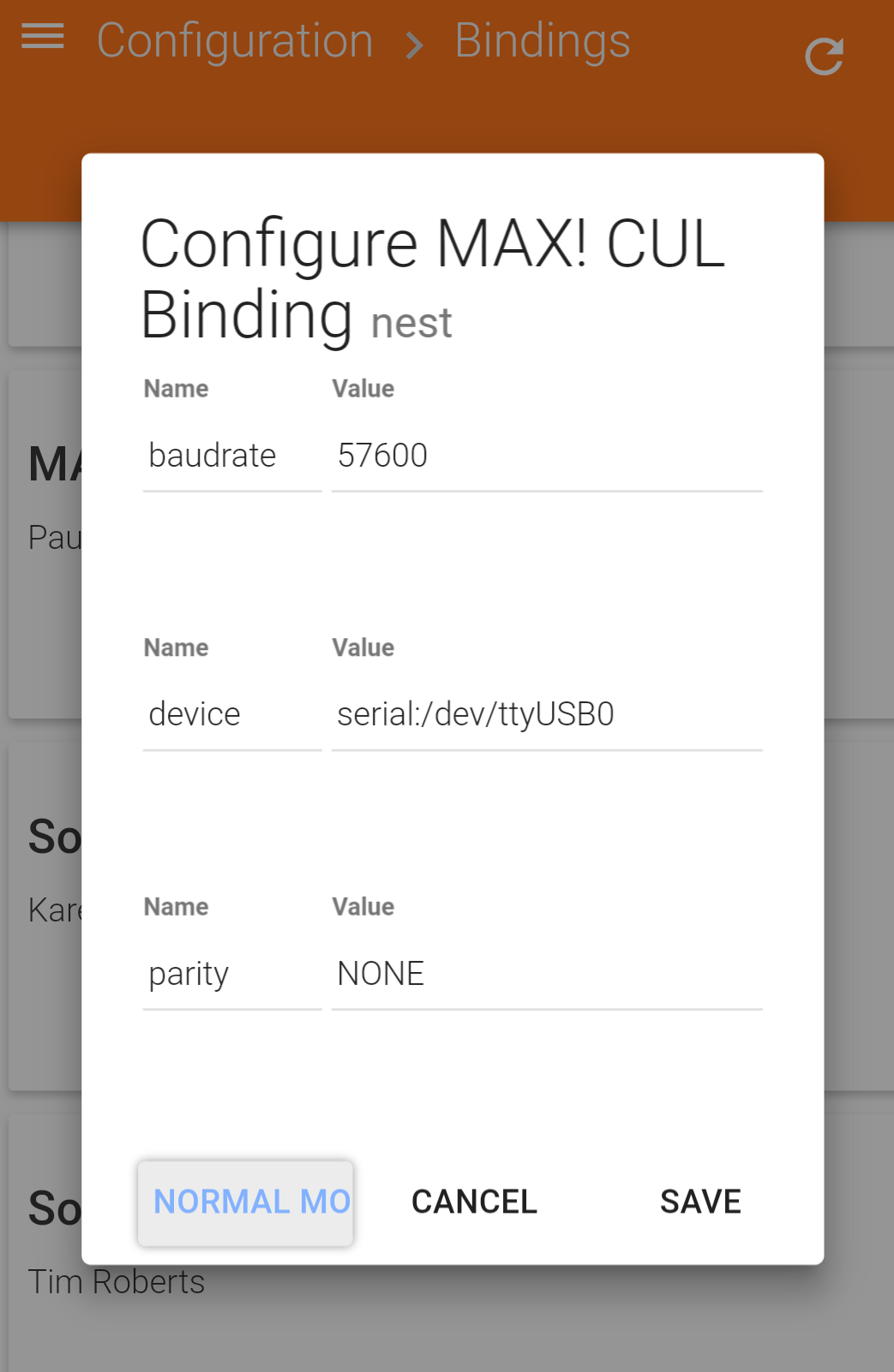

I set the settings in Paperui:
With other settings there is a error in Log that Cul can’t Open.
