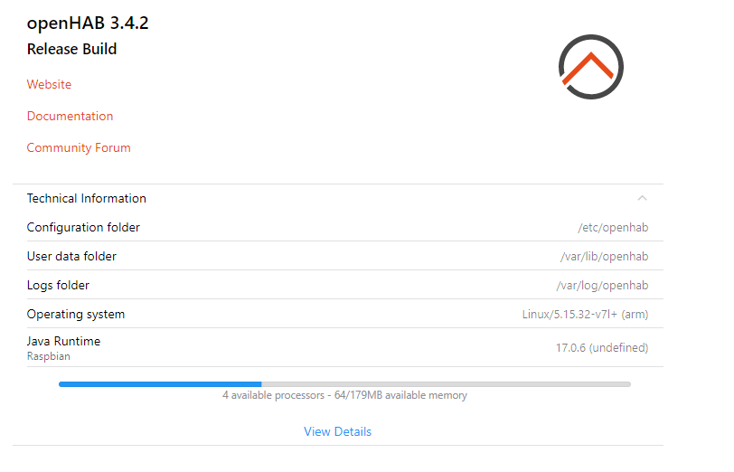

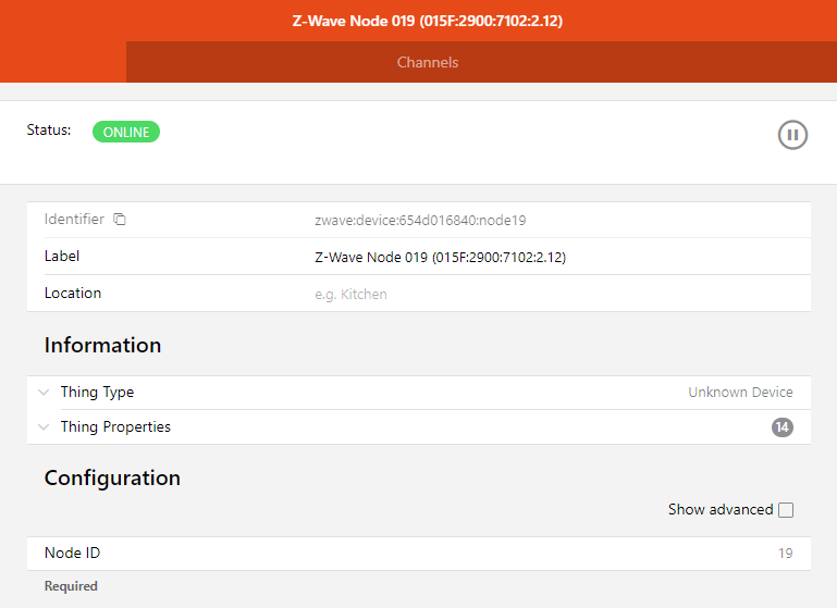

Btw, it looks like openHAB now uses Java 17, but still MCO Home IR Thermostat device shows Unknown Device. I’ve attached openHAB’s about, console’s bundles, and MCO Thing.

There are some things look odd. First is that your device appears online despite the binding not being active. Is there only one zwave binding listed? Second is the osgi.extender error. I haven’t seen that and do not know how to fix. Third it looks like you are still on buster “linux/5” not bullseye “linux/6” and that I thought there were conflicts with java17. Not sure what to advise. If you are not too far along with OH it might be best to backup what you have to a separate computer and burn a fresh openhabian image. It should have everything updated.
