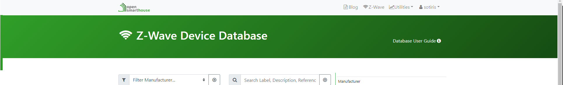

I am logged in, but I can see in the main page, that it is “Under Construction”. Can you verify?
Either way, I have opened a ticket.
That does not seem right. Try clicking around (like the blog, then tools, etc.)
In the other tabs I don’t see the “Under Construction” message. Only in the home screen.
But still, I cannot get to see the the “Create Device" button.
I’m attaching screenshot.

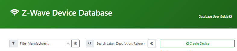

Don’t worry about that, you are on the right page. The “create device” will not appear until the admin gives you write access. I saw earlier in the week he was traveling, so it could be a day or two. What you will see with write access is this;
Thanx a lot! That info relieved me of a lot of stress!
