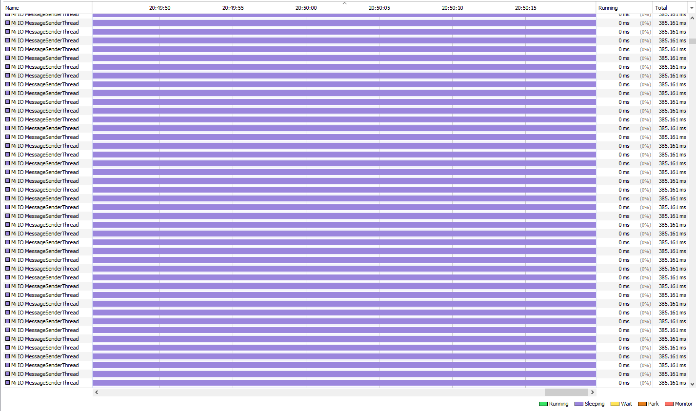

On my machine the leaking started as well:
I do not think i have updated neither openhab (running on a Raspberry PI) nor the Mi IO - Plugin.
But i do apt update && apt upgade regularly. So maybe this has something to do with the runtime envrironment?
I do use the Oracle JDK:
java version “1.8.0_201”
Java™ SE Runtime Environment (build 1.8.0_201-b09)
Java HotSpot™ Client VM (build 25.201-b09, mixed mode)
Any idea?

Edit: Just realized that this thread is about memory leaking, not thread leaking.
Should i open a new thread?
I think this is related to
I’m still in the dark on the cause of it…
Are you using text config or the thing via paperUI discovery ?
I´m using text config only on OpenHAb stable / 2.4.0.
It used to work for quiet a few months without any issues.
Then OpenHab stopped responding and needs to be restarted. It keeps on doing so until now.
After every two days or so the number of Mi IO MessageSenderThreads is within several thousands.
Openhab then runs out of memory giving OOM-Exception:
java.lang.OutOfMemoryError: unable to create new native thread
I made a backup of my config and reinstalled OpenHab freshly - no effect. It runs OOM, having high CPU load and thousands of these threads above.
Can i help with anything?
Greets,
Chris
I guess you have in your thing file you have not defined your deviceId
Can you please add the deviceId for your device (you can see it in the parperUI screen).
I expect that will solve your issue. (it is mandatory config in the current version)
Marcel,
Your are totally right. Adding the deviceId in the .things-File did the trick.
Just one Mi IO MessageSenderThread lives happily.
The moment i remove the deviceId from the .thing-Config, new Mi IO MessageSenderThreads are spawned (and start to sum up till OOM).
I wonder how you found this one. Thank you very much for your precise help!
