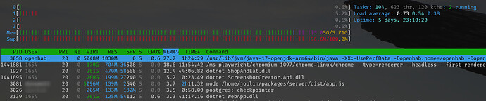

I recently noticed that my Raspi reached its memory (i. e. RAM) limits and I wanted to know which apps consume the most.
I have several smaller apps that I developed myself and therefore I’m aware of their memory implications. However, openHAB’s memory footprint surprises me a bit - but of course, since I’m not familiar with the codebase, this is not a complaint :wink:
Here’s a htop screenshot of my system:
As you can see, openHAB takes 1 GB. What I also noticed is that when changing the htop view so that threads are displayed rather than processes, there are approx. 100 threads related to openHAB. This is probably due to the following setting that I had to set within /opt/openhab/conf/services/runtime.cfg to get rid of openHAB’s startup error Error while connecting: Insufficient configured threads: required=11 < max=10 for QueuedThreadPool[OH-httpClient-nz-deconz-72aca4f3f1]@756c419e{STARTED,5<=5<=10,i=1,r=-1,q=0}[ReservedThreadExecutor@552afaf8{reserved=0/1,pending=0}] :

  1. Taking the above information into account, does 1 GB of memory seem like a reasonable high memory usage for you?

  1. No, that’s pretty typical on a 64-bit OH instance running in a container.

There is a new binding on the marketplace that will tell you in the logs if it looks like you’ve more heap allocated than you really need. That can reduce how much RAM OH grabs and holds onto.
The way Java works is it grabs a certain amount of memory when it starts. It doesn’t free that memory and give it back to the OS even if it’s not being used. However, when the max heap size is exceeded, you’ll get OutOfMemory exceptions in the log. This is an infusion that OH has a memory leak it a memory problem. Java manages it’s RAM usage within the heap.
You can change the minimum and maximum heap sizes by passing environment “JAVA_EXTRA_OPT= -Xms value.
-Xmx value” where “value” is replaced with the min and max heap size desired respectively.
But in general, 800 MB to 1.2 GB is pretty typical OH memory usage. OH is built to manage a while lot more than you are doing with it so it’s going to seem like it’s a lot. But if you had dozens to hundreds of devices, you’d find the memory requirements works remain roughly the same.
