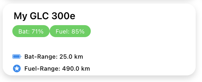

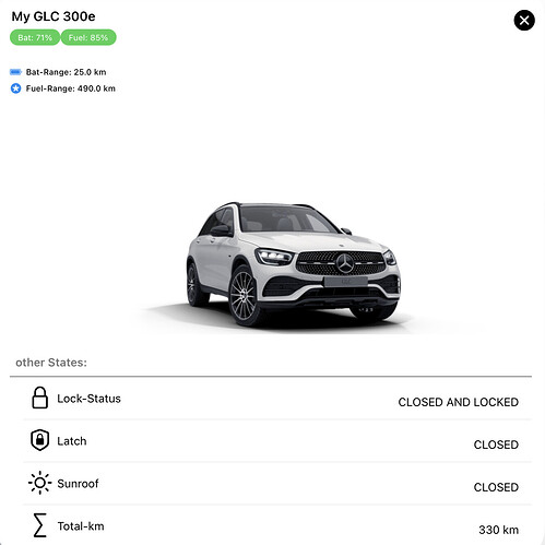

my first OH3 widget for the Mercedes Benz integration.The widget is expanding on click to show more informations. still experimenting with what to view on the closed widget.

Very nice and good looking :+1:
