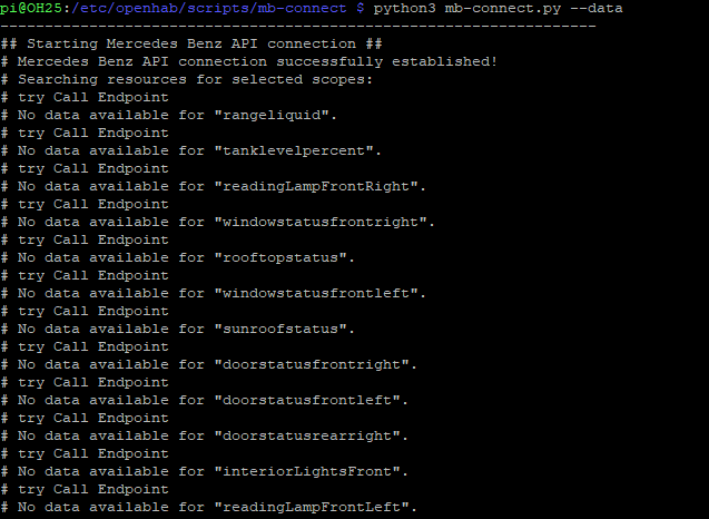

Tried to set it up for my car. Followed the instructions, managed to complete the authentication process. However, when running the script, no data is available for the subscribed APIs. In the ā€˜Mercedes me’ app, I can see all data points.
## Starting Mercedes Benz API connection ##
# Mercedes Benz API connection successfully established!
# Searching resources for selected scopes:
# No data available for "rangeliquid".
# No data available for "tanklevelpercent".
# No data available for "readingLampFrontRight".
# No data available for "windowstatusfrontright".
# No data available for "rooftopstatus".
# No data available for "windowstatusfrontleft".
# No data available for "sunroofstatus".
# No data available for "doorstatusfrontright".
# No data available for "doorstatusfrontleft".
# No data available for "doorstatusrearright".
# No data available for "interiorLightsFront".
# No data available for "readingLampFrontLeft".
# No data available for "decklidstatus".
# No data available for "windowstatusrearright".
# No data available for "windowstatusrearleft".
# No data available for "lightswitchposition".
# No data available for "doorstatusrearleft".
# No data available for "interiorLightsRear".
# No data available for "doorlockstatusdecklid".
# No data available for "doorlockstatusvehicle".
# No data available for "doorlockstatusgas".
# No data available for "positionHeading".
# All available data has been sent to openHAB!
# Done in 25.094502925872803 seconds
Can anyone tell me what I missed?

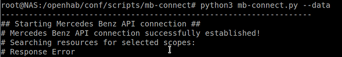

I am also having an issue.
I use latest OpenHAB Version with Docker.
Authentication process worked so far, but when I run the script, there is no data and no error.

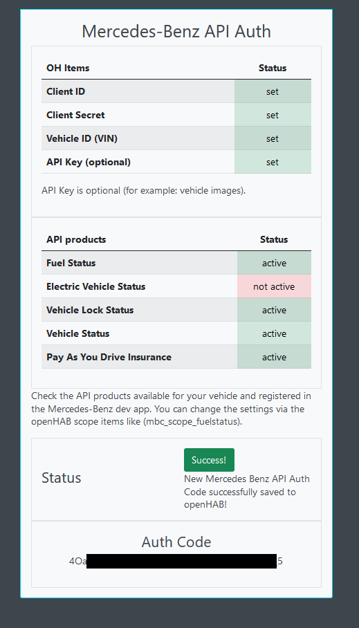

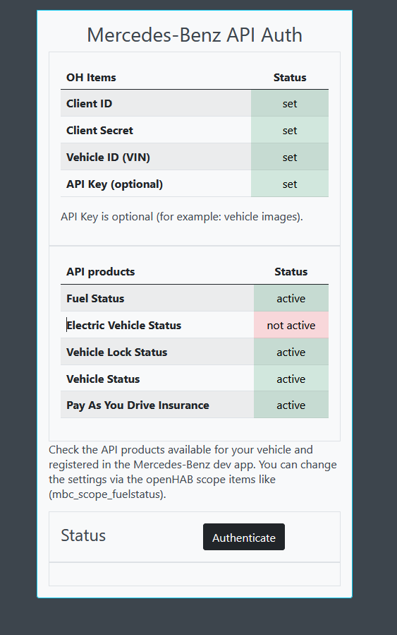

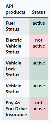

APIs are activated as far as i can see:
Do you have any hint for me ?
Hey Christian,
in your screenshot it looks like you did not activate the scope items for the correct auth URL. Please make sure to set the mbc scope items to on and try again.
Chris

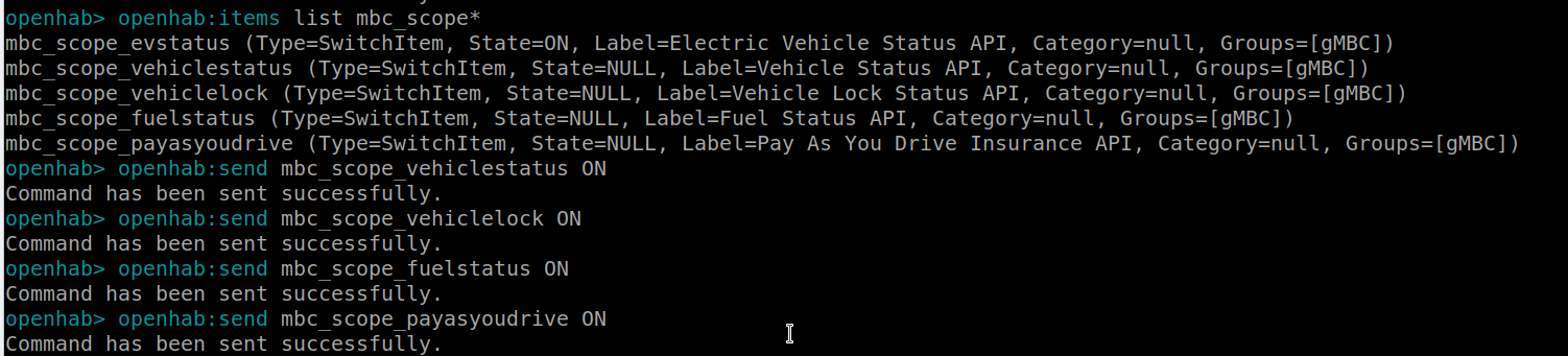

I am not sure what to do, can you give me a hint ?
Edit: I found out
Check my readme file and make sure you did all steps.
  1. set your mbc_spope_* items according to your Mercedes-Benz App subscriptions.
    Example: Got to the openHAB console or the sitemap and set every item you subscripted to ON
In the .items file there are this items:
// API scpoes
Switch                  mbc_scope_fuelstatus                  "Fuel Status API"                                                       (gMBC)
Switch                  mbc_scope_evstatus                    "Electric Vehicle Status API"                                           (gMBC)
Switch                  mbc_scope_vehiclelock                 "Vehicle Lock Status API"                                               (gMBC)
Switch                  mbc_scope_vehiclestatus               "Vehicle Status API"                                                    (gMBC)
Switch                  mbc_scope_payasyoudrive               "Pay As You Drive Insurance API"                                        (gMBC)
Didn’t now how to turn them on but managed it now.
Unfortunately still the same result
But the page now shows all APIs as active
In your screenshot above I see only three matching scopes:
Fuel Status, Vehicle Lock, Vehicle Status
So only these three items may be ON:
mbc_scope_fuelstatus, mbc_scope_vehiclelock, mbc_scope_vehiclestatus
the others must be OFF.
If all these requirements match you have to restart the auth process with these settings.
So go to the html page and click again on authenticate button. then back to the script and try again.

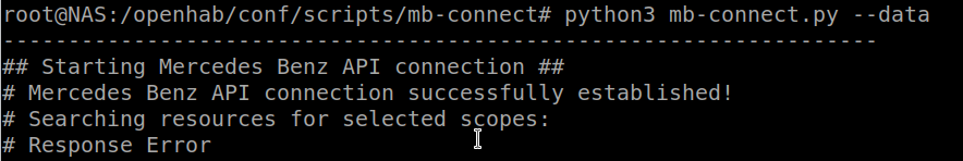

Hi… a reason for ā€œresponse errorā€ could be a wrong VIN number
Regards Mads

From where do you get VIN, I only found FIN
Which has 17 numbers and starts with W1N24XXXXXXXXXX46
for my GLA 250 4MATIC
I guess it is the number I should enter right ?
This is The VIN number
Yes your VIN looks good. Here you can find it on the vehicle:
[SOLVED] …

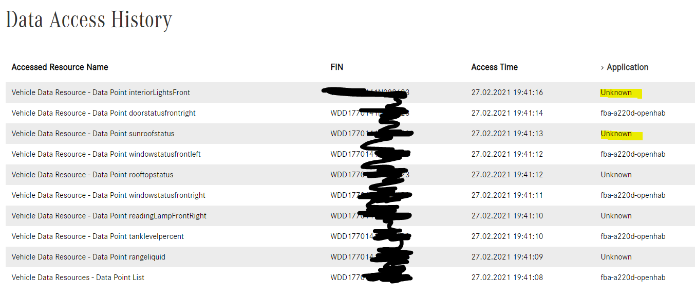

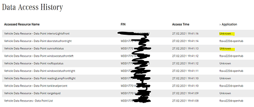

Happy to see that it would now possible to connect my car .. Anyway I’m also facing the same issue … ( not data available for … )..
[ update ] .. This seems to be linked with a problem at Mercedes side .. even if I don’t know if it’s normal that the application name is sometimes the good one ..sometimes set to ā€œUnknownā€ …
Help is welcome :wink: ..
[ SOLUTION – In fact, you just have to drive a little bit with your car in order items are also updated at Mercedes side .. - Everything’s ok right now. I’m going now to enjoy this new add-on. Thanks again for your work ! – Perhaps good to add this extra comment in the procedure to set up the add-on… ]
