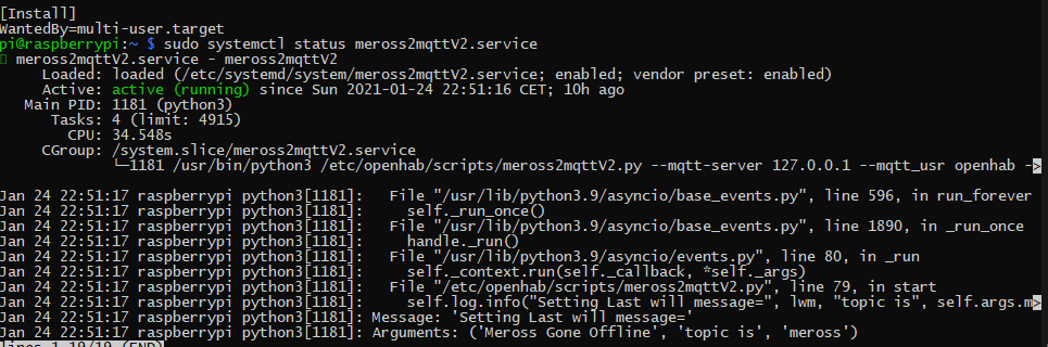

this is my service unit configuration, I copied Denis script into my openhab folder at /etc/openhab/scripts
[Unit]
Description=meross2mqttV2
After=mosquitto.service
[Service]
Type=simple
ExecStart=/usr/bin/python3 /etc/openhab/scripts/meross2mqttV2.py --mqtt-server 127.0.0.1 --mqtt_usr openhab --mqtt_pswd <‘your mqtt pwd’> -e <‘your meross mail’> -p <‘your meross pwd’> -l var/log/meross2mqtt/meross.log
Restart=always
User=openhab
Group=openhab
Environment=PATH=/usr/bin:/usr/sbin:/etc/openhab/scripts
Environment=NODE_ENV=production
WorkingDirectory=/etc/openhab/scripts
[Install]
WantedBy=multi-user.target
Status of my service - it works with the above config despite the last column it’s not Gone or Offline.
No clue what this means, but the service is running at I can control my switches via openhab.

I am still getting this error, as mentioned before:
Mar 23 09:57:12 openHABianPi python3.9[1922]:   File "/usr/local/lib/python3.9/asyncio/base_events.py", line 596, in run_forever
Mar 23 09:57:12 openHABianPi python3.9[1922]:     self._run_once()
Mar 23 09:57:12 openHABianPi python3.9[1922]:   File "/usr/local/lib/python3.9/asyncio/base_events.py", line 1890, in _run_once
Mar 23 09:57:12 openHABianPi python3.9[1922]:     handle._run()
Mar 23 09:57:12 openHABianPi python3.9[1922]:   File "/usr/local/lib/python3.9/asyncio/events.py", line 80, in _run
Mar 23 09:57:12 openHABianPi python3.9[1922]:     self._context.run(self._callback, *self._args)
Mar 23 09:57:12 openHABianPi python3.9[1922]:   File "/etc/openhab/scripts/meross02.py", line 79, in start
Mar 23 09:57:12 openHABianPi python3.9[1922]:     self.log.info("Setting Last will message=", lwm, "topic is", self.args.mqtt_ident)
Mar 23 09:57:12 openHABianPi python3.9[1922]: Message: 'Setting Last will message='
Mar 23 09:57:12 openHABianPi python3.9[1922]: Arguments: ('Meross Gone Offline', 'topic is', 'meross')
Is this normal?
Hello @daJoe ,
The error you got was simply caused by old formatting code. It was not harmful and offending line could have been commented out but it is now corrected in the latest version of this code. Also added the try .. except in case the asyn_update takes more time than expected (5 sec)

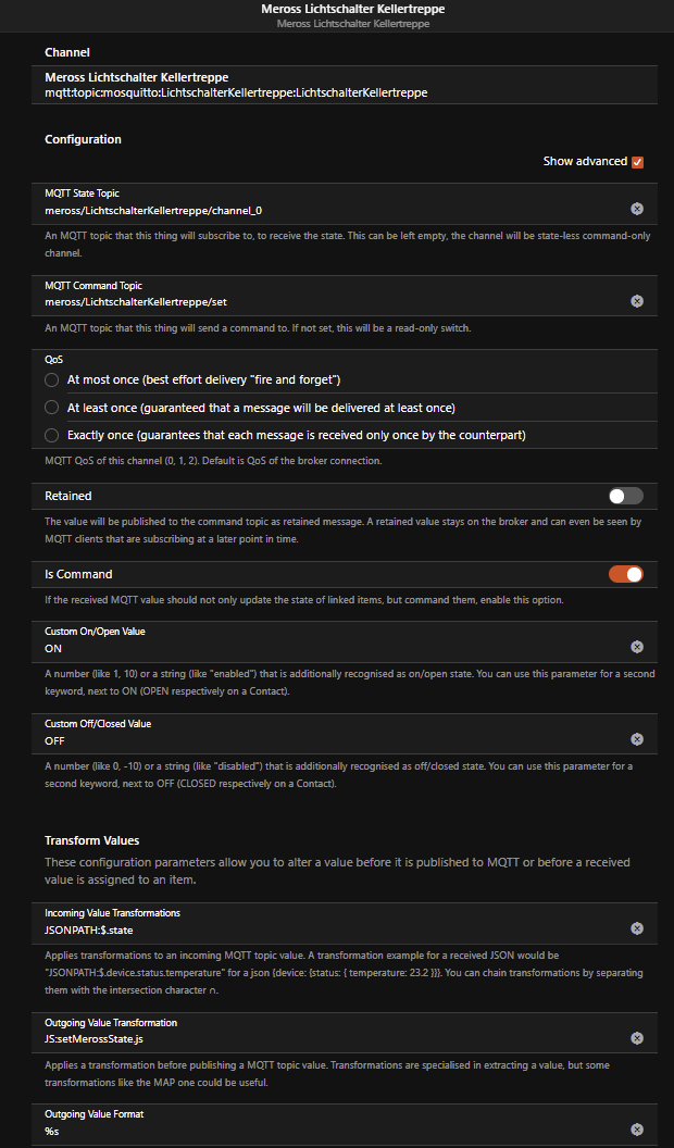

I have just add in channel
mqtt state topic
meross/Fönstret/channel_0
mqtt command topic
meross/Fönstret/set
custom on
ON
custom off
OFF
Is command
switch to on
@Andreas3
You have to active the right transformations in OpenHab:
JSONPath Transformation
Javascript Transformation
Then it should work.
Yes. You need to go in Advance mode for the regarding channel and fix those two fields:
incoming Value Transformations
JSONPATH:$.state
Outgoing Value Transformation
JS:setZigbeeState.js
where setZigbeeState.js is simply this code that goes in the transform Openhab3 directory:
(function(x){
    var result = new Object();
    result.state = x;
    return JSON.stringify(result);
})(input)

I add/update the incoming and outgoing value in OH3.
I add the merossfile.js in /etc/openhab/transform
reboot
run meross2mqttV2.py script
Mqtt explorer
meross ={“state”:true}
Fönstret
channel_0 ={“state”:“OFF”,“type” etc etc
set = {“state”:“OFF”}
