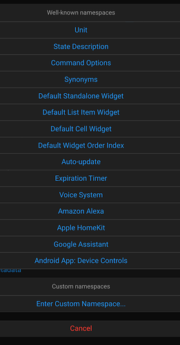

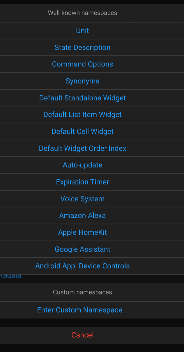

In MainUI you can find all the well known metadata options by navigating to Settings → Items → Any Item from the list. Click on “Add Metadata” and you’ll see them all in a list. Selecting one will give you a form explaining and letting you set any of the options for that metadata.

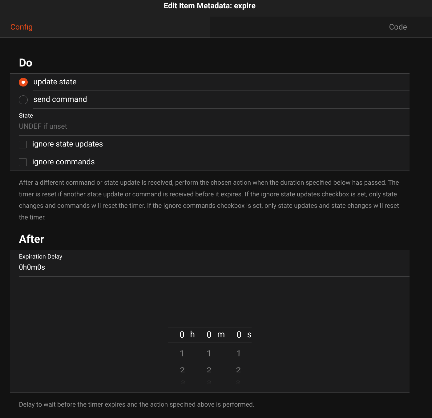

Clicking on “Exiration Timer” gives you
Clicking on the code tab shows the settings as YAML.
value: 0h5m0s,command=OFF
  ignoreStateUpdates: "true"
That can be translated to .items files as follows:
<namespace>="<value>"[<config1>=<value1>,<config2>=<value2>]
The values is required but if there is no value use an empty string "". If there are no configs leave out the [ ].
The above would translate to:
expire="0h5m0s,command=OFF"["ignoreStateUpdates"="true"]
Metadata Purpose
Unit if the Item is a Number:<type>, sets the unit the Item’s state will be converted to prior to updating the Item
State Description a collection of properties to control how the Item is displayed on the UIs
Command Options Mapping between commands sent to an Item and commands that get sent to the Channel.
Synonyms Used by HABot, alternative names for the Item
Default X Widget Used to control how MainUI displays the Item by default
Autoupdate When false the Item will not be updated in response to a command, default is true
Expiration Timer how long after an Item changes from a given state that it is commanded or updated back to that state
Voice System Settings for the Item used by the voice subsystem
Amazon Alexa, Apple Homekit, Google Assistant Controls what Items are exposed to these third party services and how they are exposed
Android App Device Controls Android App | openHAB
