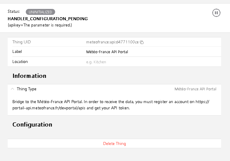

I have now updated to 4.3 and installed the Meteo France binding but I must be doing something wrong. For starters, the bridge does not start with this error:
I went to the portal, and I believe this is the API I must register for: MeteofranceWeb
I’m able to get an API key for a given duration, but where do I input it for the bridge to use it?
And if that API key is only for alerts, which other dataset must I register for to get the “rain in the hour” forecast?
