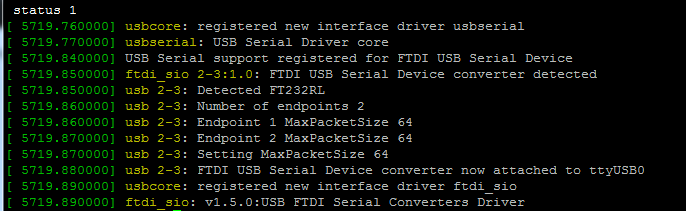

Hi. I look in the thread you gave me and when I used the -dmesg-command follow text appear:
Do you think this enough for communication or do I need further serial drivers?

I guess this shows some sort of problem in the serial driver, but I’m not really sure what - sorry.
