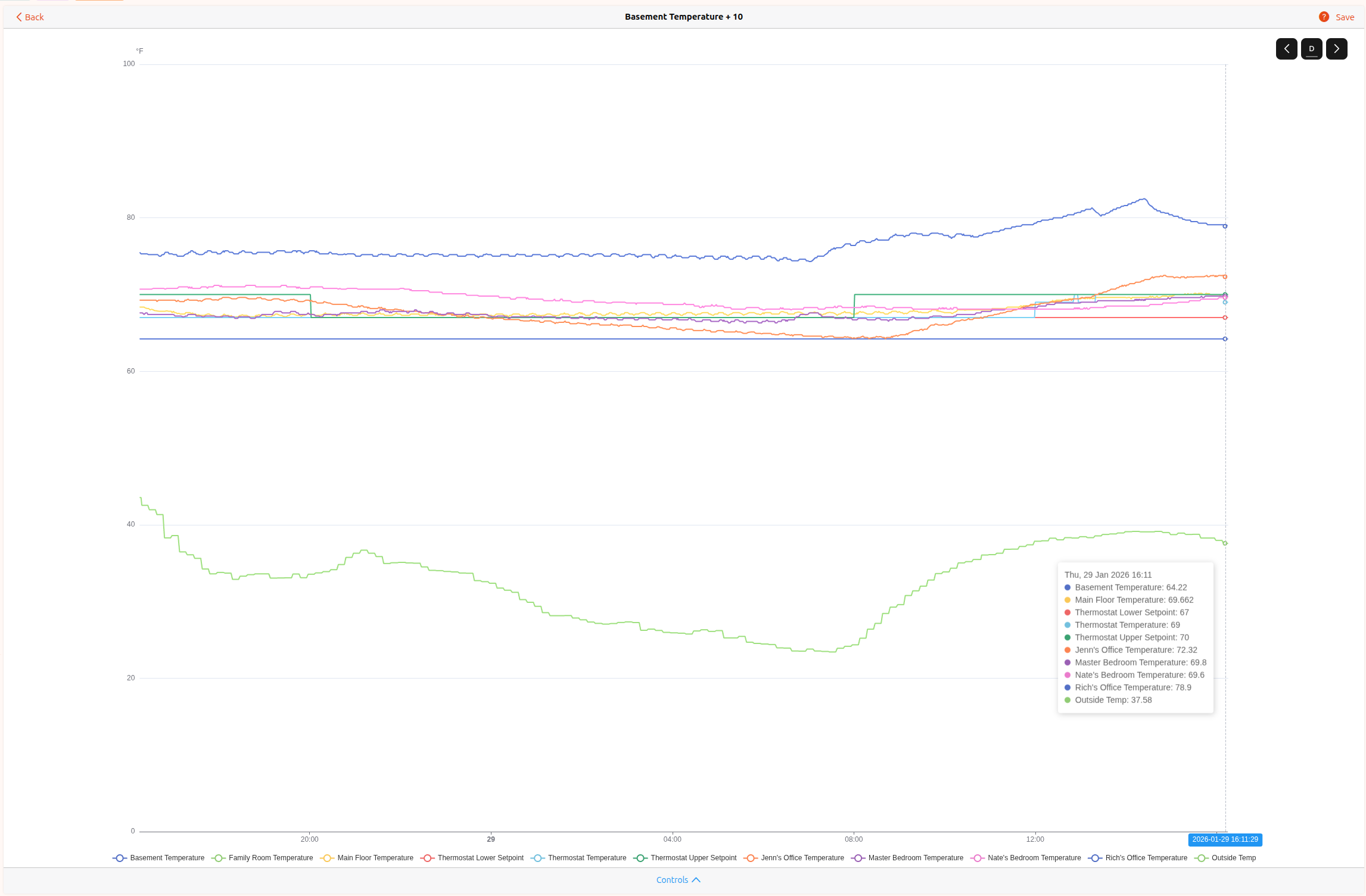

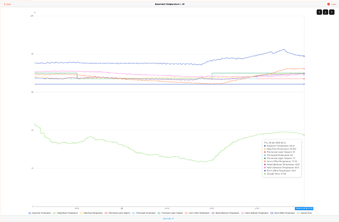

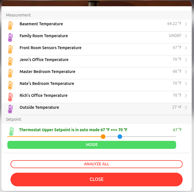

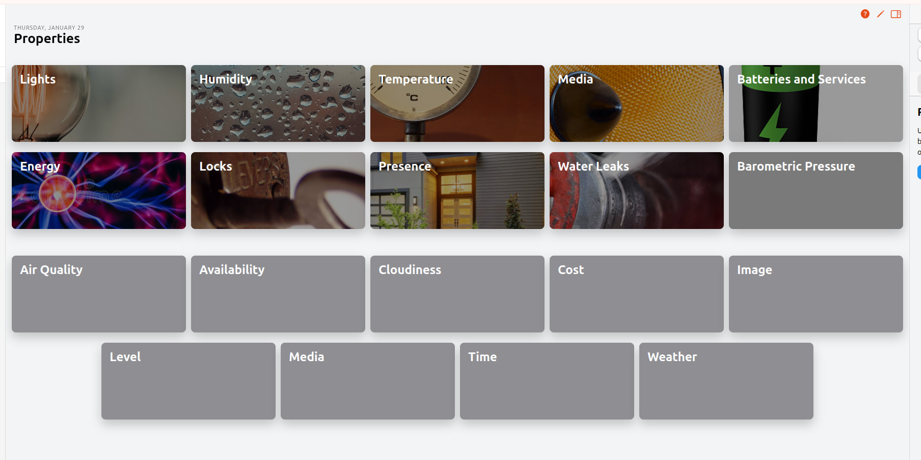

And I didn’t even have to do anything to get that chart. I configured the semantic model and just clicked on “Analyze All” on the Temperature card on the Properties tab. I could even further customize that by adding or removing Items and saving it and I can add it to a page or treat the chart as a page all by itself.

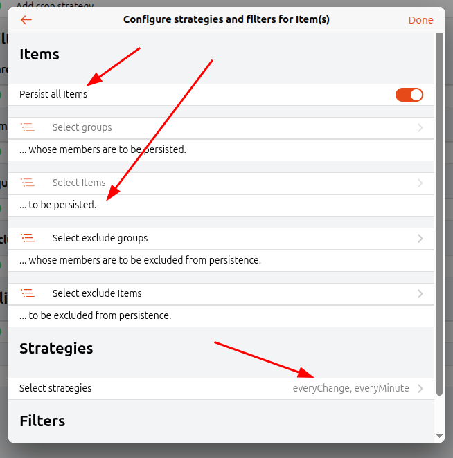

MainUI → Settings → Persistence
But the ability to configure persistence through the UI is relatively new, so the docs are not so great.

My persistence config is super simple. The code tab in the UI is
configurations:
  - items:
    strategies:
      - everyMinute
      - everyChange
    filters: []
aliases: {}
cronStrategies:
  - name: everyMinute
    cronExpression: 0 */1 * * * ?
thresholdFilters: []
timeFilters: []
equalsFilters: []
includeFilters: []
Which would be the following in a .persist file:
Strategies {
  everyMinute   : "0 * * * * ?"
Items {
  * : strategy = everyChange, everyMinute
This is rrd4j so everyMinute is required.

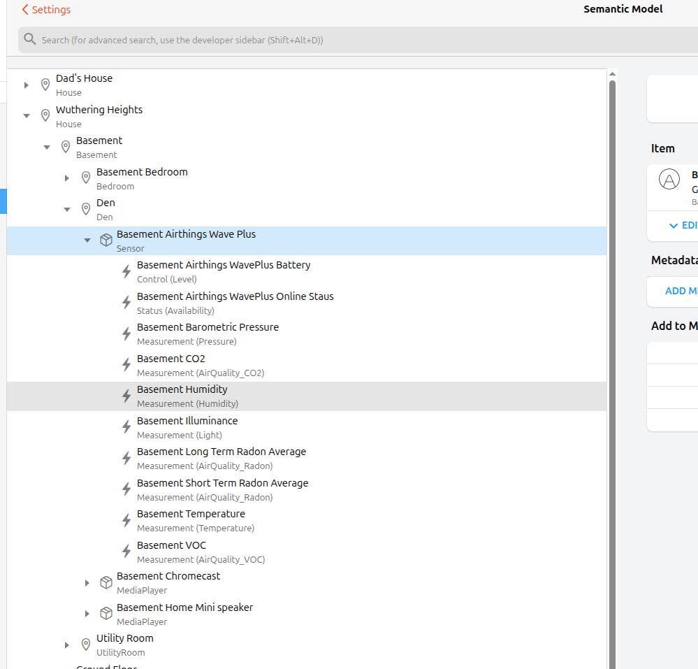

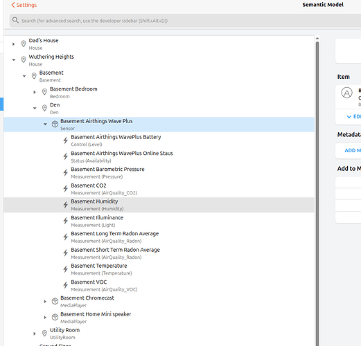

And I confiugured my semantic model:
Which populates the Overview tabs.

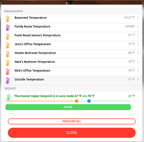

To bring up the chart above all I did was click on “Temperature” and then “Analyze All”
That’s it. A Persistence config to save all Items on everyChange and once a minute (because I’m using RRD4j) and some effort setting up the semantic model. I didn’t need to do anything complicated or special. Based on this .persist file I’d say you are making it overly complicated to start with.
