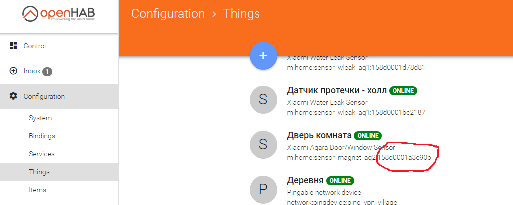

i am trying to showing up my xiaomi windows sensor in my apple homekit but i am unable to find tags for this
xiaomi string:
Contact WindowSwitch_Status { channel=“mihome:sensor_magnet::isOpen” }
but i do no know or [“door”] or what ever is working
also i am unable to get working xiaomi gateway lamp
i have it in my homekit app but i am unable to turn it in or off
but when i turn it on from xiaomi app they show up like turned on in homekit app
it seems that xiaomi lamp is unable to manage from homekit
do you have any experiences with xiaomi integration ?
thanks

@binderth
thanks i saw this document and that’s mean i am not able to add contact sensor via openhab to homekit ?
@Olymp
i had this string and xiaomi ID
but i am unable to integrated it via homekit bindings
do you have your xiaomi devices working with homekit ?
my xiaomi temerature is fine with this
Number HT_Temperature_studio “Studio temperature” [ “CurrentTemperature” ] { channel=“mihome:sensor_ht:158d0001f4ec83:temperature” }
i never tried Contact, but my guess is, it won’t work: ['Switchable'] will return ON/OFF and not OPEN/CLOSED… you could still try. but there’s definitely no ['Door'] in homekit.
you could either change your item to Switch instead of Contact or you could expose a proxy item as Switch to the homekit and have a rule Change your Contact item accordingly.
