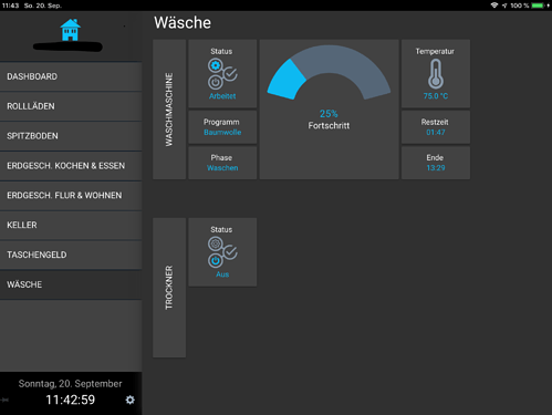

Fantastic news, I was afraid that the project got buried by Miele. Thanks for keeping us in the loop @BjoernLange, happy to participate in the open beta and to report back.
Quick first feedback: Installing the binding and pairing with my Miele account worked without any issues. I very much like the good guidance for the pairing and the possibility to copy&paste the things config. Well done!
Started polling data for my washing machine, at first glace it seems to work, will start testing now with real world activities. Already added two feature requests on github, a third one may follow. Later on, I will add my dishwasher and tumble dryer.
