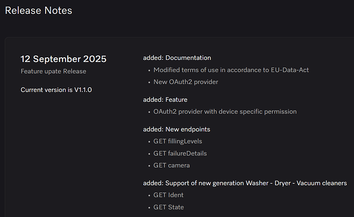

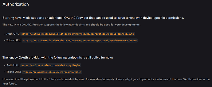

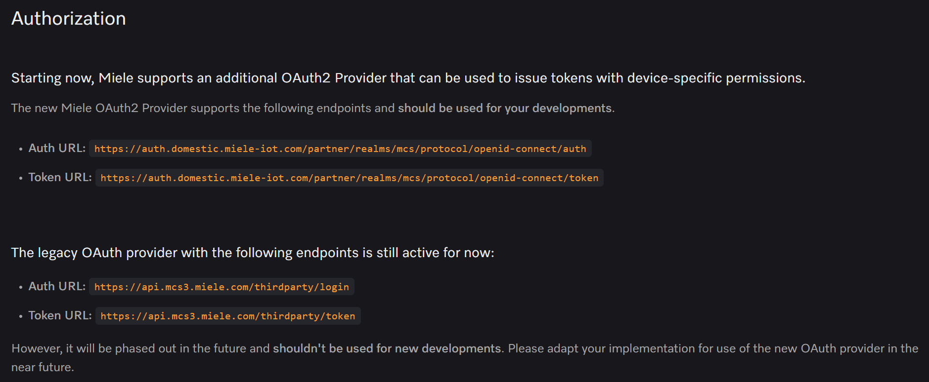

Found this note on the deloper.miele.com page:
According to what i found there, the old authorization method should still work, at least for now. But this isn’t the case. Related Miele server links seem to be dead.
