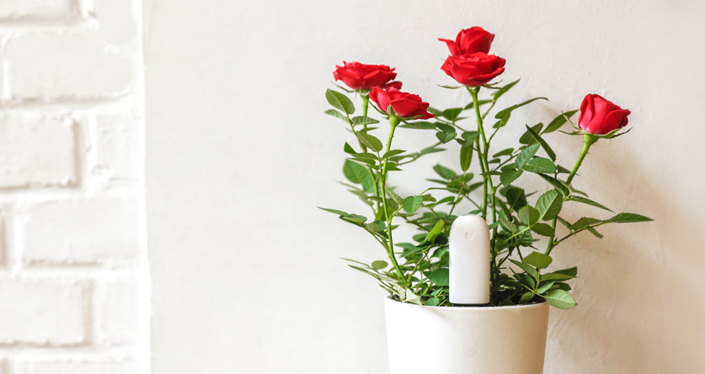

Miflora cheap window and door sensor, water sensor, blind sensor etc
Miflora is a cheap(approx 10usd) small (4x2x1cm) waterproof sensor with a battery life time of 1 year +(??). It has temperature, humidity, water detection and light intensity.
So this sensor is great to monitor your plants but it can also be used for other things! So I will spread some ideas here :slight_smile:
