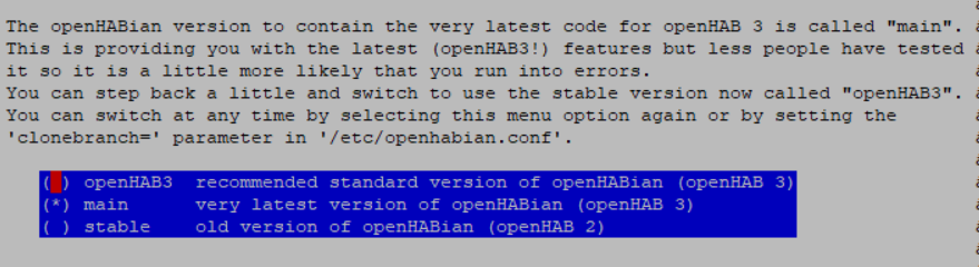

I did find this that references branch of MAIN /etc/openhabian.conf.
Capture
What do I change this to (testing)?
Best, Jay
Wrong menu. go to “40 openHAB related” and choose Milestone for option 41.
Thank you Rich, it worked.
