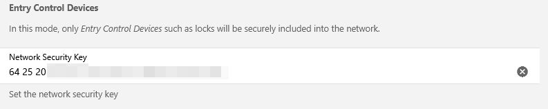

No, the secure inclusion key is not on the controller. That would have to be transferred separately. In OH the controller Thing will have the secure inclusion key. Though IIRC it doesn’t show in MainUI (it just shows *****) so you may have to pull it from the JSONDB manually. But it’s definitely not part of the backup/restore.
If the Thing is gone, it might be in the JSONDB backups.
Nope, it is shown:
OH 5.0.1
As to the key(s); If you did not include any devices securely it doesn’t matter. If you did, in OH it used the S0, so that will need to match on the ZUI settings page. The other S* can be anything.
