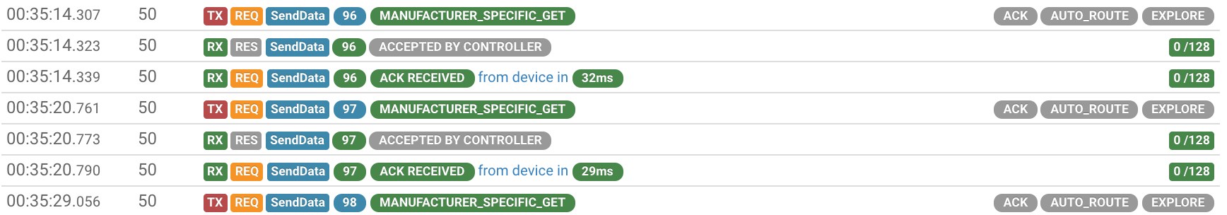

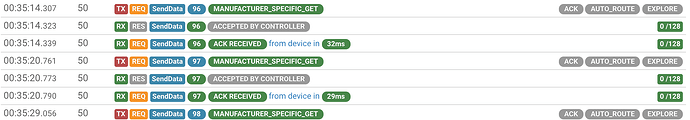

So the real issue here is that the device is not responding to the request for the manufacturer data -:
We see the binding send the request for the manufacturer information, and the device sends the ACK to say that it received the command, but we never receive the data. This repeats continuously.
I’m not sure what to suggest with this - the previous log showed a similar sort of response (ie. no response) to the VERSION command class, so something very strange is happening with this devices responses.
The only thing I can suggest is to reset the device to factory defaults to see if that helps. In theory, excluding the device should do the same thing, so I’m not convinced it will help, but it’s about the only thing I can think of at the moment.
