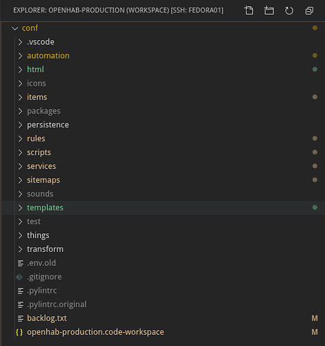

Oh! These are the linter warnings in VSC! Check out this post to clean those up. I’ll be making a commit soon to the HL repo for this. I’ve actually added some more to it, but this should get you by.
I managed to get it working. Placing in the conf folder is right.
However after a restart VSCODE said that there is a pylint file, should pylint be enabled or something like this. But after pressing Yes, the same happened.
Opening the command palette and selecting Python Linter as pylint helped.
However if you can specify what should be turned off… Can it be somehow enabled (I mean specifying these in the pylintrc file) to auto-complete these default variables? Like you said items, and ir, events, etc… are in the default scope so it will be always available, so only a static list of these variables would be enough and really could help in the migration process, especially in typos…
