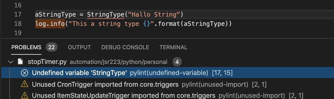

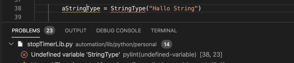

If I do not explicitly put
from core.jsr223.scope import StringType
in my library modules, pylint complains and at execution, I get an error:
2020-02-20 18:34:16.809 [ERROR] [ipt.internal.ScriptEngineManagerImpl] - Error during evaluation of script 'file:/openhab/conf/automation/jsr223/python/personal/stopTimer.py': NameError: global name 'StringType' is not defined in <script> at line number 14
If I use the same in my rules fle pylint complains too, but the code executes.
2020-02-20 18:39:22.406 [INFO ] [jsr223.jythonstop.timer.log         ] - This a string type Hallo String
OK, thank you. Our terminology is not translating well :slightly_smiling_face:! What you are doing is safe and recommended. However, the following is what I was warning about and will cause you trouble in the future…
from org.eclipse.smarthome.core.library.types import StringType
If you configure your .pylintrc properly, this will not occur.

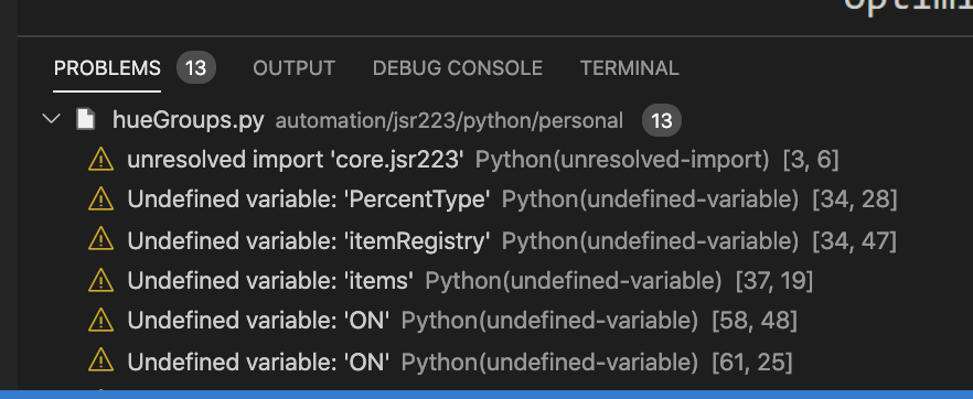

what am I missing here
Use this…

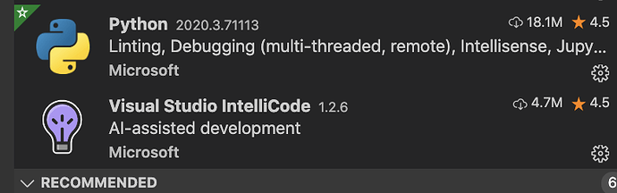

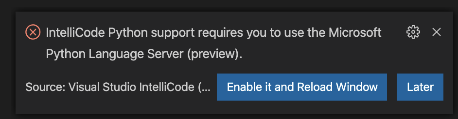

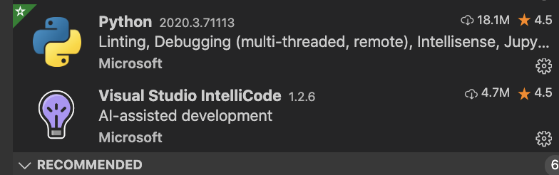

The last few days a popup regarding “Visual Studio IntelliCode” was driving me nuts. So I clicked it away, unfortunately, this time with “ok”.
Now I cannot get rid of the old false messages in the error pane:
Any idea of what to revert. I uninstalled and installed both extensions:
Before uninstalling VSCode
Solved it by deleting the users settings.json, which had these entries:
    "window.zoomLevel": -1,
    "editor.suggestSelection": "first",
    "vsintellicode.modify.editor.suggestSelection": "automaticallyOverrodeDefaultValue",
    "git.autofetch": true,
    "python.jediEnabled": false,
    "vsintellicode.python.completionsEnabled": false,
    "vsintellicode.features.python.deepLearning": "disabled",
    "python.autoUpdateLanguageServer": false
Though the popup reapeares :slight_smile:
“Later” Is my only option now!
