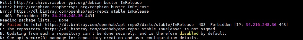

  • On startup, openhabian-config tries to access bintray, which of course fails.

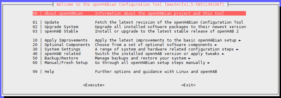

  • There is no menu item in openhabian-config for the update to OH 3.
    openhabian-config
  • I could successfully run menu items “01 Update” and “02 Upgrade System”, but still no update option for OH 3 available.

Addendum:
Here are the messages that appear on startup of openhabian-config:

No reason to believe it should. The docs don’t say that, do they.
Second, the master branch has long been deprecated. Your openHABian is ancient because you have not updated in a long time that’s why it has no upgrade option.
