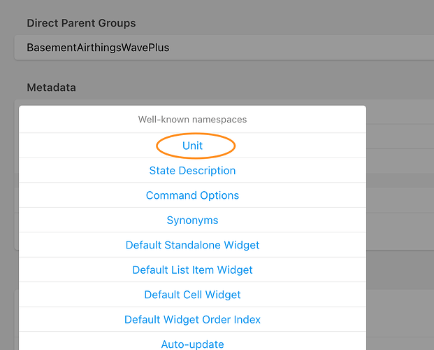

I thought that “system.battery-level” is a system-channel type which should provide right units of measure. And it provides something, otherwise the UI display “one”, but it displayes “%”.
I tried to define unit of metadata for the item as you adviced, but UI does not allow it (I have done it for group aggregation items and it helped there, thanks for the advice). I think it is becase the unit of measure was provided by channel.
It look like a bug, but I hard to belive nobody found it since 4.0 was released. Maybe I do something wrong?
