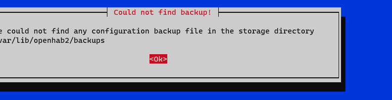

It looks like an error in openhabian-config. I created a Symbolic link. After next try of restore:

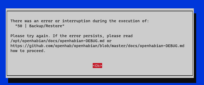

Do you see any errors in the shell that are printed while the config tool fails? It usually will still print output to the shell that you can see once you close the config tool…
sure:

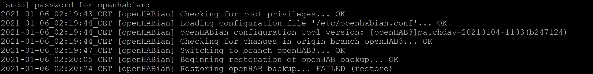

I also tried a restore from a v2.5 backup to oh3. I am currently running the latest 2.5 on Windows 10. I created a backup zip file there using the batch routine, copied it to my Raspberry Pi running a fresh install of OH3, and did a restore using the configuration menu.
It failed without any details on the reason for the failure (puTTY screenshot attached). And now I get a ‘site can’t be reached error’ when I go to http://openhabiandevice:8080/.
