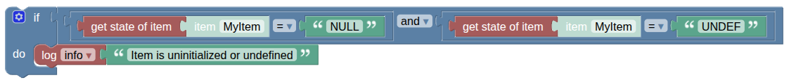

In Blockly, you’d compare the state of an Item to see if it’s NULL using
Notice it’s a String comparison.

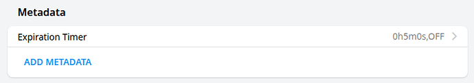

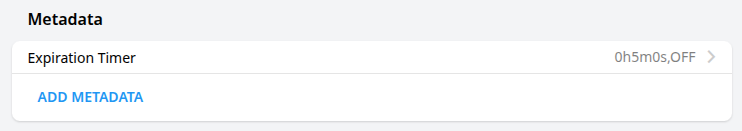

What I know is that the rules worked fine before the upgrade and were broken right after. It’s kind of hard to miss since they trigger the presence display, so I’m reasonably sure about the behaviour change.
I also know adding the comparison to null fixes it under current conditions. It admittedly surprised me a bit since it’s been ages since I wrote anything in JS by hand and am more used to Java style behaviour. I thus suspected that in Blockly, before the upgrade, the comparison defaulted to FALSE before if the value was not set - but I have not tried to replicate that on OH 4.3 with the old OS and cannot easily, now.

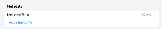

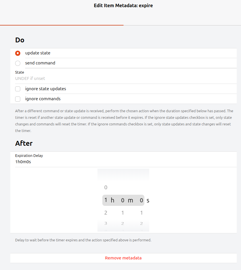

However, the source of the missings are MQTT fed item states with an expiration timer. In the updated rules that now work again, I’m using a “number” type for the input variable and the “null” block from the logic subcategory in Blockly for comparison (an “undefined” block exists also, but “null” comparison seems to be enough to fix it in production for now), which produces the code quoted above in the code view.
So I guess a different hypothesis could also explain the phenomenon, given this discussion: did the way OH represents expired items or missing values at the interface to the rules engine change, i.e., how var inputValue = items.getItem(‘TestItem’).state; behaves wrt. missing/expired values? I.e., did the input to the script rather than the comparison behaviour of the language change?
After modifying the rules, it works fine for me now. Just wanted to make sure to share this in case anyone else runs into similar issues or there are fixable root causes.

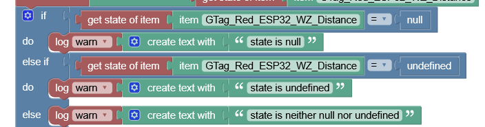

Just tried this on my current OpenHab 5 install with the real-life input item, which has an auto-expiry set up and is currently empty (and prints as an emtpy string from Blockly/JS):
which produces this code snippet
if (items.getItem('GTag_Red_ESP32_WZ_Distance').state == null) {
          console.warn('state is null');
        } else if (items.getItem('GTag_Red_ESP32_WZ_Distance').state ==
        undefined) {
          console.warn('state is undefined');
        } else {
          console.warn('state is neither null nor undefined');
and outputs “state is null”.
Thoughts?

As I’ve been saying, you never want to compare [get state of item] to null. That is never supposed to be null. There was only a brief period where null was possible, and it was fixed quickly.
If the Item’s state is NULL, [get state of item] will be the String "NULL". It will never be null.
If the Item’s state is UNDEF, [get state of item] will be the String "UNDEF". It will never be undefined.
Nothing associated with an Item will ever be undefined except in the case where the Item doesn’t exist. You’d test for that using [get item][MyItem] == undefined though as testing [get state of item][MyItem] when MyItem doesn’t exist will throw an error “undefined doesn’t have a property state” or something like that.
I posted above the Blockly if statement you should use to test if an Item’s state is NULL or UNDEF. Testing against the strings is the only valid way to test for this.

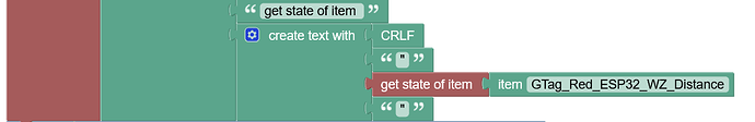

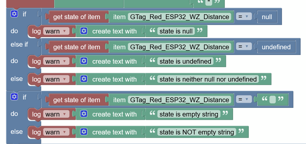

Tx for the explanation about string comparisons. Unfortunately, that simply doesn’t seem to apply here unless I’m missing something:
this
outputs this
get state of item
so the item state clearly appears to not be string valued with “NULL” or whatever content, but actually null (see above) in my case.

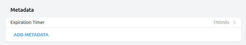

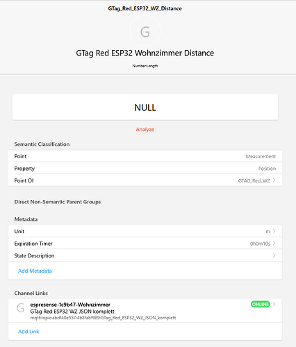

I do not have the MQTT stuff back up and running yet which would update this auto-expiry item with real data to I cannot exclude that this is some weird persistance (I’m on an external MariaDB) or auto-expiry related issue.
No, if it were null it would have logged out "null". The state of the Item is the empty String, which isn’t NULL, nor null nor UNDEF nor undefined.

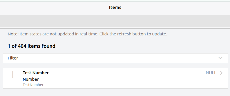

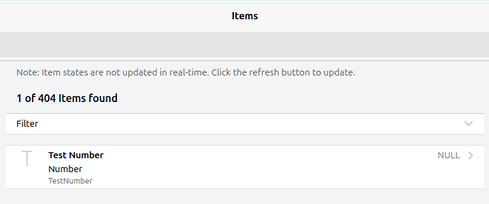

What kind of item is this? what’s is the state of the Item shown on the Settings → Items page (note the unformatted state is shown there).
I can walk you through both the Java and the JS code to show you how the state of an Item in JS and therefore Blocky can never be null if you think it will help. From the moment the Item is created, its state is initialized with NULL and it’s impossible to set the state to anything but an OH state Object (NULL is an OH UnDefType Object).Attempting to do so generates and error.
Here’s the item as shown in the UI:
I’m afraid I really don’t have the time to dig into the sources right now, just wanted to make sure to point out a potential issue. It does seem that in this specific situation, Blockly really does see a null, not an empty string, as this
corresponding to this piece of code in the code view
        undefined) {
        } else {
        if (items.getItem('GTag_Red_ESP32_WZ_Distance').state == '') {
          console.warn('state is empty string');
        } else {
          console.warn('state is NOT empty string');
outputs this
2025-12-07 13:24:08.514 [WARN ] [nhab.automation.script.ui.53dbfd8e0c] - state is null
2025-12-07 13:24:08.520 [WARN ] [nhab.automation.script.ui.53dbfd8e0c] - state is NOT empty string
Am I missing something here?

I create a new Item called TestItem. I’ve posted an update to it to ensure it’s “NULL” and verify that it is “NULL”.
Using a script:
console.info(items.TestNumber.state);
log
2025-12-08 11:02:09.506 [INFO ] [tomation.jsscripting.rule.scratchpad] - NULL
In MainUI → Settings → Items
The state of the Item is NULL.

On the UI it’s showing the state as NULL. When you log the state it shows empty String. When you try to compare it to null is shows as null.
Either this is Schrödinger’s Item or something is seriously broken about this Item.
Tx a lot! Will try to investigate “Schrödinger’s item” further ASAP - for now it seems to be neither dead nor alive :slightly_smiling_face:.
I guess it could be either a broken item, my specific installation/setup, or even the autoexpiry feature (see metadata config in UI)? Have you by any chance tried that? I won’t get around to fiddling with this before the weekend, probably.
That seems very likely. A properly configured expiration metadata should show the duration and the state to update or command to send:
The image you have posted only shows a duration. There’s a good chance this means the expire timer is actually sending some sort of null value.
You can easily fix this in the expire metadata, but it also probably shouldn’t be allowed by the UI (or OH Core?).
When no expiration state is provided, it defaults to UNDEF.
I just added expiration to my test Item without setting the expiration state and it only shows the time also.
So that should be OK. And when it expires it’s supposed to set the Item to UNDEF. I just ran a quick test and it appears to be working as expected. The Item does get set to UNDEF at the end of the expiry.
