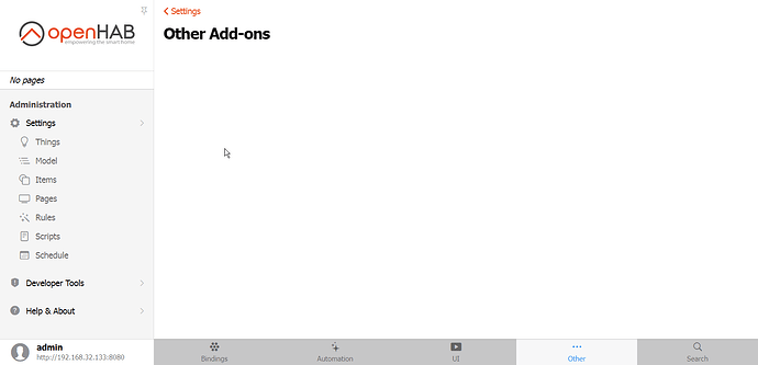

Settings → Other Add-ons → Persistence Services → RRD4j Persistence → Remove
It’s an addon like any other. Go to Settings → Other Addons and click “Remove” next to rrd4j.

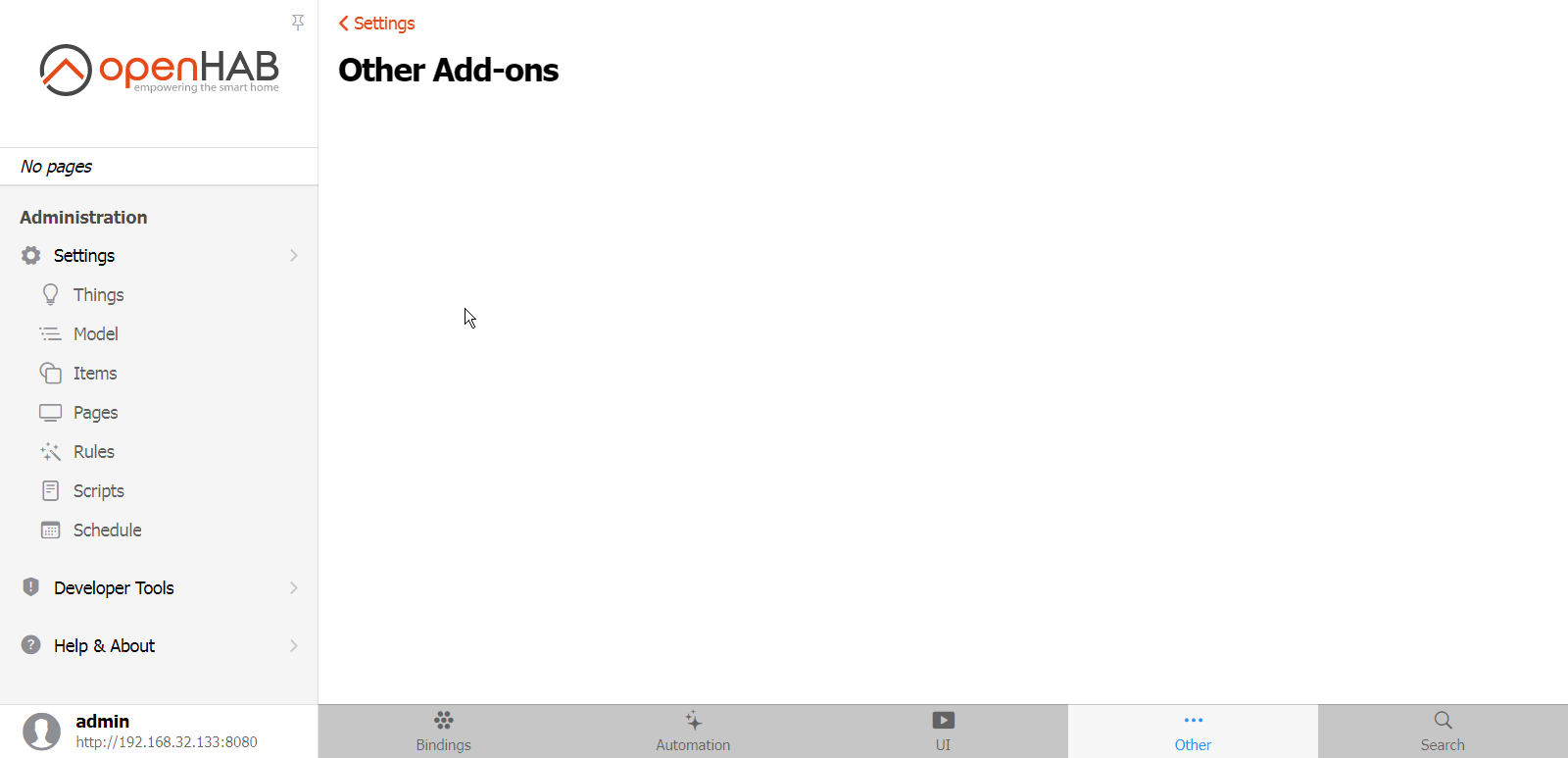

I understand it is nice to have clickable interface, but if the steps should be repeatable it can be problem. Is there any command line option to delete the add-on? Because my screen with other add-ons is empty.
Part bindings contain some items, but for example I know that I have installed exec binding and RegEx transformation and now can not find them any more.
