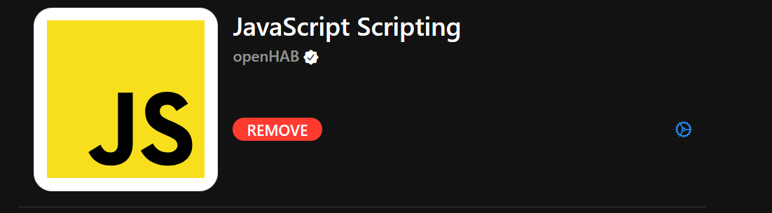

First the basics, the JS Scripting add-on is installed, enabled and active?
Next please show the end-to-end configuration of one of these transformations (e.g. the file or code entered into MainUI, where and how it is applied in a Channel transformation, profile, state description or used in a rule.
Yes, JS ist installed and active. I already reinstalled it but no change.
