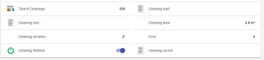

There might be something changed in Roborock S5 max version about last clean summary.
With debug i can see that:
Command added to Queue {"id":3934,"method":"get_clean_summary","params":[]} -> ...
But when the result returns it’s not json and openhab can’t “unpack” it …
2022-02-05 20:19:53.039 [DEBUG] [internal.handler.MiIoAbstractHandler] - Received response for rocky type: CLEAN_SUMMARY_GET, result: [193607,3242590000,204,[1644084330,1644080461,1643910871,1643910588,1643734119,1643733920,1643654195,1643653431,1642944480,1642868801,1642772591,1642339681,1642338785,1642335327,1642335219,1642266702,1642181741,1642181566,1639229381,1639228742]], fullresponse: {"result":[193607,3242590000,204,[1644084330,1644080461,1643910871,1643910588,1643734119,1643733920,1643654195,1643653431,1642944480,1642868801,1642772591,1642339681,1642338785,1642335327,1642335219,1642266702,1642181741,1642181566,1639229381,1639228742]],"id":3992}
Info about environment:
Device: Roborock S5 max (Rocky
Firmware: 3.5.8_1566
Model: roborock.vacuum.s5e
Binding version: 2.5.12 (from bundle:list)
Openhab2 version: 2.5.12
Is there anything i’m missing or that’s “known problem” ?
