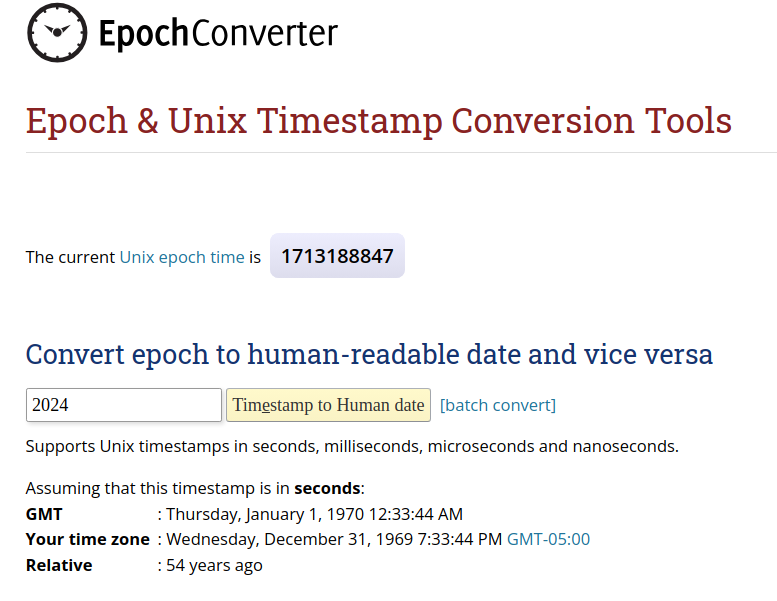

I wanted to pick this issue back up. I think your last change here DID work in that now my Cleaning End got set where previously it was not. The issue is that both my Cleaning Start and Cleaning End are both set to 12/31/1969 @ 7:33:04 PM. This does not change when I run a cleaning cycle as I think it is being (re)set as the same value.
This is a really interesting value BTW. As you know, these dates are set with a unit time stamp.
  • A Unix timestamp of “0” = January 1, 1970 12:00:00 AM
  • However, since I am at GMT-5 Unix timestamp of “0” = December 31, 1969 7:00:00 PM GMT-05:00
  • The Date I am seeing here is December 31, 1969 7:33:44 PM GMT-05:00 which INTERESTINGLY would be a Unix timestamp of “2024”
It seems likely that somehow 2024 is being passed as a Unix timestamp and being converted to 12/31/1969 @ 7:33:44 PM (in my timezone) but 2024 is likley actually the year. Is it possible the CLEAN_RECORD_GET response is somehow being converted from Unixtime 2x?

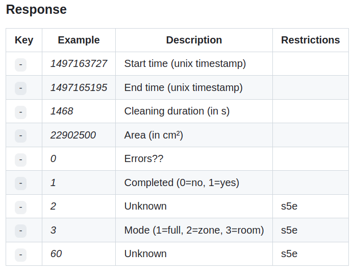

CLEAN_RECORD_GET, result: [[1707313379,1707315083,1704,25887500,0,1,2,1,52]]
With this response
  • Cleaning Start should be 1707313379 and get converted to Wednesday, February 7, 2024 8:42:59 AM GMT-05:00, but it is set to December 31, 1969 7:33:44 PM GMT-05:00
  • Cleaning End should be 1707315083 and get converted to Wednesday, February 7, 2024 9:11:23 AM GMT-05:00, but it is set to December 31, 1969 7:33:44 PM GMT-05:00

I have now upgraded my openHAB from v4.1.3 to v4.2.1. Since then, the times cleaning#last_clean_start_time and cleaning#last_clean_end_time no longer match.
The times are both 01.01.70 01:33:44.
If I look in cleaning#last_clean_record I see the following, which is also the explanation for this date:
{"start":"2024","begin":null,"end":"2024","duration":0,"area":0.77,"clean_time":null,"error":0,"finished":0,"complete":null,"start_type":2,"clean_type":3,"finish_reason":60,"dust_collection_status":null,"map_flag":null}
It seems that start and end are parsed as timestamp?

Received response for device 0F989D8D type: CLEAN_RECORD_GET, result: [[1724174413,1724174459,46,770000,0,0,2,3,60]], fullresponse: {"result":[[1724174413,1724174459,46,770000,0,0,2,3,60]],"id":7028}
