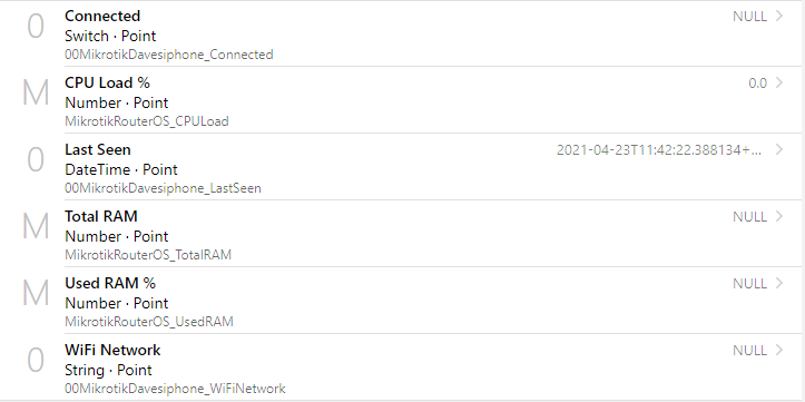

So I just added a HAP AC2 plus a client (my iphone) without specifying the SSID, and a VPN connection.
Dont seem to get any values back on the VPN, iphone not all, HAP AC2 not all..
Set poll to 60 secs, been up for 5 mins now.
Left the things in place, removed and re-added the jar. Channels all got updated. So maybe the scheduled task not fetching all channels. Only cpu and last seen for the iphone seem to be getting updated in the logs
