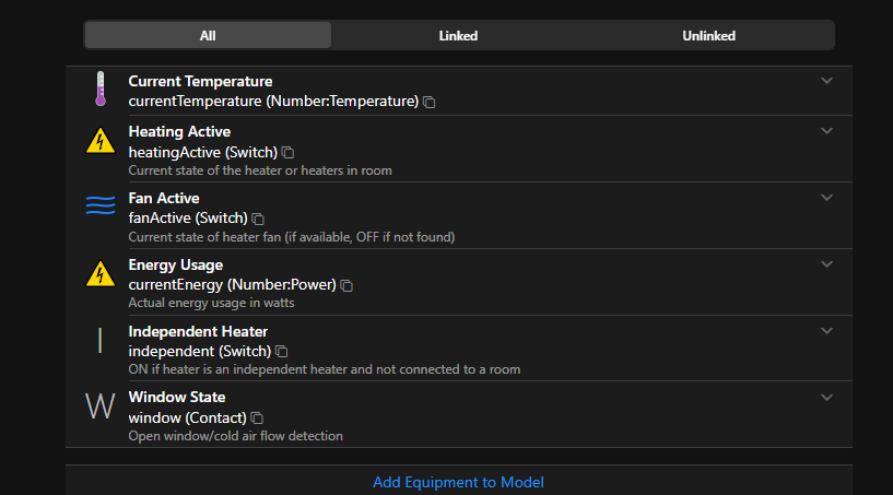

However, when setting up items for the heaters it seems, that two channels are missing in the UI compared to the example in the docs ? - targetTemperature and masterSwitch. Both seem to be very important to actually use the heaters ?

These are the available channels in the UI:
What am I missing ?

What you are missing: Reading the docs: Millheat - Bindings | openHAB :wink:
Have in mind that the Millheat lineup is built very much around a room concept. You add one or more heaters there, and you control it by room temperature, not heater temperature. In order to control the heater directly you must mark it as “independent”.
It is marked as independent- but the channels are still missing?
Are you saying it should work if I create a room for each and control them through the room?
I am controlling them through a room configuration.

I can confirm that it doesnt work; the channels does not come up… I am very happy that you are spending time to investigate.

OK, last resort is then to link the channels manually by using item files as in the example. Pay attention to room vs heater items.
About the panasonic, yes it is the Comfort Cloud version. The binding isn’t ready for testing yet, but thanks for volunteering. I will notify you when I have something running.
Linking through item files does not work either - for the two missing channels; changing the targetTemperature does not work.
