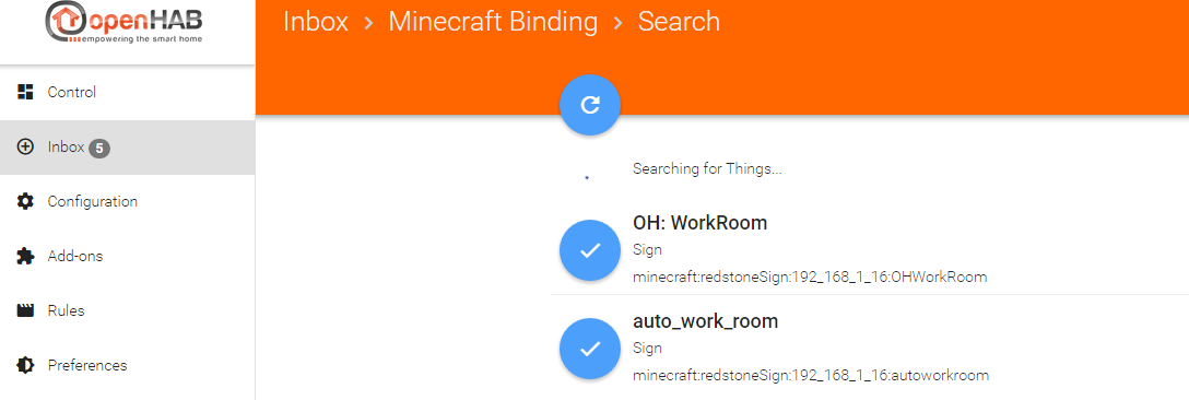

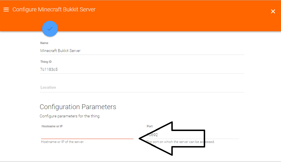

@rlkoshak is correct.
The Server should be auto discovered on the network using Zeroconf.
It is possible to add the server manually as a thing if its not automatically found.
Players and signs with redstone blocks under them will then automatically be discovered when added.
Se attached image.
(Other signs on image bellow)

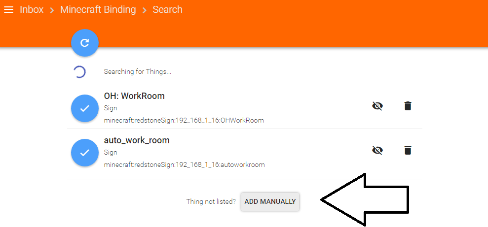

@DanielMalmgren try adding it manually
Doh. Kinda feel stupid now. I’d never even noticed that button. I thought the only alternative if the thing didn’t automatically get up in the inbox was to add it using old-style files. Seems to work nice now that I added it manually :slight_smile:
The only problem now is the log level of the plugin. I have a hard time finding the relevant stuff in the log amongst all those lines…
