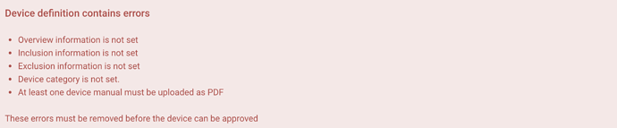

If this is the entry, it has errors & is incomplete. Do you have an electronic copy of the manual?
In the Paper UI, when I go to add ons, the Zwave binding says 2.4.0. Is that the binding version? I found the electronic manual here https://products.z-wavealliance.org/products/3406
And yes, that looks like my entry.
You need to resolve those errors to get the entry reviewed and eventually added to the binding.
Do you feel too overwhelmed by completing this?
I’ve updated it and fixed a couple of things but I don’t know how to resolve the other issues so if someone could help with that, I would appreciate the help!

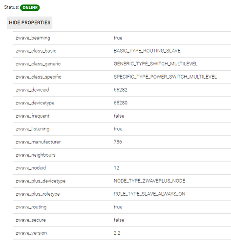

I seem to have the same issue of the device not resolving against the database
Openhab is updated to the latest release 2.5.4 from 2.5.3 does not seem to resolve the issue and the device in known in the database according to:
https://www.cd-jackson.com/index.php/zwave/zwave-device-database/zwave-device-list/devicesummary/1229
Any suggestions regarding how to resolve?

The database entry is not complete, so will not be in the binding.
Yes - fix the errors in the database.
Thanks for the quick repose Chris. Do you need anything from me or do you already have the information needed to solve the problem, not knowing if the below info is helpful.
Ideally, if you can update the database it would really be appreciated. I can update the category as I can see it’s a switch, but I don’t have any oft the other information which is normally in the manual (eg any configuration), and uploading a PDF of the manual (maybe I can find this online).
If you are able to add the information it would really be great - you need to register on the database site and just let me know your username so I can update your access.
