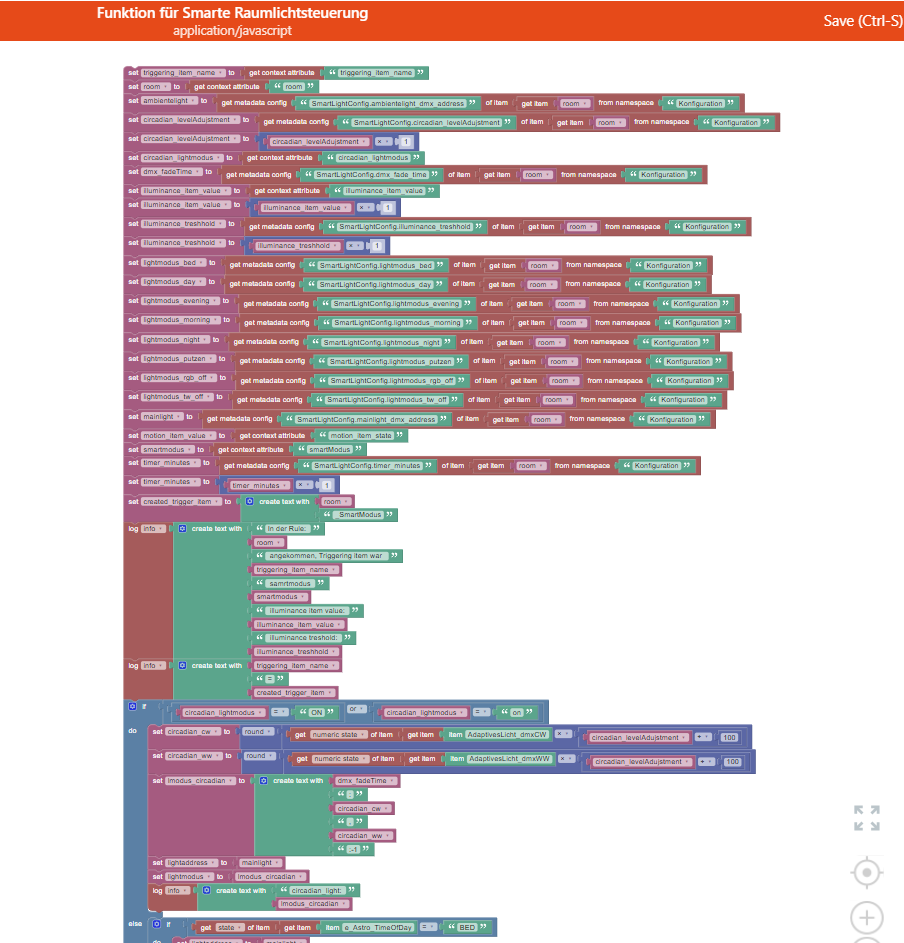

I have a strange behaviour when I call one blockly master script with different (blocky) rules.
My rules are based on the so-called “room mode”, which should trigger different scenarios depending on the room mode (automatic, manual, alarm, …).

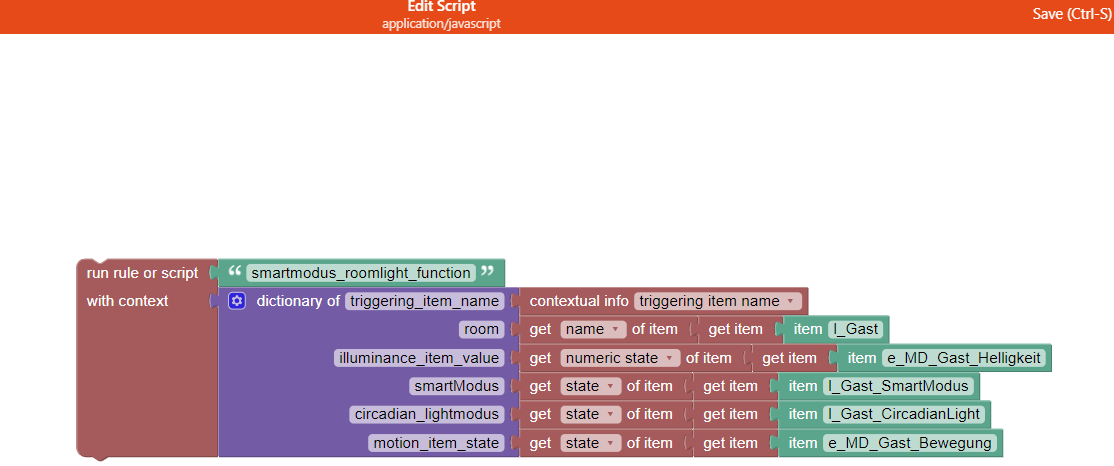

For this I have created rules for the individual rooms, these rules then pass attributes to the same Maststerscript and should trigger the actions with timer there.

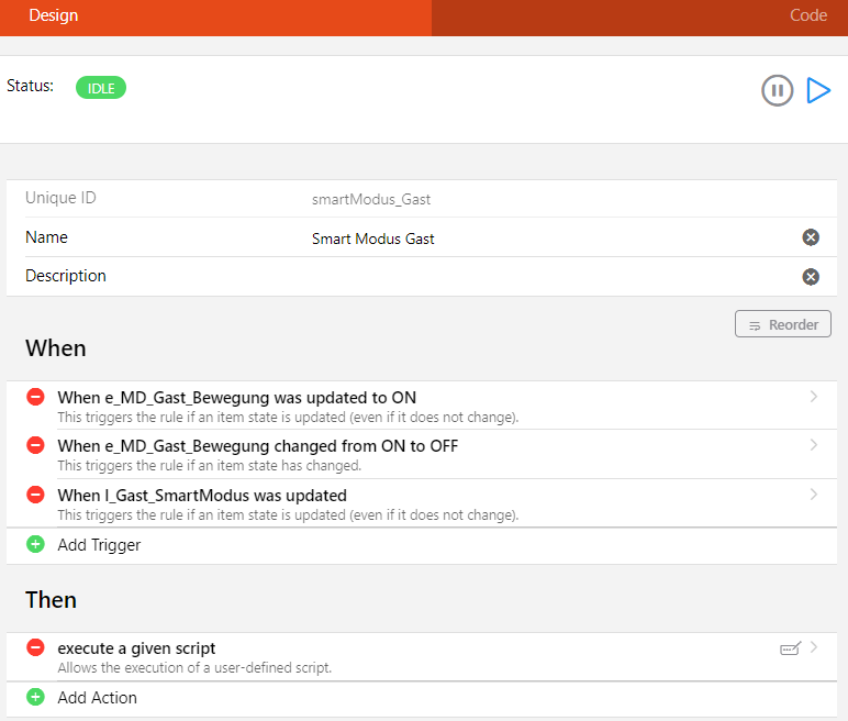

Rules:
are triggering this Master-Script:

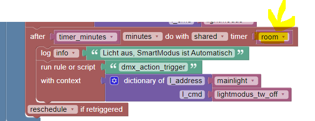

Timer detail:
Unfortunately, something strange happens… Timers with individual names per room that are supposed to affect the triggering individual rooms seem to trigger actions in the other rooms.

Am I not allowed to trigger one script with running timers from different rules - does the timer refer to the clear name (in my case the room name) or the unique id?

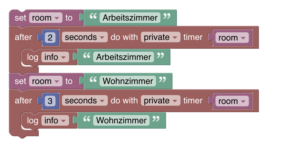

I can’t reproduce the problem with the following simplified idea:
var room;
room = 'Arbeitszimmer';
if (cache.private.exists(room) === false || cache.private.get(room).hasTerminated()) {
  cache.private.put(room, actions.ScriptExecution.createTimer(room, time.ZonedDateTime.now().plusSeconds(2), function () {
    console.info('Arbeitszimmer');
room = 'Wohnzimmer';
  cache.private.put(room, actions.ScriptExecution.createTimer(room, time.ZonedDateTime.now().plusSeconds(3), function () {
    console.info('Wohnzimmer');
results into the expected
2023-12-02 18:00:25.709 [INFO ] [enhab.automation.script.ui.timer_var] - Arbeitszimmer
2023-12-02 18:00:27.082 [INFO ] [enhab.automation.script.ui.timer_var] - Wohnzimmer

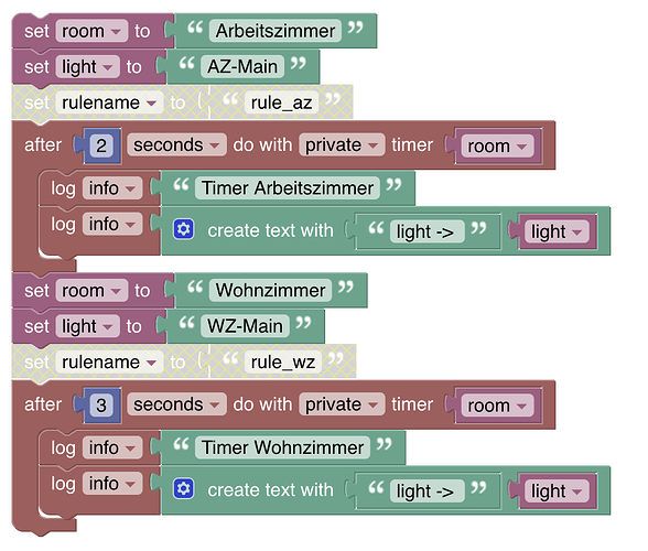

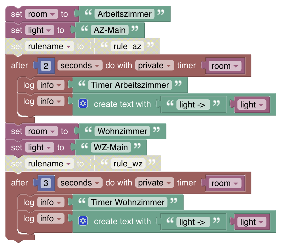

but I can see the problem here:
var room, light, rulename;
light = 'AZ-Main';
    console.info('Timer Arbeitszimmer');
    console.info(('light -> ' + String(light)));
light = 'WZ-Main';
    console.info('Timer Wohnzimmer');
which results into
2023-12-02 18:17:27.495 [INFO ] [enhab.automation.script.ui.timer_var] - Timer Arbeitszimmer
2023-12-02 18:17:27.497 [INFO ] [enhab.automation.script.ui.timer_var] - light -> WZ-Main
2023-12-02 18:17:28.516 [INFO ] [enhab.automation.script.ui.timer_var] - Timer Wohnzimmer
2023-12-02 18:17:28.517 [INFO ] [enhab.automation.script.ui.timer_var] - light -> WZ-Main
Normally I would say that a closure like function() {}would have to be done with function(light) { } where javascript would use the “saved” light-value for the closure.
I am not totally sure what the specified behaviour for this is, ie. where the value is coming from when just using the outer context. It might be specified as the value of the outer context at the time when the closure is run.
maybe Florian can share some light here.
However that’s not the case.
Looking at the Blockly generated code, the timer callback function it is accessing the variable by directly referencing it and reading it from the global context. When the timer expires, the callback function is therefore using the current value of the variable. If it has been mutated meanwhile, the new value will be accessed.
To avoid mutation here, function generators should be used. I could also imagine adding support for passing parameters as supported by setTimeout/setInterval to createTimer.
