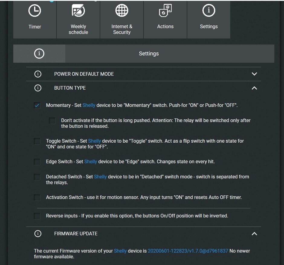

after installing Shelly Binding (v2.5.5) i add my shelly1, which was discovered by paperui, the “Buttom mode” is not available - see pic (Using German language this is “Taste” - third entry)
What can i do top bring it up?
My shelly use frimware 1.7 and is configured to use buttom mode (in my eyes) - see:
Thank you for guiding me forward

Are you having problems with the device not working? Have you tried changing the Button Type in Shelly App to Edge Switch to see if that will work as I think button is just a description and you select the type.

According to your screenshot, the shelly is configured as push-button with momentary state. A connected physical switch should then work as you expect. For switch configuration in openhab you may check state profiles: Items | openHAB
Allternatively as @rossko57 sugested, don’t use channel “Betrieb”, try “Eingang” or “Taste”.
