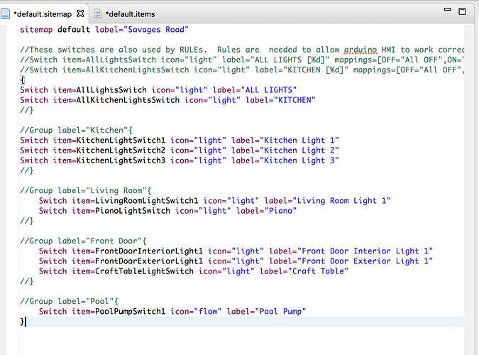

Missing EOF at 'Group' - OH2 upgraded to new version, now default.items not loading
I had a working OH2 installation, then upgraded it to the latest.
Now the sitemap shows errors (does not load).
I’m confident that the syntax has become more restrictive but I cant for the life of me work it out.
can you see anything non-compliant with my code please?
when open in Smart Home Designer
28 PM
DEFAULT.SITEMAP BELOW
sitemap default label="Savages Road"
//These switches are also used by RULEs.  Rules are  needed to allow arduino HMI to work correctly.
//Switch item=AllLightsSwitch icon="light" label="ALL LIGHTS [%d]" mappings=[OFF="All OFF",ON="All ON"]
//Switch item=AllKitchenLightsSwitch icon="light" label="KITCHEN [%d]" mappings=[OFF="All OFF",ON="All ON"]
Switch item=AllLightsSwitch icon="light" label="ALL LIGHTS"
Switch item=AllKitchenLightsSwitch icon="light" label="KITCHEN"
Group label="Kitchen"{
Switch item="KitchenLightSwitch1" icon="light" label="Kitchen Light 1"
Switch item="KitchenLightSwitch2" icon="light" label="Kitchen Light 2"
Switch item="KitchenLightSwitch3" icon="light" label="Kitchen Light 3"
Group label="Living Room"{
    Switch item="LivingRoomLightSwitch1" icon="light" label="Living Room Light 1"
    Switch item="PianoLightSwitch" icon="light" label="Piano"
Group label="Front Door"{
    Switch item="FrontDoorInteriorLight1" icon="light" label="Front Door Interior Light 1"
    Switch item="FrontDoorExteriorLight1" icon="light" label="Front Door Exterior Light 1"
    Switch item="CraftTableLightSwitch" icon="light" label="Craft Table"
Group label="Pool"{
    Switch item="PoolPumpSwitch1" icon="flow" label="Pool Pump"

```**strong text**
Ok, so i’m making some progress.
I have removed all the “Group” labels and the quotes around items= statements.
And the sitemap web page now loads ok.
How do I get my groups back?
37 PM
53 PM
sitemap default label=“Savages Road”
//Switch item=AllLightsSwitch icon=“light” label=“ALL LIGHTS [%d]” mappings=[OFF=“All OFF”,ON=“All ON”]
//Switch item=AllKitchenLightsSwitch icon=“light” label=“KITCHEN [%d]” mappings=[OFF=“All OFF”,ON=“All ON”]
Switch item=AllLightsSwitch icon=“light” label=“ALL LIGHTS”
Switch item=AllKitchenLightsSwitch icon=“light” label=“KITCHEN”
//Group label=“Kitchen”{
Switch item=KitchenLightSwitch1 icon=“light” label=“Kitchen Light 1”
Switch item=KitchenLightSwitch2 icon=“light” label=“Kitchen Light 2”
Switch item=KitchenLightSwitch3 icon=“light” label=“Kitchen Light 3”

This Topic is awful to read! Sorry but you need to keep information rather short. Only the important parts.
Referring to my Post
Group {
Is now WRONG
https://github.com/openhab/openhab-docs/commit/b8dc13d6adb95d8a281a9b826136a4314b140be3
Now it has to be
Text {
Just replace Group with Text and check the result.
Example of a valid *.sitemap
sitemap dev label="Dev Sitemap" {
    Frame label="Main Frame" {
        Text label="Nesting for items" {
            Text item=Dev01 label="Placeholder for later use"
Thanks BrutalBirdie, your frank response is welcomed. I used the provided text formatting and it’s certainly very sparse in its layout. I note other posts complain they do not have the full file/extract to review so I added everything to provide the best level of info. I’ll redact in future :slight_smile:
I’ll implement tomorrow, test, and report back.

Thanks Rlkoshak,
I resolved the MQTT issues (commands not firing after upgrade by uninstalling the OH2 MQTT addon, and reinstalling. Automagically all was good in the world again. Thanks for your contribution.
Your advice was correct. I copied my sitemap to a temp location. Deleted all content from old OH2 sitemap, and used the structure you provided and moved my switches line by line into the new format. Worked perfectly!
I’ll post my final config and screenshot when back at my laptop (responding on phone).
