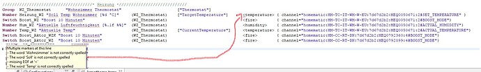

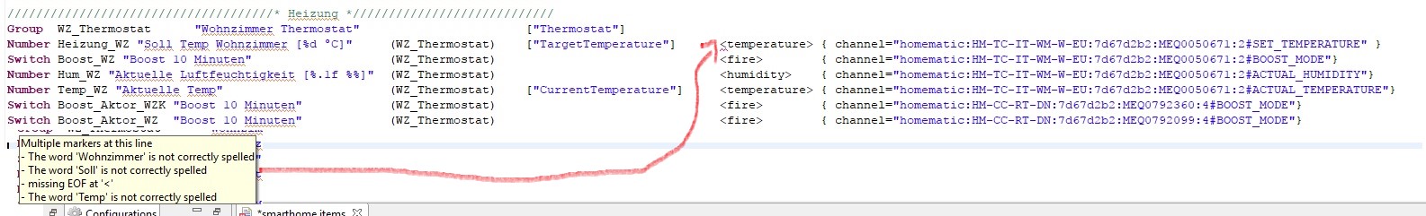

I tried to create a group - but im running into trouble and can´t figure out what i´m doing wrong :frowning: Here
s my code for the Items
Group WZ_Thermostat "Wohnzimmer Thermostat" ["Thermostat"]
Number Heizung_WZ "Soll Temp Wohnzimmer [%d °C]" (WZ_Thermostat) ["TargetTemperature"] <temperature> { channel="homematic:HM-TC-IT-WM-W-EU:7d67d2b2:MEQ0050671:2#SET_TEMPERATURE" }
Switch Boost_WZ "Boost 10 Minuten" (WZ_Thermostat) <fire> { channel="homematic:HM-TC-IT-WM-W-EU:7d67d2b2:MEQ0050671:2#BOOST_MODE"}
Number Hum_WZ "Aktuelle Luftfeuchtigkeit [%.1f %%]" (WZ_Thermostat) <humidity> { channel="homematic:HM-TC-IT-WM-W-EU:7d67d2b2:MEQ0050671:2#ACTUAL_HUMIDITY"}
Number Temp_WZ "Aktuelle Temp" (WZ_Thermostat) ["CurrentTemperature"] <temperature> { channel="homematic:HM-TC-IT-WM-W-EU:7d67d2b2:MEQ0050671:2#ACTUAL_TEMPERATURE"}
Switch Boost_Aktor_WZK "Boost 10 Minuten" (WZ_Thermostat) <fire> { channel="homematic:HM-CC-RT-DN:7d67d2b2:MEQ0792360:4#BOOST_MODE"}
Switch Boost_Aktor_WZ "Boost 10 Minuten" (WZ_Thermostat) <fire> { channel="homematic:HM-CC-RT-DN:7d67d2b2:MEQ0792099:4#BOOST_MODE"}
I also added a Screen from HomeDesigner…can someone pls help ?
