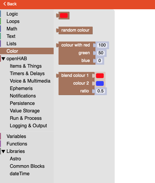

I try to use the blockly scripts, by define colors and send them to the hue bulbs. Problem is, that colors are HEX values and I need separated RGB values. Online I found a „hsb of“ block in the documentation. But the block is not exists in my env?! Can someone send me a hint why I don‘t found the block?

For me it’s in the Color section within Blockly, but I am on 3.3.0.M2.
Hmm… the block is missing in my system. Anyone a idea why?
Perhaps it wasn’t added until later versions…
@hafniumzinc Good point. But the documentation of this block is already in Version 3.2.0.
I’m pretty sure the documentation is ahead of the “stable” release in this instance. For example the inline code block also only appears in the 3.3 milestones and snapshots…
Ok. Thank you. I found this function here Extending Blockly with new openHAB commands - #250 by ysc and create a own block Lib (with this tutorial: Tutorial: How To Write Block Libraries ) that backport the block for me:
