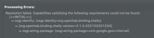

Sometimes Resolve brings up

It’s probably due to the Gson upgrade. The new bundle no longer exports the com.google.gson.internal package. That package is considered internal, i.e. not part of the API so it should never have been exported by the bundle or used by any add-on. The classes in this package can have breaking changes with any release.
I removed the import com.google.gson.internal.Primitives; in ShellyUtils in:
So maybe it helps to use (or rebase on) the current main branch?
fixed👍
