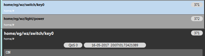

    I push the Switch “Taste 1” and a mqtt telegram goes out
    … the telegram comes in - goes through the rule and a new telegram goes out
    The time between both telegram is 6 seconds. That is too much.

a screenshot from startscreen:
