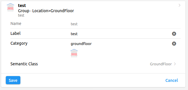

I tried to do a very simple test:
First I created a location in the model:

The result was this:
grafik
After restarting openhab it looks like this:

Interesting test, similar effect I had:
I assume the order is:
  1. Group is created when you define a location in the model
  2. You add an item, it gets assigned to the group
  3. When you restart OH3, it first loads your item files. Somehow, it sees a group called “test” and creates it (even though you didn’t specify it?).
  4. The group created through the model is not loaded properly as location, thus the model is mixed up.
In my case, the group / location created in the model wasn’t even displayed anymore after a restart.
Not sure if that’s the right interpretation. Anyway: I guess it’s safe to say that you really shouldn’t define the same groups in the item files and in your model :smile:
