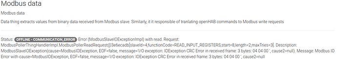

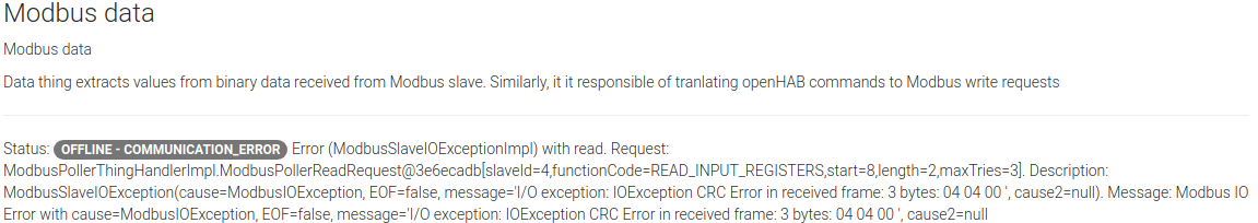

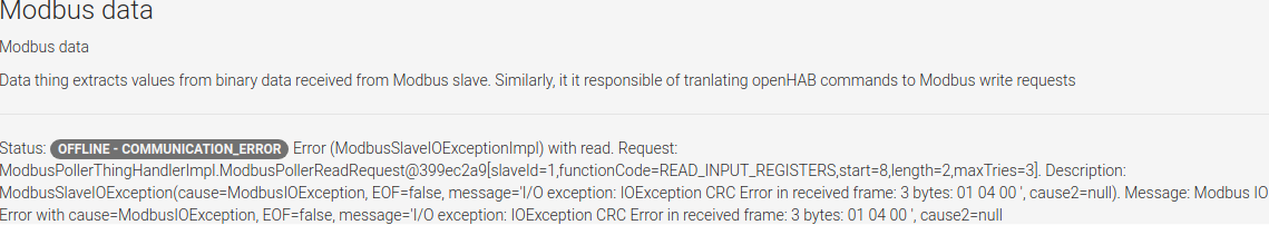

As of now,I am trying to read and displaying status of smoke Detector and Manual call point.
Error:
2019-03-06 20:54:00.740 [thome.event.ItemStateEvent] - ManualSwitch updated to 1
2019-03-06 20:54:02.440 [event.ThingStatusInfoEvent] - 'modbus:data:slave02:smokeDetector:smokeDetector1' updated: ONLINE
2019-03-06 20:54:02.440 [thome.event.ItemStateEvent] - Received event of type 'ItemStateEvent' under the topic 'smarthome/items/SmokeDetector/state' with payload: '{"type":"Decimal","value":"131073"}'
2019-03-06 20:54:02.441 [thome.event.ItemStateEvent] - SmokeDetector updated to 131073
2019-03-06 20:54:02.500 [event.ThingStatusInfoEvent] - 'modbus:data:slave01:inputControlModule:input1' updated: ONLINE
2019-03-06 20:54:02.500 [thome.event.ItemStateEvent] - Received event of type 'ItemStateEvent' under the topic 'smarthome/items/ManualSwitch/state' with payload: '{"type":"Decimal","value":"1"}'
2019-03-06 20:54:02.500 [thome.event.ItemStateEvent] - ManualSwitch updated to 1

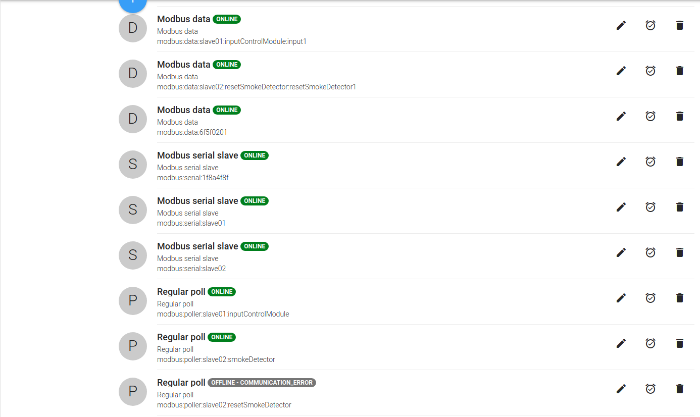

2019-03-06 20:54:04.139 [event.ThingStatusInfoEvent] - 'modbus:poller:slave02:resetSmokeDetector' updated: OFFLINE (COMMUNICATION_ERROR): Error with read: org.openhab.io.transport.modbus.internal.ModbusSlaveIOExceptionImpl: Modbus IO Error with cause=ModbusIOException, EOF=false, message='I/O exception: IOException Error reading response (EOF)', cause2=null
2019-03-06 20:54:04.199 [event.ThingStatusInfoEvent] - 'modbus:data:slave02:smokeDetector:smokeDetector1' updated: ONLINE
2019-03-06 20:54:04.199 [thome.event.ItemStateEvent] - Received event of type 'ItemStateEvent' under the topic 'smarthome/items/SmokeDetector/state' with payload: '{"type":"Decimal","value":"131073"}'
SmokeDetector and ManualSwitch Items appear to be being read from Modbus successfully.
That leaves resetSmokeDetector1 data thing, for which you haven’t an Item yet.
You seem to be configuring that as a write-only Item, that’s fine.

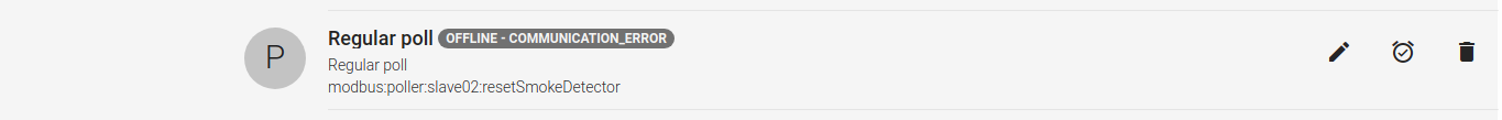

But note that the resetSmokeDetector poller is still configured to read-poll two coils.
Maybe your mystery slave device doesn’t allow reading of write-only coils??
You can disable read polling by setting poller thing refresh=0.

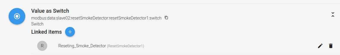

Still I am seeing below issue openHAB GUI,
I have linked resetSmokeDetector1 to Modbus data like this,

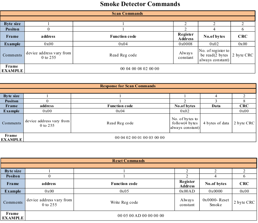

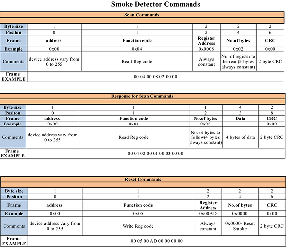

My objective:
Before the smoke is detected, register will have this value 02 04 04 00 02 00 00 69 44
When smoke is detected, register will have this value 02 04 04 00 02 00 01 69 44
Afer smoke is detected, I will reset the register like this 02 05 00 AD 00 01 9D D8
After reseting , response will be like this 02 05 00 AD 00 01 9D D8 (I am expecting)
NOTE: As of now, I am using button to manually trigger the smoke event.

The data thing is all about “matching/linking” Modbus registers with openHAB Items.
The poller thing controls the reading. (if any)
This makes sense, as you may have mixed read-only, read/write, and write-only data things associated with one poller.
I would expect your non-polling poller thing to stay OFFLINE. If it can’t read it, it has no way to know if it’s online.
This won’t stop you writing to it.
It’s going to help you if you convert that to something meaningful, like “read input register from slave 2”
If those are bits of a register, the binding does provide the means to look at bits individually rather than treat it as a big number.
If you reveal what your secret device is, or its manual, it could help?

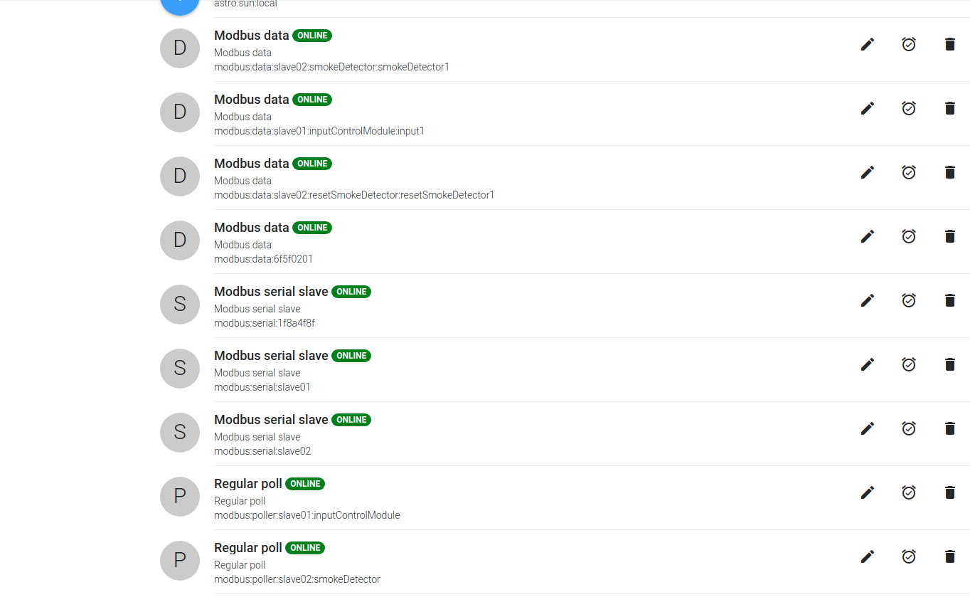

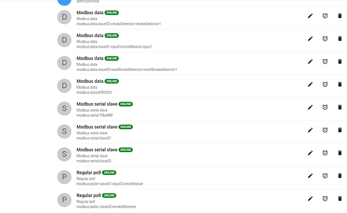

I don’t know the expected behaviour for OpenHAB Modbus. I am reading other issue and understanding openHAB Modbus. Thanks for explanation.
Now, I am getting expected result from OpenHAB Modbus. After making my thing like this
//Reset the SmokeDetector at register 0xAD
    Bridge poller resetSmokeDetector [ start=173, length=2, refresh=0,type="coil"]
        Thing data resetSmokeDetector1[writeTransform="01",writeStart="173",writeValueType="bit",writeType="coil"]
It is working. Please correct me, If I am wrong.

When I started to work in actual HW, I am getting “CRC Error” and “EOF Error”.
Previously, I was working in simulator HW where Modbus is working properly and able to access devices.
Now, I am working in actual HW and getting error. I have read and implemented other’s solutions. But it is not fixing my issue. Below, I have provided the details,
        Thing data resetSmokeDetector01[writeTransform="01",writeStart="173",writeValueType="bit",writeType="coil"]

5:19:09.518 [ERROR] [et.wimpi.modbus.io.ModbusRTUTransport] - Last request: 04 04 00 08 00 02 f0 5c
15:19:09.518 [ERROR] [et.wimpi.modbus.io.ModbusRTUTransport] - failed to read: CRC Error in received frame: 3 bytes: 04 04 00
15:19:09.518 [ERROR] [mpi.modbus.io.ModbusSerialTransaction] - execute try 1/1 error: I/O exception: IOException CRC Error in received frame: 3 bytes: 04 04 00 . Request: net.wimpi.modbus.msg.ReadInputRegistersRequest@24d94233 (unit id 4 & transaction 7396). Serial parameters: SerialParameters@29f6f91c[portName=/dev/ttyACM0,baudRate=9600,flowControlIn=none,flowControlOut=none,databits=8,stopbits=1,parity=none,encoding=rtu,echo=false,receiveTimeoutMillis=1500]

15:19:10.510 [DEBUG] [et.wimpi.modbus.io.ModbusRTUTransport] - Sent: 20 04 00 08 00 02 f6 b8
15:19:10.523 [TRACE] [et.wimpi.modbus.io.ModbusRTUTransport] - Managed to read at least one byte
15:19:10.527 [DEBUG] [et.wimpi.modbus.io.ModbusRTUTransport] - Response: 20 04 00 02 00
15:19:10.528 [ERROR] [et.wimpi.modbus.io.ModbusRTUTransport] - Last request: 20 04 00 08 00 02 f6 b8
15:19:10.528 [ERROR] [et.wimpi.modbus.io.ModbusRTUTransport] - failed to read: CRC Error in received frame: 3 bytes: 20 04 00
15:19:10.528 [ERROR] [mpi.modbus.io.ModbusSerialTransaction] - execute try 1/1 error: I/O exception: IOException CRC Error in received frame: 3 bytes: 20 04 00 . Request: net.wimpi.modbus.msg.ReadInputRegistersRequest@6af5510c (unit id 32 & transaction 7397). Serial parameters: SerialParameters@18a3aaba[portName=/dev/ttyACM0,baudRate=9600,flowControlIn=none,flowControlOut=none,databits=8,stopbits=1,parity=none,encoding=rtu,echo=false,receiveTimeoutMillis=1500]
15:19:10.528 [ERROR] [mpi.modbus.io.ModbusSerialTransaction] - execute reached max tries 1, throwing last error: I/O exception: IOException CRC Error in received frame: 3 bytes: 20 04 00 . Request: net.wimpi.modbus.msg.ReadInputRegistersRequest@6af5510c (unit id 32 & transaction 7397). Serial parameters: SerialParameters@18a3aaba[portName=/dev/ttyACM0,baudRate=9600,flowControlIn=none,flowControlOut=none,databits=8,stopbits=1,parity=none,encoding=rtu,echo=false,receiveTimeoutMillis=1500]

15:19:13.169 [DEBUG] [et.wimpi.modbus.io.ModbusRTUTransport] - Sent: 80 04 00 08 00 02 ee 18
15:19:13.183 [TRACE] [et.wimpi.modbus.io.ModbusRTUTransport] - Managed to read at least one byte
15:19:13.187 [DEBUG] [et.wimpi.modbus.io.ModbusRTUTransport] - Response: 80 04 00 02 00
15:19:13.188 [ERROR] [et.wimpi.modbus.io.ModbusRTUTransport] - Last request: 80 04 00 08 00 02 ee 18
15:19:13.188 [ERROR] [et.wimpi.modbus.io.ModbusRTUTransport] - failed to read: CRC Error in received frame: 3 bytes: 80 04 00
15:19:13.189 [ERROR] [mpi.modbus.io.ModbusSerialTransaction] - execute try 1/1 error: I/O exception: IOException CRC Error in received frame: 3 bytes: 80 04 00 . Request: net.wimpi.modbus.msg.ReadInputRegistersRequest@3fe0ed76 (unit id 128 & transaction 7399). Serial parameters: SerialParameters@61fc8efc[portName=/dev/ttyACM0,baudRate=9600,flowControlIn=none,flowControlOut=none,databits=8,stopbits=1,parity=none,encoding=rtu,echo=false,receiveTimeoutMillis=1500]
15:19:13.189 [ERROR] [mpi.modbus.io.ModbusSerialTransaction] - execute reached max tries 1, throwing last error: I/O exception: IOException CRC Error in received frame: 3 bytes: 80 04 00 . Request: net.wimpi.modbus.msg.ReadInputRegistersRequest@3fe0ed76 (unit id 128 & transaction 7399). Serial parameters: SerialParameters@61fc8efc[portName=/dev/ttyACM0,baudRate=9600,flowControlIn=none,flowControlOut=none,databits=8,stopbits=1,parity=none,encoding=rtu,echo=false,receiveTimeoutMillis=1500]

15:19:14.148 [TRACE] [ort.modbus.internal.ModbusManagerImpl] - Try 3 out of 3 [operation ID 452bab5e-5eff-49aa-872e-7add789af404]
15:19:14.148 [TRACE] [ort.modbus.internal.ModbusManagerImpl] - Ensuring that enough time passes before retrying again. Sleeping if necessary [operation ID 452bab5e-5eff-49aa-872e-7add789af404]
15:19:14.149 [TRACE] [ort.modbus.internal.ModbusManagerImpl] - Sleep ended, slept 0 [operation ID 452bab5e-5eff-49aa-872e-7add789af404]
15:19:14.153 [TRACE] [ort.modbus.internal.ModbusManagerImpl] - Going execute transaction with request request (FC=READ_INPUT_REGISTERS): 00 00 00 00 00 06 40 04 00 08 00 02  [operation ID 452bab5e-5eff-49aa-872e-7add789af404]
15:19:14.154 [DEBUG] [et.wimpi.modbus.io.ModbusRTUTransport] - Sent: 40 04 00 08 00 02 ff 18
15:19:14.173 [TRACE] [et.wimpi.modbus.io.ModbusRTUTransport] - Managed to read at least one byte
15:19:14.178 [DEBUG] [et.wimpi.modbus.io.ModbusRTUTransport] - Response: 40 04 00 02 00
15:19:14.180 [ERROR] [et.wimpi.modbus.io.ModbusRTUTransport] - Last request: 40 04 00 08 00 02 ff 18
15:19:14.182 [ERROR] [et.wimpi.modbus.io.ModbusRTUTransport] - failed to read: CRC Error in received frame: 3 bytes: 40 04 00
15:19:14.184 [ERROR] [mpi.modbus.io.ModbusSerialTransaction] - execute try 1/1 error: I/O exception: IOException CRC Error in received frame: 3 bytes: 40 04 00 . Request: net.wimpi.modbus.msg.ReadInputRegistersRequest@cdc247e (unit id 64 & transaction 7400). Serial parameters: SerialParameters@22ec164a[portName=/dev/ttyACM0,baudRate=9600,flowControlIn=none,flowControlOut=none,databits=8,stopbits=1,parity=none,encoding=rtu,echo=false,receiveTimeoutMillis=1500]
15:19:14.185 [ERROR] [mpi.modbus.io.ModbusSerialTransaction] - execute reached max tries 1, throwing last error: I/O exception: IOException CRC Error in received frame: 3 bytes: 40 04 00 . Request: net.wimpi.modbus.msg.ReadInputRegistersRequest@cdc247e (unit id 64 & transaction 7400). Serial parameters: SerialParameters@22ec164a[portName=/dev/ttyACM0,baudRate=9600,flowControlIn=none,flowControlOut=none,databits=8,stopbits=1,parity=none,encoding=rtu,echo=false,receiveTimeoutMillis=1500]
15:19:14.185 [ERROR] [ort.modbus.internal.ModbusManagerImpl] - Last try 3 failed when executing request (ModbusPollerThingHandlerImpl.ModbusPollerReadRequest@c19d0d4[slaveId=64,functionCode=READ_INPUT_REGISTERS,start=8,length=2,maxTries=3]). Aborting. Error was I/O error, so reseting the connection. Error details: net.wimpi.modbus.ModbusIOException I/O exception: IOException CRC Error in received frame: 3 bytes: 40 04 00  [operation ID 452bab5e-5eff-49aa-872e-7add789af404]
15:19:14.185 [TRACE] [ling.ModbusSlaveConnectionFactoryImpl] - destroyObject for connection SerialConnection@3d75375e[portName=/dev/ttyACM0,port=/dev/ttyACM0] and endpoint ModbusSerialSlaveEndpoint@17072183[portName=/dev/ttyACM0] -> closing the connection
15:19:14.215 [TRACE] [ling.ModbusSlaveConnectionFactoryImpl] - Created connection SerialConnection@18e7b414[portName=/dev/ttyACM0,port=<null>] for endpoint ModbusSerialSlaveEndpoint@17072183[portName=/dev/ttyACM0]
15:19:14.217 [TRACE] [ling.ModbusSlaveConnectionFactoryImpl] - Passivating connection SerialConnection@18e7b414[portName=/dev/ttyACM0,port=<null>] for endpoint ModbusSerialSlaveEndpoint@17072183[portName=/dev/ttyACM0]...
15:19:14.218 [TRACE] [ling.ModbusSlaveConnectionFactoryImpl] - (passivate) Connection SerialConnection@18e7b414[portName=/dev/ttyACM0,port=<null>] (endpoint ModbusSerialSlaveEndpoint@17072183[portName=/dev/ttyACM0]) age (1554112154218ms) is below the reconnectAfterMillis (-1ms) limit and connection time (0) is after the "disconnectBeforeConnectedMillis"=-1. Keep the connection open.
15:19:14.220 [TRACE] [ling.ModbusSlaveConnectionFactoryImpl] - ...Passivated connection SerialConnection@18e7b414[portName=/dev/ttyACM0,port=<null>] for endpoint ModbusSerialSlaveEndpoint@17072183[portName=/dev/ttyACM0]
15:19:14.221 [TRACE] [ort.modbus.internal.ModbusManagerImpl] - invalidating connection for endpoint ModbusSerialSlaveEndpoint@17072183[portName=/dev/ttyACM0] took 36 ms
15:19:14.221 [TRACE] [ort.modbus.internal.ModbusManagerImpl] - Calling write response callback org.openhab.binding.modbus.internal.handler.ModbusPollerThingHandlerImpl$ReadCallbackDelegator@329aace8 for request ModbusPollerThingHandlerImpl.ModbusPollerReadRequest@c19d0d4[slaveId=64,functionCode=READ_INPUT_REGISTERS,start=8,length=2,maxTries=3]. Error was org.openhab.io.transport.modbus.internal.ModbusSlaveIOExceptionImpl Modbus IO Error with cause=ModbusIOException, EOF=false, message='I/O exception: IOException CRC Error in received frame: 3 bytes: 40 04 00 ', cause2=null
15:19:14.222 [TRACE] [ort.modbus.internal.ModbusManagerImpl] - Called write response callback org.openhab.binding.modbus.internal.handler.ModbusPollerThingHandlerImpl$ReadCallbackDelegator@329aace8 for request ModbusPollerThingHandlerImpl.ModbusPollerReadRequest@c19d0d4[slaveId=64,functionCode=READ_INPUT_REGISTERS,start=8,length=2,maxTries=3]. Error was org.openhab.io.transport.modbus.internal.ModbusSlaveIOExceptionImpl Modbus IO Error with cause=ModbusIOException, EOF=false, message='I/O exception: IOException CRC Error in received frame: 3 bytes: 40 04 00 ', cause2=null
15:19:14.222 [TRACE] [ort.modbus.internal.ModbusManagerImpl] - returning connection for endpoint ModbusSerialSlaveEndpoint@17072183[portName=/dev/ttyACM0] took 0 ms
15:19:14.222 [TRACE] [ort.modbus.internal.ModbusManagerImpl] - Connection was returned to the pool, ending operation [operation ID 452bab5e-5eff-49aa-872e-7add789af404]
15:19:14.223 [DEBUG] [ort.modbus.internal.ModbusManagerImpl] - Modbus operation ended, timing info: {total: 16929 ms, connection: 16844, transaction=74, callback=1} [operation ID 452bab5e-5eff-49aa-872e-7add789af404]
15:19:14.223 [DEBUG] [ort.modbus.internal.ModbusManagerImpl] - Execution of scheduled (1000ms) poll task BasicPollTaskImpl@6f9a43ba[request=ModbusPollerThingHandlerImpl.ModbusPollerReadRequest@c19d0d4[slaveId=64,functionCode=READ_INPUT_REGISTERS,start=8,length=2,maxTries=3],endpoint=ModbusSerialSlaveEndpoint@17072183[portName=/dev/ttyACM0],callback=org.openhab.binding.modbus.internal.handler.ModbusPollerThingHandlerImpl$ReadCallbackDelegator@329aace8] finished at 1554112154223. Was started at millis: 1554112137294 (=duration of 16929 millis)
15:19:14.223 [DEBUG] [ort.modbus.internal.ModbusManagerImpl] - Executing scheduled (1000ms) poll task BasicPollTaskImpl@7b24be69[request=ModbusPollerThingHandlerImpl.ModbusPollerReadRequest@399ec2a9[slaveId=1,functionCode=READ_INPUT_REGISTERS,start=8,length=2,maxTries=3],endpoint=ModbusSerialSlaveEndpoint@38c4b77[portName=/dev/ttyACM0],callback=org.openhab.binding.modbus.internal.handler.ModbusPollerThingHandlerImpl$ReadCallbackDelegator@329a9e03]. Current millis: 1554112154223
15:19:14.223 [INFO ] [smarthome.event.ThingStatusInfoEvent ] - 'modbus:data:slave0x40:smokeDetector:smokeDetector02' updated: OFFLINE (COMMUNICATION_ERROR): Error (ModbusSlaveIOExceptionImpl) with read. Request: ModbusPollerThingHandlerImpl.ModbusPollerReadRequest@c19d0d4[slaveId=64,functionCode=READ_INPUT_REGISTERS,start=8,length=2,maxTries=3]. Description: ModbusSlaveIOException(cause=ModbusIOException, EOF=false, message='I/O exception: IOException CRC Error in received frame: 3 bytes: 40 04 00 ', cause2=null). Message: Modbus IO Error with cause=ModbusIOException, EOF=false, message='I/O exception: IOException CRC Error in received frame: 3 bytes: 40 04 00 ', cause2=null
15:19:14.224 [TRACE] [nternal.ModbusManagerImpl.PollMonitor] - <POLL MONITOR>
15:19:14.224 [INFO ] [smarthome.event.ThingStatusInfoEvent ] - 'modbus:poller:slave0x40:smokeDetector' updated: OFFLINE (COMMUNICATION_ERROR): Error with read: org.openhab.io.transport.modbus.internal.ModbusSlaveIOExceptionImpl: Modbus IO Error with cause=ModbusIOException, EOF=false, message='I/O exception: IOException CRC Error in received frame: 3 bytes: 40 04 00 ', cause2=null
15:19:14.224 [TRACE] [nternal.ModbusManagerImpl.PollMonitor] - POLL MONITOR: scheduled poll task. FC: READ_INPUT_REGISTERS, start 8, length 2, done: false, canceled: false, delay: -14933. Full task BasicPollTaskImpl@5d411317[request=ModbusPollerThingHandlerImpl.ModbusPollerReadRequest@607b1c96[slaveId=32,functionCode=READ_INPUT_REGISTERS,start=8,length=2,maxTries=3],endpoint=ModbusSerialSlaveEndpoint@22a6ff3d[portName=/dev/ttyACM0],callback=org.openhab.binding.modbus.internal.handler.ModbusPollerThingHandlerImpl$ReadCallbackDelegator@329aa566]
15:19:14.226 [TRACE] [nternal.ModbusManagerImpl.PollMonitor] - POLL MONITOR: scheduled poll task. FC: READ_INPUT_REGISTERS, start 8, length 2, done: false, canceled: false, delay: 997. Full task BasicPollTaskImpl@6f9a43ba[request=ModbusPollerThingHandlerImpl.ModbusPollerReadRequest@c19d0d4[slaveId=64,functionCode=READ_INPUT_REGISTERS,start=8,length=2,maxTries=3],endpoint=ModbusSerialSlaveEndpoint@17072183[portName=/dev/ttyACM0],callback=org.openhab.binding.modbus.internal.handler.ModbusPollerThingHandlerImpl$ReadCallbackDelegator@329aace8]
15:19:14.227 [TRACE] [nternal.ModbusManagerImpl.PollMonitor] - POLL MONITOR: scheduled poll task. FC: READ_MULTIPLE_REGISTERS, start 172, length 2, done: false, canceled: false, delay: -12388. Full task BasicPollTaskImpl@405e49bd[request=ModbusPollerThingHandlerImpl.ModbusPollerReadRequest@65e2d032[slaveId=16,functionCode=READ_MULTIPLE_REGISTERS,start=172,length=2,maxTries=3],endpoint=ModbusSerialSlaveEndpoint@27d60e81[portName=/dev/ttyACM0],callback=org.openhab.binding.modbus.internal.handler.ModbusPollerThingHandlerImpl$ReadCallbackDelegator@49307ecd]
15:19:14.227 [TRACE] [nternal.ModbusManagerImpl.PollMonitor] - POLL MONITOR: scheduled poll task. FC: READ_INPUT_REGISTERS, start 8, length 2, done: false, canceled: false, delay: -16633. Full task BasicPollTaskImpl@3a515949[request=ModbusPollerThingHandlerImpl.ModbusPollerReadRequest@3e6ecadb[slaveId=4,functionCode=READ_INPUT_REGISTERS,start=8,length=2,maxTries=3],endpoint=ModbusSerialSlaveEndpoint@7b6c5372[portName=/dev/ttyACM0],callback=org.openhab.binding.modbus.internal.handler.ModbusPollerThingHandlerImpl$ReadCallbackDelegator@818e012]
15:19:14.227 [TRACE] [nternal.ModbusManagerImpl.PollMonitor] - POLL MONITOR: scheduled poll task. FC: READ_INPUT_REGISTERS, start 8, length 2, done: false, canceled: false, delay: -12293. Full task BasicPollTaskImpl@3d3f7eaa[request=ModbusPollerThingHandlerImpl.ModbusPollerReadRequest@69880c34[slaveId=128,functionCode=READ_INPUT_REGISTERS,start=8,length=2,maxTries=3],endpoint=ModbusSerialSlaveEndpoint@501d49b1[portName=/dev/ttyACM0],callback=org.openhab.binding.modbus.internal.handler.ModbusPollerThingHandlerImpl$ReadCallbackDelegator@329abbec]
15:19:14.228 [TRACE] [nternal.ModbusManagerImpl.PollMonitor] - POLL MONITOR: scheduled poll task. FC: READ_INPUT_REGISTERS, start 8, length 2, done: false, canceled: false, delay: -11315. Full task BasicPollTaskImpl@7b24be69[request=ModbusPollerThingHandlerImpl.ModbusPollerReadRequest@399ec2a9[slaveId=1,functionCode=READ_INPUT_REGISTERS,start=8,length=2,maxTries=3],endpoint=ModbusSerialSlaveEndpoint@38c4b77[portName=/dev/ttyACM0],callback=org.openhab.binding.modbus.internal.handler.ModbusPollerThingHandlerImpl$ReadCallbackDelegator@329a9e03]
15:19:14.228 [TRACE] [nternal.ModbusManagerImpl.PollMonitor] - POLL MONITOR: scheduledThreadPoolExecutor queue size: 2, remaining space 2147483647. Active threads 5
15:19:14.228 [TRACE] [nternal.ModbusManagerImpl.PollMonitor] - </POLL MONITOR>
15:19:14.228 [TRACE] [ort.modbus.internal.ModbusManagerImpl] - Starting new operation with task BasicPollTaskImpl@7b24be69[request=ModbusPollerThingHandlerImpl.ModbusPollerReadRequest@399ec2a9[slaveId=1,functionCode=READ_INPUT_REGISTERS,start=8,length=2,maxTries=3],endpoint=ModbusSerialSlaveEndpoint@38c4b77[portName=/dev/ttyACM0],callback=org.openhab.binding.modbus.internal.handler.ModbusPollerThingHandlerImpl$ReadCallbackDelegator@329a9e03]. Trying to get connection [operation ID 91d4a4d1-395c-4fdf-a562-0dda8554227c]
15:19:14.228 [TRACE] [ort.modbus.internal.ModbusManagerImpl] - Executing task BasicPollTaskImpl@7b24be69[request=ModbusPollerThingHandlerImpl.ModbusPollerReadRequest@399ec2a9[slaveId=1,functionCode=READ_INPUT_REGISTERS,start=8,length=2,maxTries=3],endpoint=ModbusSerialSlaveEndpoint@38c4b77[portName=/dev/ttyACM0],callback=org.openhab.binding.modbus.internal.handler.ModbusPollerThingHandlerImpl$ReadCallbackDelegator@329a9e03] (oneOff=false)! Waiting for connection. Idle connections for this endpoint: 0, and active 1 [operation ID 91d4a4d1-395c-4fdf-a562-0dda8554227c]
15:19:15.146 [TRACE] [ling.ModbusSlaveConnectionFactoryImpl] - Waited 925ms (interConnectDelayMillis 1000ms, interTransactionDelayMillis 35ms) before connecting disconnected connection SerialConnection@18e7b414[portName=/dev/ttyACM0,port=<null>] for endpoint ModbusSerialSlaveEndpoint@7b6c5372[portName=/dev/ttyACM0], to allow delay between connections re-connects
15:19:15.147 [TRACE] [net.wimpi.modbus.net.SerialConnection] - Got Port Identifier
15:19:15.155 [TRACE] [net.wimpi.modbus.net.SerialConnection] - Got Serial Port
15:19:15.156 [TRACE] [net.wimpi.modbus.net.SerialConnection] - i/o Streams prepared
15:19:15.156 [TRACE] [ling.ModbusSlaveConnectionFactoryImpl] - Waited 0ms (interTransactionDelayMillis 35ms) before giving returning connection SerialConnection@18e7b414[portName=/dev/ttyACM0,port=/dev/ttyACM0] for endpoint ModbusSerialSlaveEndpoint@7b6c5372[portName=/dev/ttyACM0], to ensure delay between transactions.
15:19:15.157 [TRACE] [ort.modbus.internal.ModbusManagerImpl] - borrowing connection (got Optional[SerialConnection@18e7b414[portName=/dev/ttyACM0,port=/dev/ttyACM0]]) for endpoint ModbusSerialSlaveEndpoint@7b6c5372[portName=/dev/ttyACM0] took 5595 ms
15:19:15.157 [TRACE] [ort.modbus.internal.ModbusManagerImpl] - Executing task BasicPollTaskImpl@3a515949[request=ModbusPollerThingHandlerImpl.ModbusPollerReadRequest@3e6ecadb[slaveId=4,functionCode=READ_INPUT_REGISTERS,start=8,length=2,maxTries=3],endpoint=ModbusSerialSlaveEndpoint@7b6c5372[portName=/dev/ttyACM0],callback=org.openhab.binding.modbus.internal.handler.ModbusPollerThingHandlerImpl$ReadCallbackDelegator@818e012] (oneOff=false)! Connection received in 5595 ms [operation ID 71bd894e-f23c-47c1-a2ea-da1dcfb9ca5b]
15:19:15.158 [TRACE] [ort.modbus.internal.ModbusManagerImpl] - Try 3 out of 3 [operation ID 71bd894e-f23c-47c1-a2ea-da1dcfb9ca5b]
15:19:15.158 [TRACE] [ort.modbus.internal.ModbusManagerImpl] - Ensuring that enough time passes before retrying again. Sleeping if necessary [operation ID 71bd894e-f23c-47c1-a2ea-da1dcfb9ca5b]
15:19:15.159 [TRACE] [ort.modbus.internal.ModbusManagerImpl] - Sleep ended, slept 0 [operation ID 71bd894e-f23c-47c1-a2ea-da1dcfb9ca5b]
15:19:15.161 [TRACE] [ort.modbus.internal.ModbusManagerImpl] - Going execute transaction with request request (FC=READ_INPUT_REGISTERS): 00 00 00 00 00 06 04 04 00 08 00 02  [operation ID 71bd894e-f23c-47c1-a2ea-da1dcfb9ca5b]
15:19:15.162 [DEBUG] [et.wimpi.modbus.io.ModbusRTUTransport] - Sent: 04 04 00 08 00 02 f0 5c
15:19:15.173 [TRACE] [et.wimpi.modbus.io.ModbusRTUTransport] - Managed to read at least one byte
15:19:15.177 [DEBUG] [et.wimpi.modbus.io.ModbusRTUTransport] - Response: 04 04 00 01 00
15:19:15.178 [ERROR] [et.wimpi.modbus.io.ModbusRTUTransport] - Last request: 04 04 00 08 00 02 f0 5c
15:19:15.178 [ERROR] [et.wimpi.modbus.io.ModbusRTUTransport] - failed to read: CRC Error in received frame: 3 bytes: 04 04 00
15:19:15.179 [ERROR] [mpi.modbus.io.ModbusSerialTransaction] - execute try 1/1 error: I/O exception: IOException CRC Error in received frame: 3 bytes: 04 04 00 . Request: net.wimpi.modbus.msg.ReadInputRegistersRequest@2164008b (unit id 4 & transaction 7401). Serial parameters: SerialParameters@29f6f91c[portName=/dev/ttyACM0,baudRate=9600,flowControlIn=none,flowControlOut=none,databits=8,stopbits=1,parity=none,encoding=rtu,echo=false,receiveTimeoutMillis=1500]
15:19:15.179 [ERROR] [mpi.modbus.io.ModbusSerialTransaction] - execute reached max tries 1, throwing last error: I/O exception: IOException CRC Error in received frame: 3 bytes: 04 04 00 . Request: net.wimpi.modbus.msg.ReadInputRegistersRequest@2164008b (unit id 4 & transaction 7401). Serial parameters: SerialParameters@29f6f91c[portName=/dev/ttyACM0,baudRate=9600,flowControlIn=none,flowControlOut=none,databits=8,stopbits=1,parity=none,encoding=rtu,echo=false,receiveTimeoutMillis=1500]
15:19:15.180 [ERROR] [ort.modbus.internal.ModbusManagerImpl] - Last try 3 failed when executing request (ModbusPollerThingHandlerImpl.ModbusPollerReadRequest@3e6ecadb[slaveId=4,functionCode=READ_INPUT_REGISTERS,start=8,length=2,maxTries=3]). Aborting. Error was I/O error, so reseting the connection. Error details: net.wimpi.modbus.ModbusIOException I/O exception: IOException CRC Error in received frame: 3 bytes: 04 04 00  [operation ID 71bd894e-f23c-47c1-a2ea-da1dcfb9ca5b]
15:19:15.180 [TRACE] [ling.ModbusSlaveConnectionFactoryImpl] - destroyObject for connection SerialConnection@18e7b414[portName=/dev/ttyACM0,port=/dev/ttyACM0] and endpoint ModbusSerialSlaveEndpoint@7b6c5372[portName=/dev/ttyACM0] -> closing the connection
Please help me to solve the issue..
