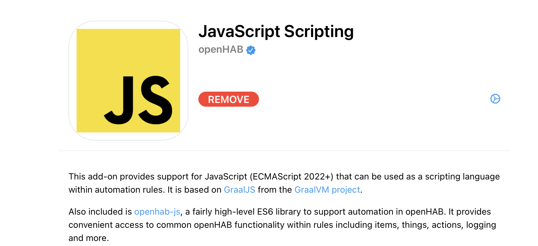

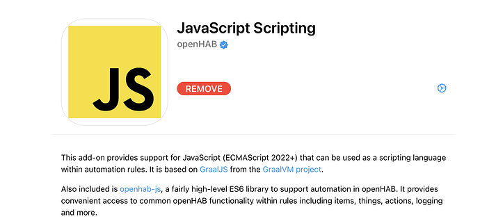

Make sure to install the new graalvm JS, not nashornjs

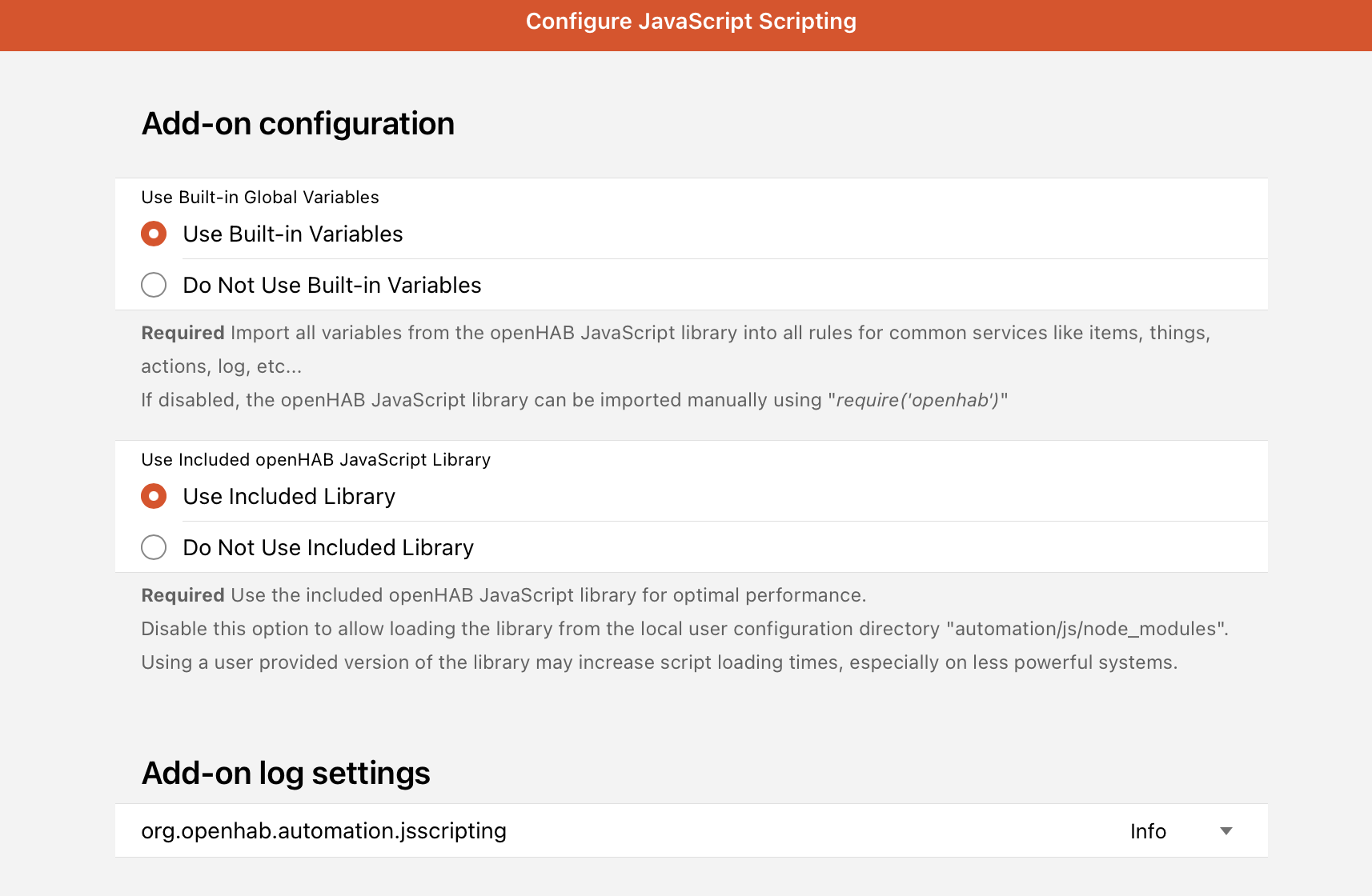

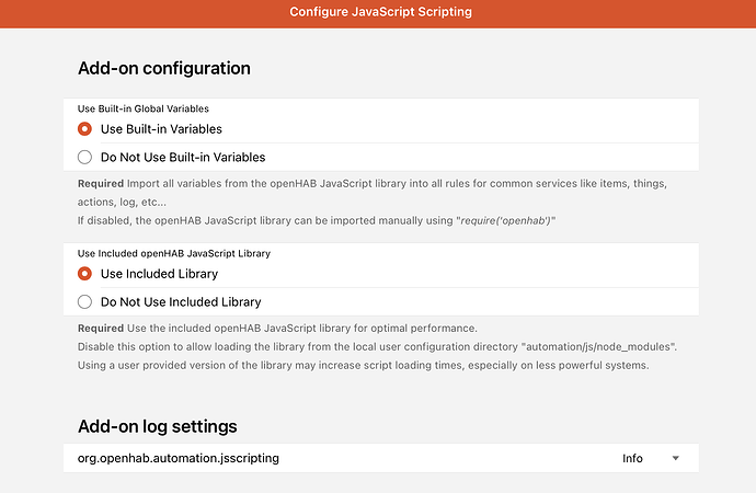

Is this one correct? I already tried to reinstall this one without luck, configuration of the add-on also added.
Yes that is the correct one. Not sure what else to suggest. Have you tried restarting openhab?
